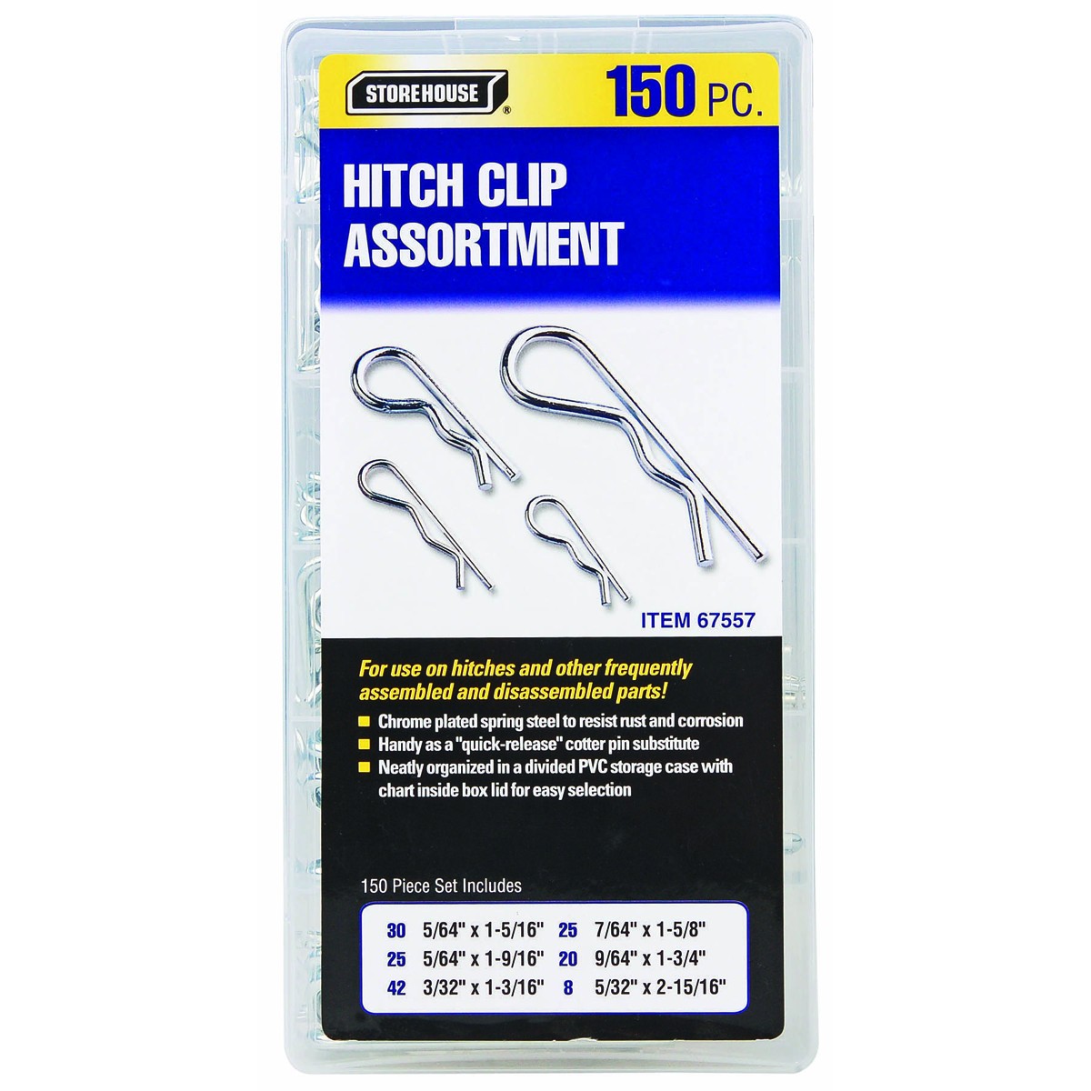

I think my bowden tube was hanging on for dear life, as I always noticed when swapping filament that there was a 'notch' that it would often get stuck on. I know now that it was the bowden tube not being pushed up against the extruder enough!

Oh and there is a really nice little bowden tube clip that helps prevent fail 2 from happening...
http://repables.com/r/635/
I've been using them for over a year with no bowden tube failures.

Thanks, I just ended up using a zip tie.

I bought a variety pack of hitch pin clips from Harbor freight and they work perfectly for holding up the bowden connector and being made of metal they will work forever.

Nice, great idea
