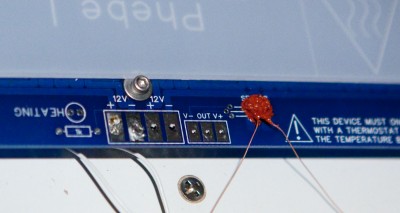

I have not connected the thermistor to the heated bed correctly. I think I need to run the thermistor leads through the bottom two tiny holes right next to where the head is mounted under the red glob of silicone. The board connects them to the V+ and OUT (right two) solder terminals. I'll solder my thermistor wires from the Rambo to those terminals.
thermistor not connencted

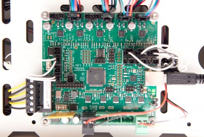

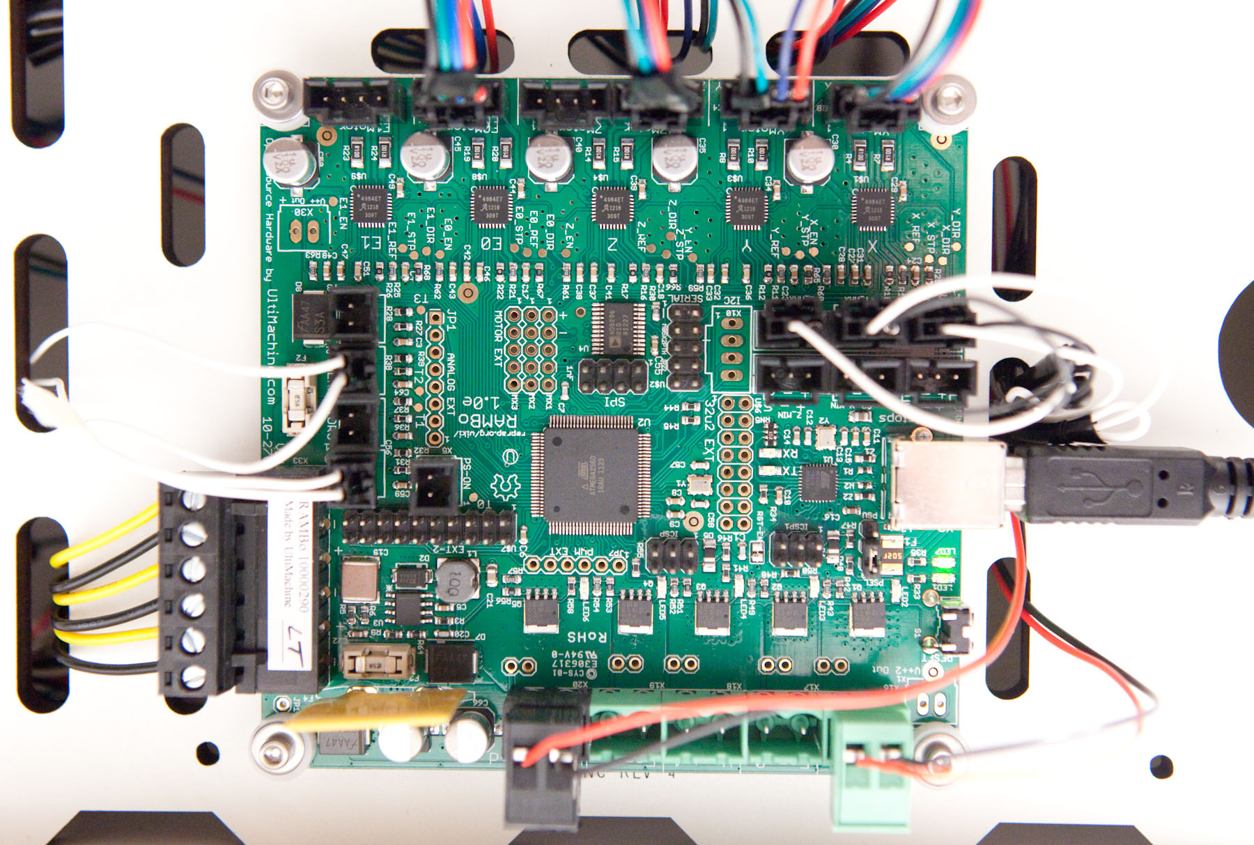

Here's the Rambo wired up. You can see:
  • colored motor wires at the top
  • thermistors are white wires on left (hot end thermistor on bottom as pictured - closest to power supply wires)
  • endstops are white/black on the right
  • power supply to Rambo is yellow/black on left
  • power to heated bed is red/black on black terminal at the bottom
  • power to hot end resistors is red/black on green terminal at the bottom
rambo as wired

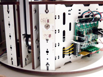

This is where I put the power switch. My 8yr old labeled on/off for me. Originally I wanted off to be down, but when I soldered the (green/black) wires from power supply they came off the wrong side and would hit the door if I mounted that way. So to me, it's upside down... thus the label.

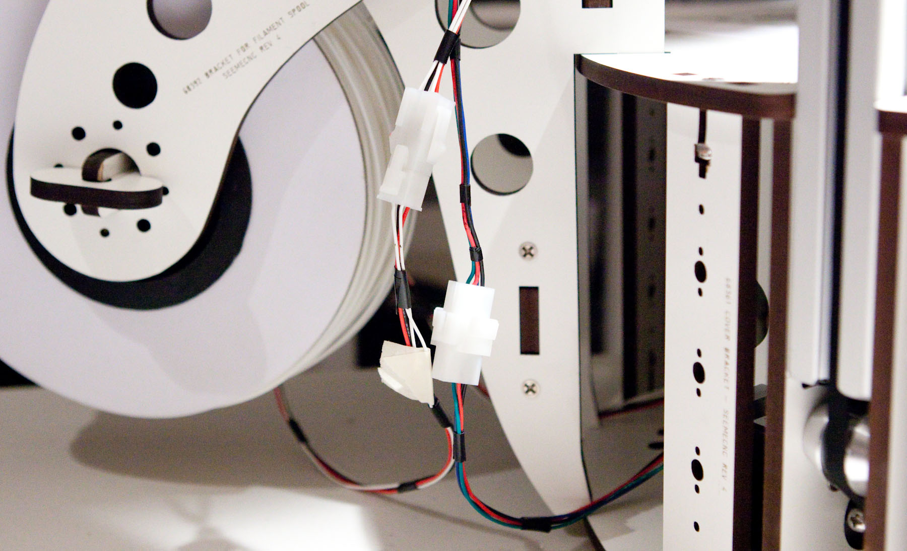

These are just the Molex connectors I put between the extruder wires and the board and also between the hot end (heat and thermistor) wires and the board. Makes it easy to detach.
molex connectors
molex connectors

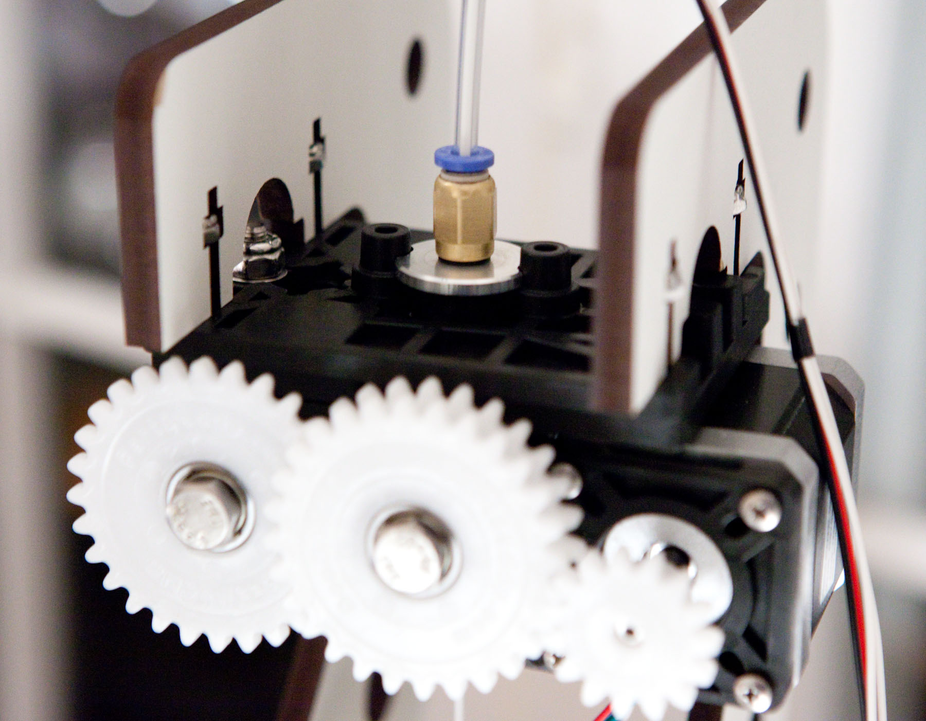

So here's the extruder barrel assembly. Not much to see, except for some reason it was very confusing to me. This metal part goes wide side up and is tightened against the top most black plastic plate for the extruder (labeled #33 lower extruder mounting plate in the steve's extruder PDF) using the knurled metal thumbscrew (which is like a ring). Simple once I saw a picture, but this took me forever to understand.

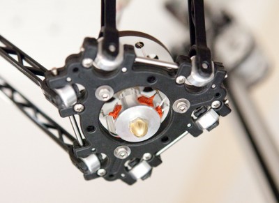

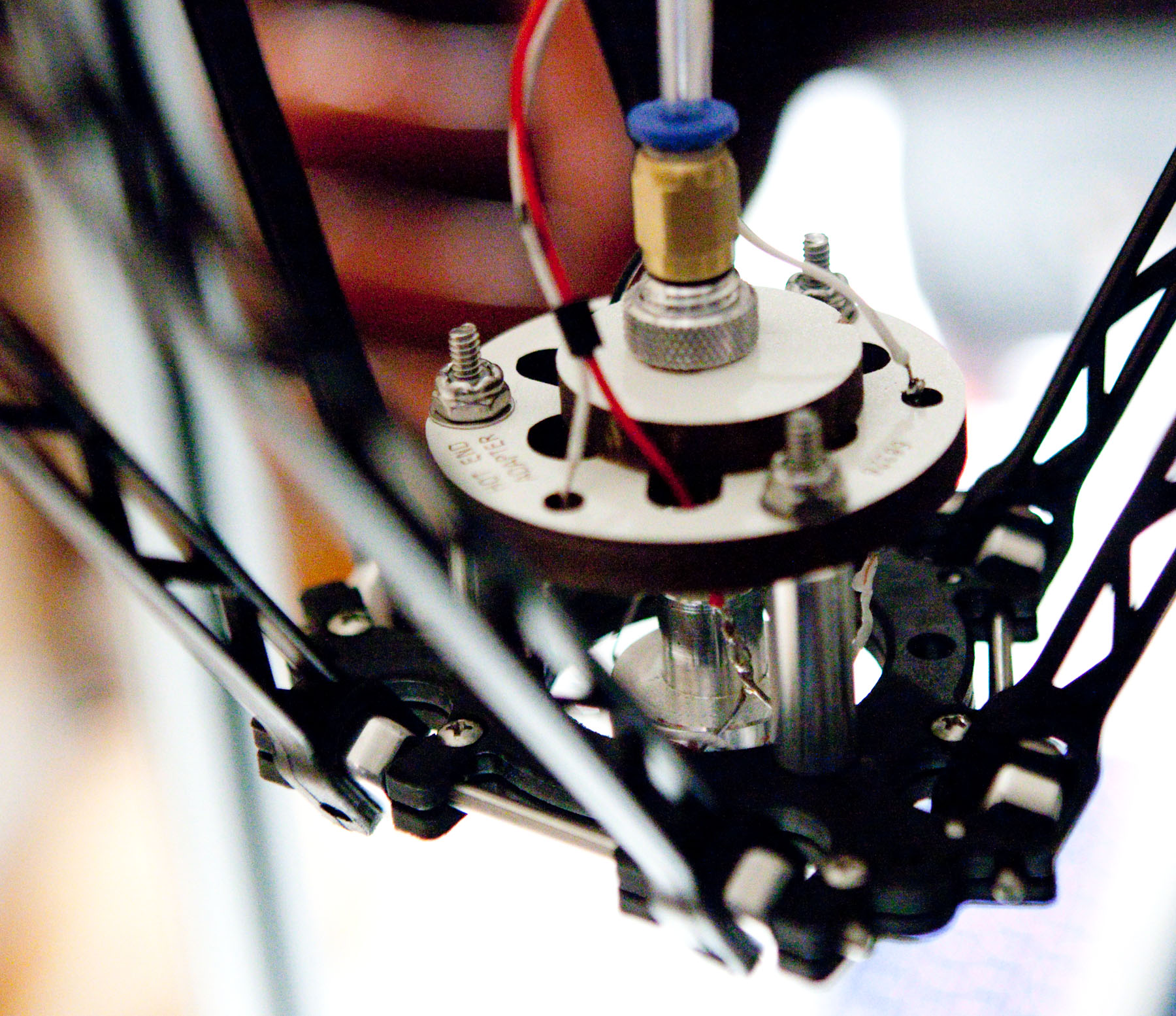

These last two are just shots of the hot end. The top view shows wire routing and the piece we drilled to stand in for the hot end spacer we couldn't find.
hot end below
hot end below
hot end above
hot end above

Barnett. You will need to run a + and - to each of the pads on the phebe heated bed. The two connections are because there is a left and a right 'zone' on the bed, and also if someone was using a 24v power supply, they could wire the bed in series to get the correct resistance.

OK I will make sure the heated bed power wires from the Rambo connect to both sets of heat terminals.
Could you describe the connection of the thermistor there? Or point me to a resource describing how it should be connected?

OK the manual solves my thermistor question and many more.

Barnett, I like the idea of using molex connectors as quick-disconnects. I'll have to swipe that idea. Don't be surprised if it shows up in an update to the manual down the road. :)

I'm such a novice that I don't even know if molex connector is the right terminology. And I should admit I swiped the idea from this photo:

Those connectors are called Molex. "Molex" is a commercial brand that covers a wide range of connector sizes and styles, but they're typically the larger white nylon connectors commonly found in applications that consume a lot of power (appliances, etc).
