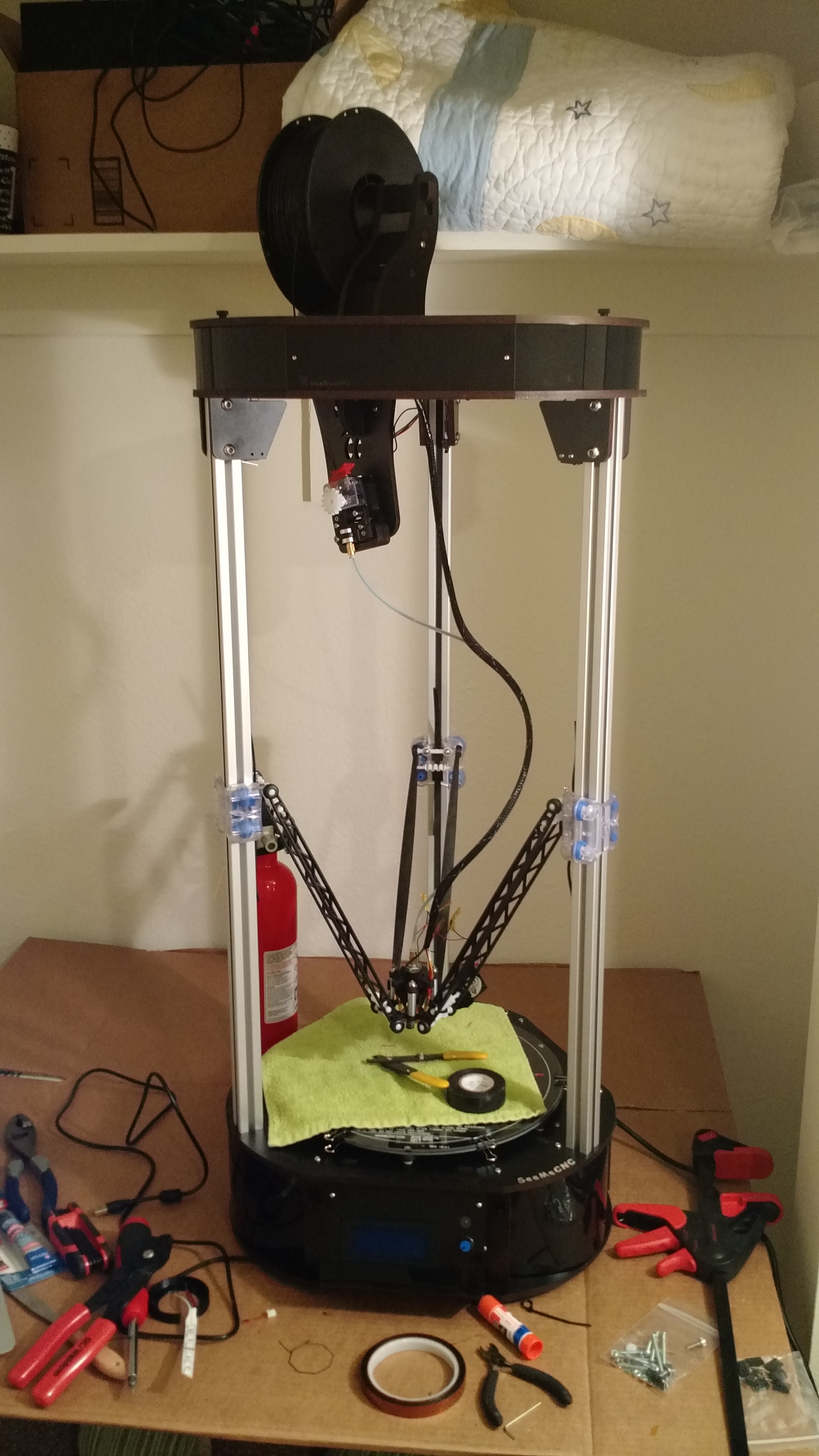

Thought I'd finally post an update:
Here's my completed printer, "Weaver":
I've been printing for the last week and a half, which mean it took me two months to complete the kit - that's a reflection on me and my free time, not the kit itself. Very happy to have it working now, though!
I've been maintaining my build photo album: https://goo.gl/photos/3CPAMDvZ3xq8GHQZA
Right now I'm playing around with slicing settings, and I've ordered parts and downloaded .stls to build a heated chamber.
Couple highlights:

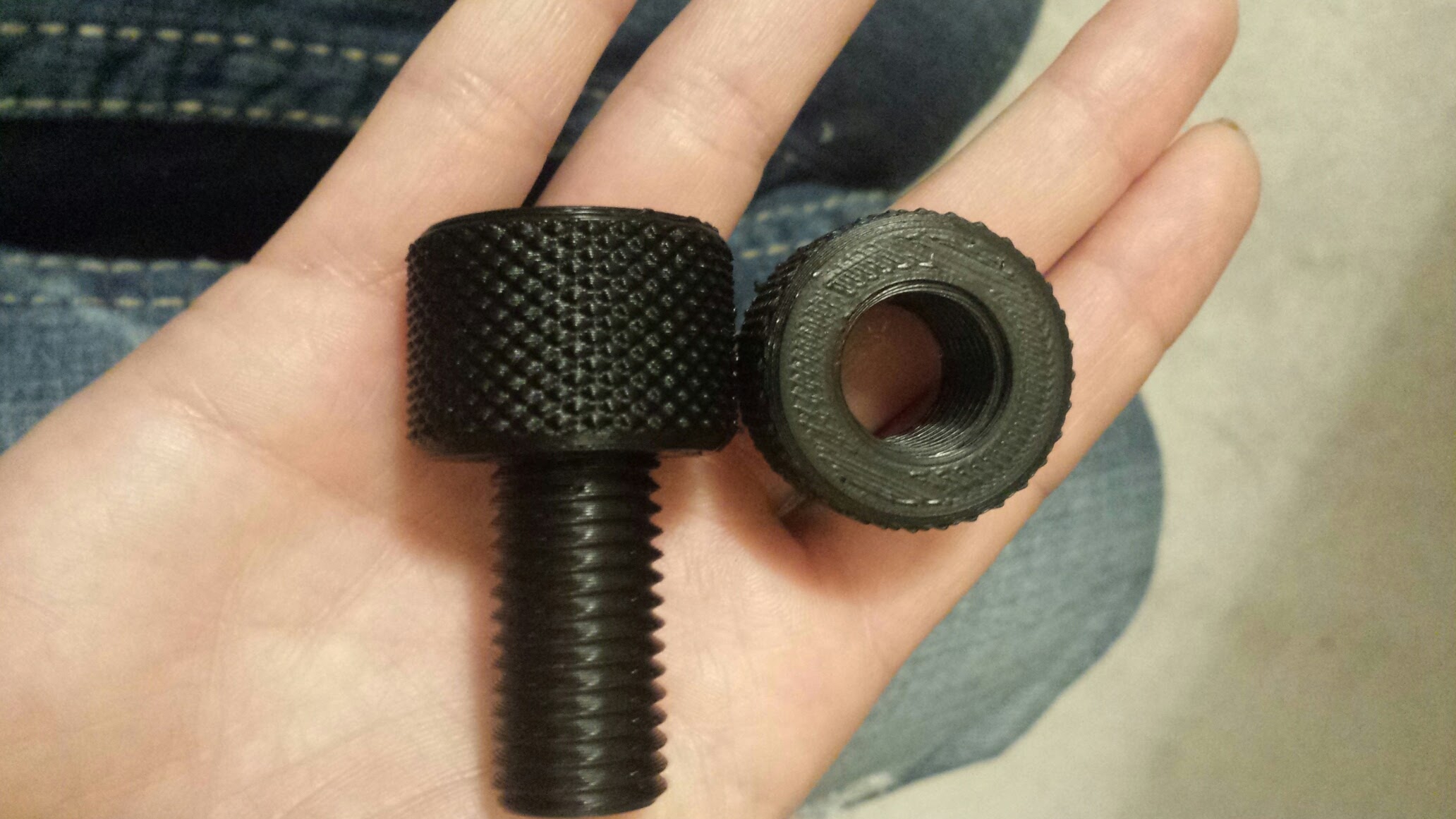

Couple highlights:
Re: Rostock Max V2 in Denver
That nut and bolt you printed looks fantastic!
You must have done an excellent job in calibrating your printer!

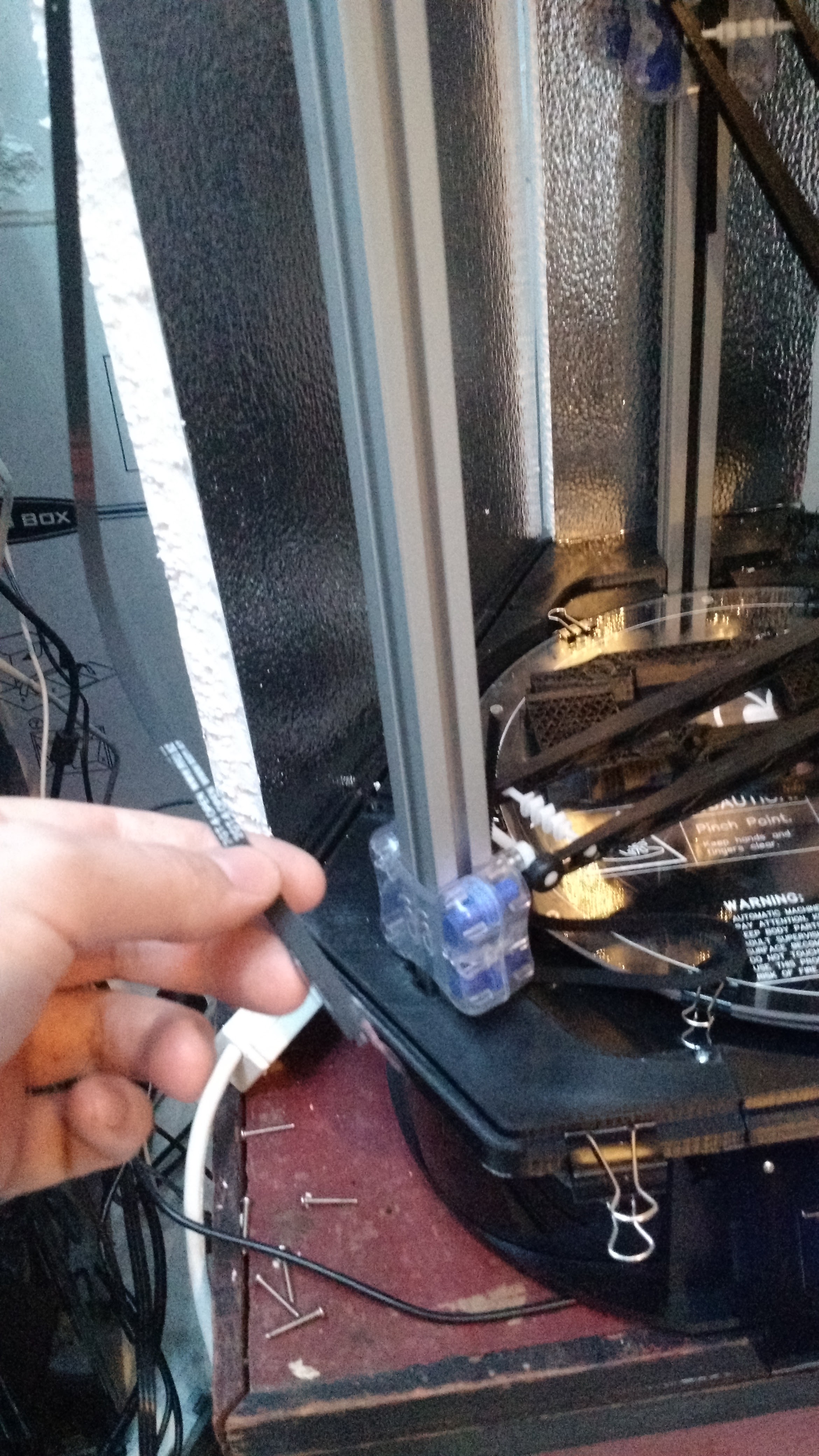

So I (evidently dramatically) over-tensioned a belt last week, and this morning I woke up to this:
Is there any way to splice this? Or do I need to order a new one and wait for it to ship out?
I had planned to spend most of the weekend printing, but if I have to wait, it's not the end of the world.
Wow.  Just wow.
The amount of force it takes to snap one of those belts is pretty high. I'm amazed the machine even moved.
It actually moved fairly easily. I'm wondering if I shifted something that made it abrade. I'll be checking when I get home from work.
In your shoes if the broken belt does not show a flaw that night have caused the problem and you are fairly sure you had it too tight then I would call SeeMeCNC (well use the chat button to tech support in the lower right corner of any of their main web pages) I bet on a new machine they will just send you another one if there is any hint of a fault .... if you actually did break it you might want to buy a new set of 3 just incase the other two have been over stressed.
did it break where you had it clamped in the cheapskate? if you and you did not trim the excess when you clamped it you might be able to just clamp what is left if it broke in a area that spent a lot of time working the cog check for a sharp burr in the area of the base of the tower where the belt path is (look for rubber crumbs) Same at the top of the tower in case it snapped up there only about a foot of the belt gets heavy use and its in those 2 areas.
It snapped (tore?) at the base of the tower. I've got 5 meters of belt due to arrive on Monday. I'll look over the belt path for any burrs or sharps spots this weekend.
Thanks for the input!

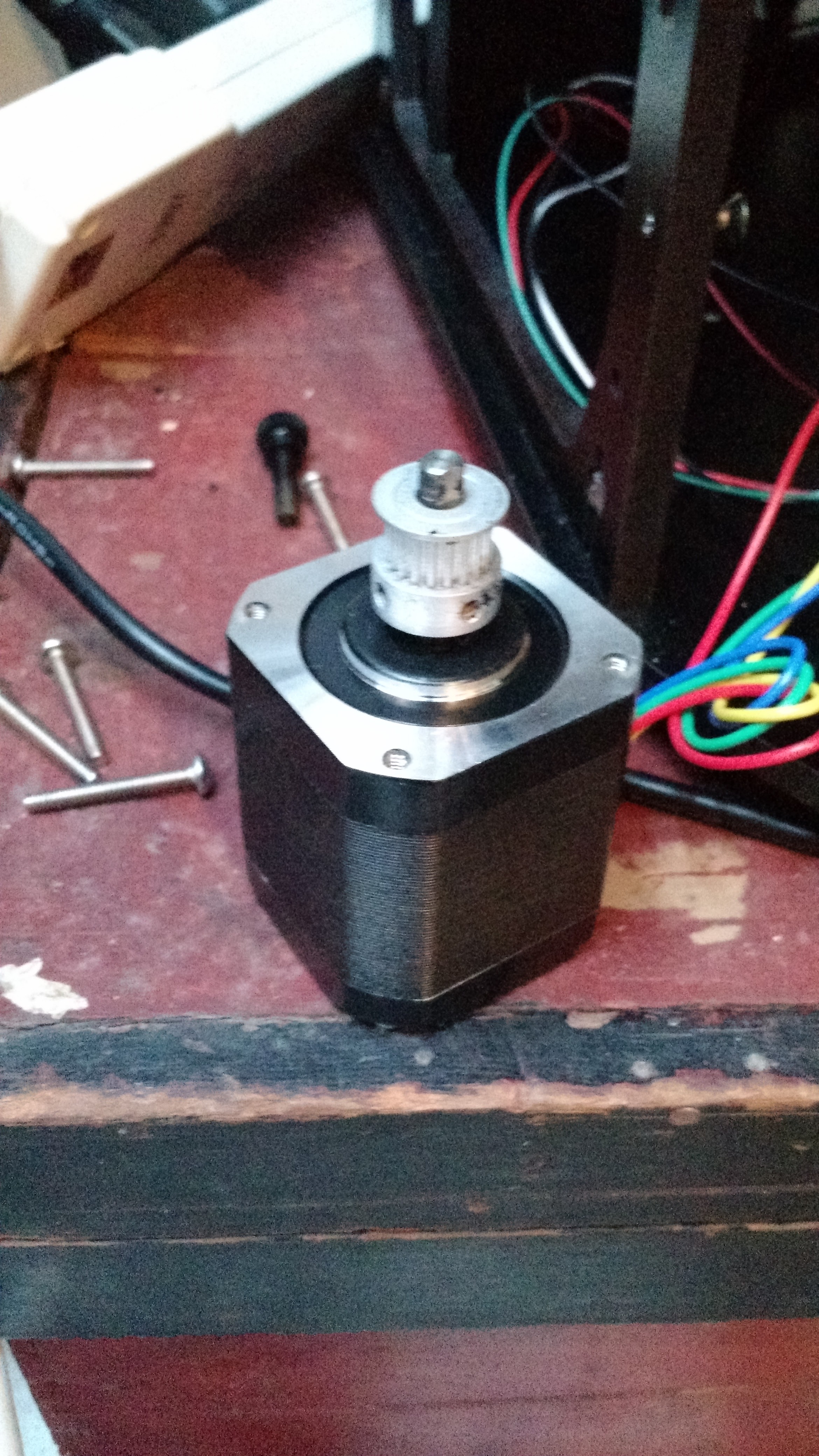

Well, I found the problem. The gear on the stepper motor was out of line with the pulleys:
Totally my fault. Not sure what I was thinking when I installed that stepper. There was a ton of rubber dust in the base of the printer. I checked the other belts, and they were fine. I replaced the broken belt.
