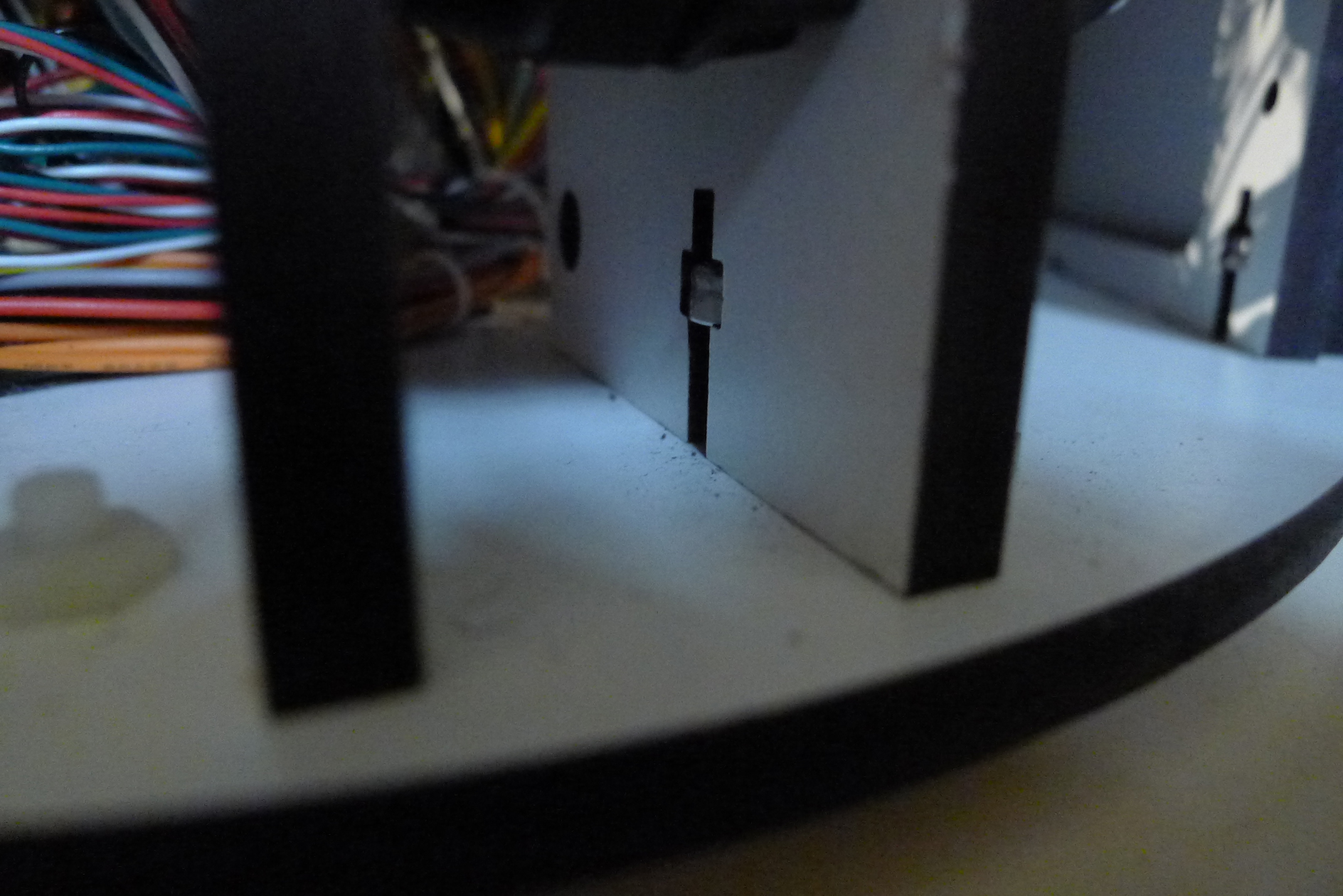

If I do have to take out the stepper motors, grub nuts, belts, arms, etc for inspection, is there a good way to go about doing this without removing the towers/base, cutting wiring, etc? Right now, to my mind, there are a lot of things that could have gone wrong, but I don't know a good process to rule out possible causes. I don't want to rush headlong into disassembling and maybe cause more problems.
I have attached a couple of photos of the various layer shifting/perturbations.
