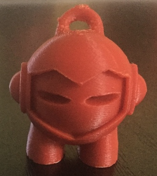

A cooling fan WILL help with this part.
Here's one printed in ABS at 0.1mm layer height, I think around 230-240 degrees, with a weak cooling fan aimed squarely at his face. Make sure it's weak, you don't want much. My fan was a good 50 cm from the edge of the build plate. Note that the keyring part on his head still needed more cooling, I should have moved the fan closer when printing this part.
Screen Shot 2016-01-12 at 2.21.02 pm.png (193.39 KiB) Viewed 6835 times
Also using a flying extruder, and tweaking your bridging settings will help a lot.
Also I think the issues with your benchy model are to do with retraction length. Speed up your retraction, use less retraction, speed up non-print moves. You want that nozzle to zip across so fast that it doesn't have time to ooze.
