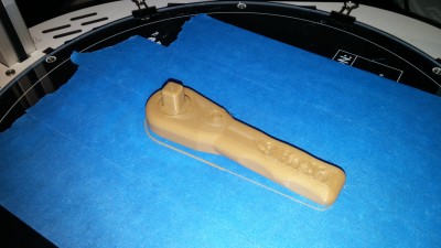

Re: NASA Wrench
Yes, it has internal parts that I had to fiddle with for it to work. I could see around layer 10 my edges on the internal parts started to curve, so I didn't expect it to work at all. I was able to use my Xacto knife the cut the stuck parts without damaging the unit. I then just put an adjustable wr...

NASA Wrench
Don't know if anyone saw that NASA released their STL file for the wrench they printed in space.
Printed one a few nights ago.
A really neat thing to print, and fully functional too!
