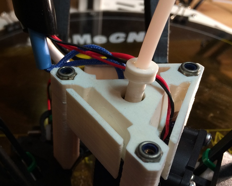

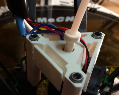

This is a pic of how i have mounted mine and without that bowden extension these is no way you can get your fingers in.

Re: New E3D V6 mount?
I agree, don't like how you cant release the bowden because its hidden, but you can fix that by printing this this extension.

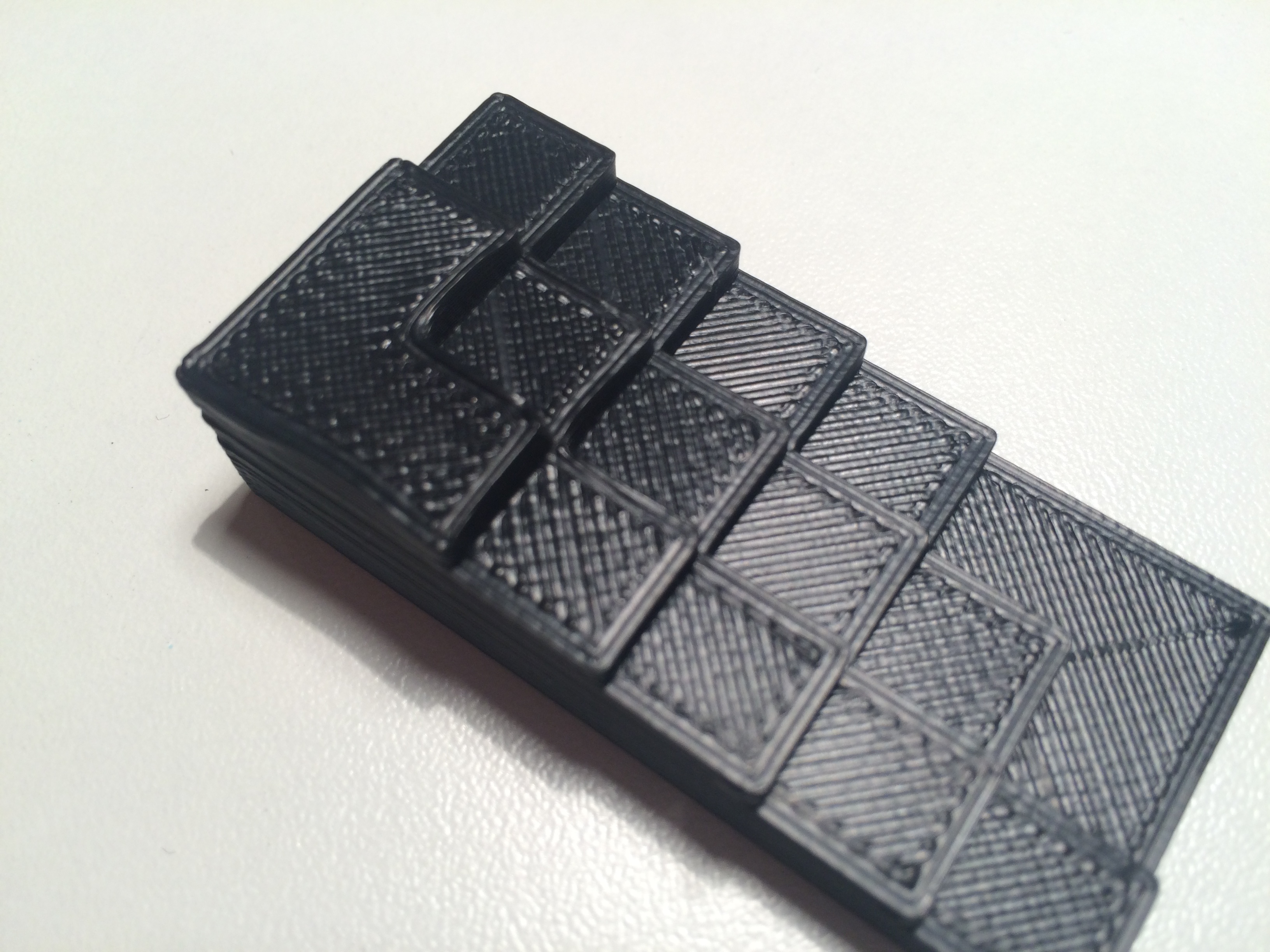

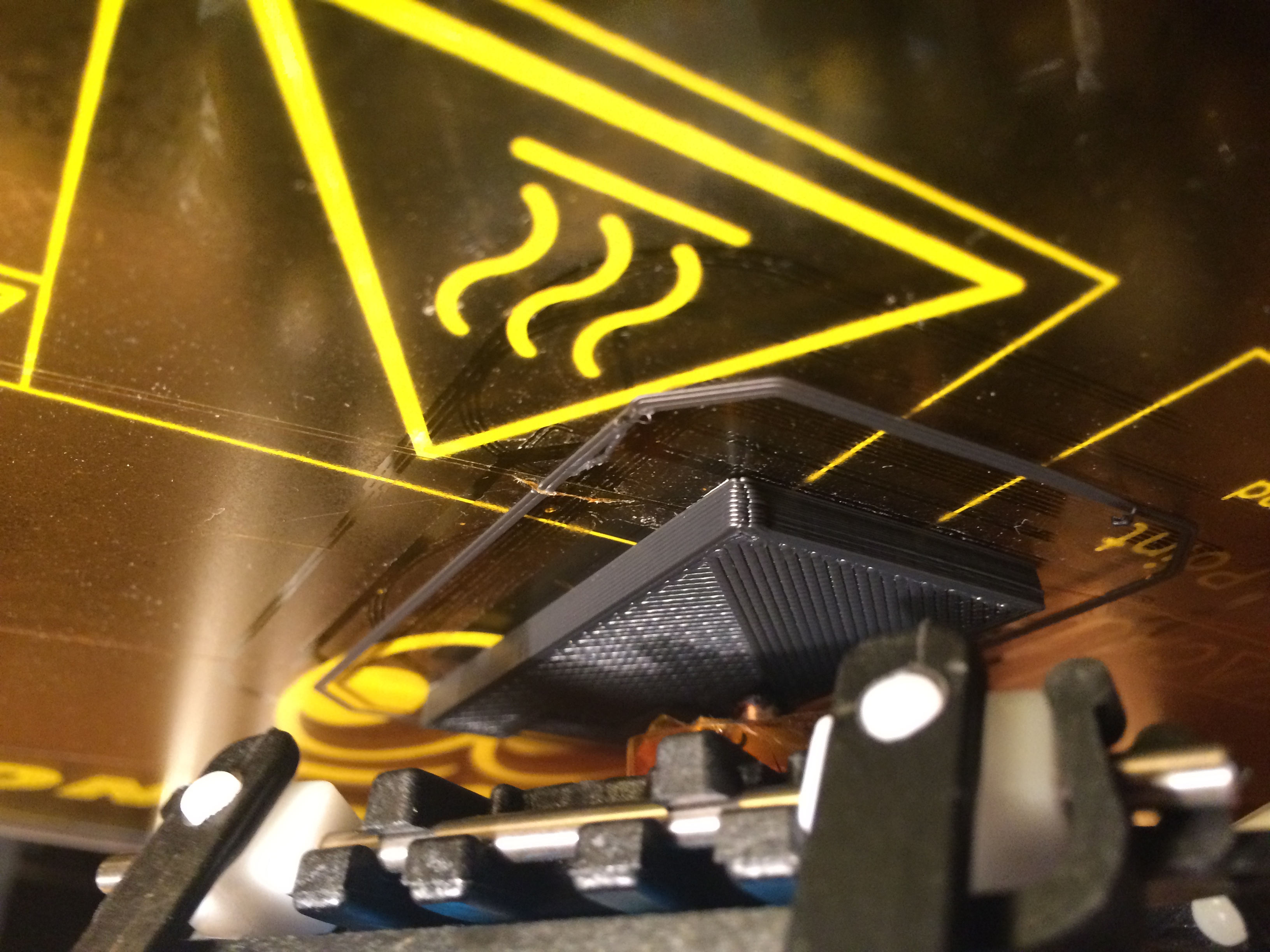

Hi, when you say tiny gaps do mean a visible gap where each line is NOT touching each other?
Do you have a close-up image to demonstrate?
Like so.
This is the final result, would you say not enough extrusion? Also has some melting/warping look about it.
Like so.
