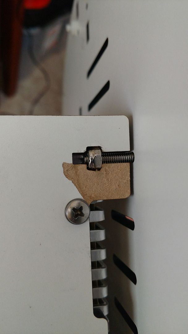

Not excited about the manufactured wood pieces. I'm almost afraid to tighten anything. I did end up getting it tight with needle nose pliers so the piece is functional. I anticipate a few more of these issues as I continue to build this rig.
JJ offered to replace it, but since it works, i'm not bothered really. This is here as a caution for others.

If you had to hold the nut with pliers to tighten it, you cross-threaded the nut.
