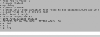

New owner of a v3 here, looking to get some help with an issue I am having currently.

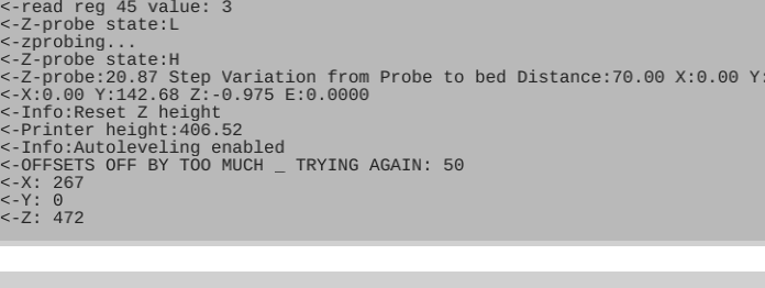

As of recent I am unable to calibrate my machine correctly. I keep getting an -OFFSET OFF BY TOO MUCH TRYING AGAIN- at the end of the calibration, resulting in it retrying and having this happen in a loop.
Things I've done
check belt tension
swap out accelerometer board
square my towers up
clearing eeprom/reflash firmware
But to no avail. Any help would be appreciated :)

Maybe your endstop screws are too high or uneven, try screwing them all down so they are all the same level and try again. Are you using most current firmware? I think there was something buggy with the recent one so try the previous file.

Welp now I feel stupid..
screwing int he carriage endstop screws fixed the problem instantly haha..
Many thanks for the help.
