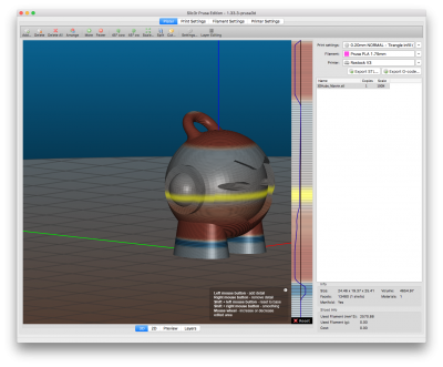

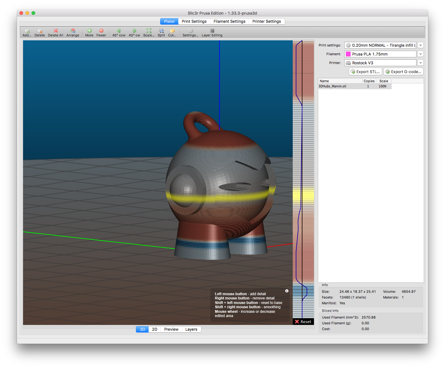

Thanks for posting this. I am giving it a try but find the transition from one layer height to another, with the variable layer tool, leaves a very noticeable line.
Re: New Slic3r Prusa Edition (rocks)
This is beta but I found it did a great job on the Marvin model (almost a spherical body). Prusa has a very active git for this project so file bugs if you find them. They are seriously overhauling this slicer by storm.

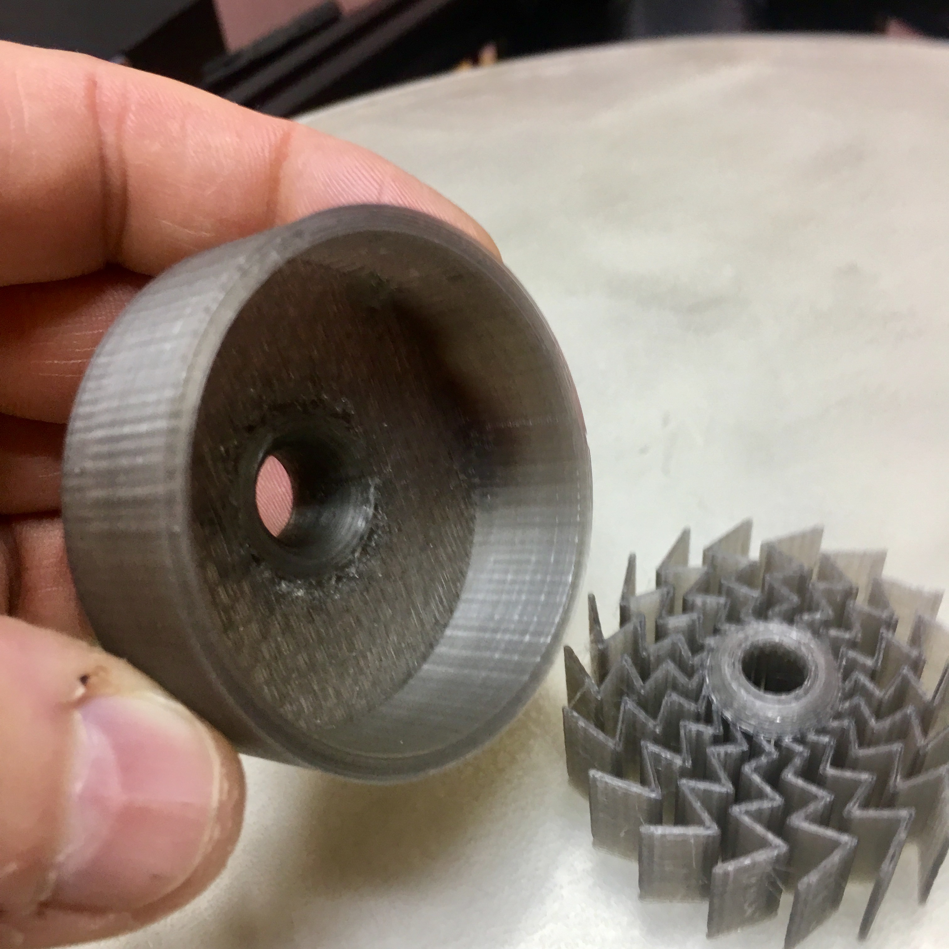

Are you designing these parts yourself in Fusion 360? If so, THAT's where to design in the supports. That's what I do. Here's an example - the Z shaped part is the support that keeps the inside flat bottom from failing. The part I'm holding is printed with the thin perimeter facing down, like an upside down cup.

I know you don't like repeating things, but when you first posted about that z shaped support I was interested. But now I can't seem to find it. Is it on your blog? I wanna say I just attempted to skim through all the posts there.
I don't remember myself! What do you want to see or know?
Just the process--"method to your madness". You did some explaining on how you setup the supports to get good results. I've recently gotten fed up with slicer supports myself and the few times I've tried to make supports on my own they always turn out too strong and rip out chunks of the actual part :/mhackney wrote:I don't remember myself! What do you want to see or know?
Part of me wants to try making separate models for the supports and give the slicer different settings for those parts, maybe a faster/thinner extrusion will make it a weaker connection, not sure.
Ok, let me post something in my V3 thread so we can find it later...
Ok, here's the post: Supporting Rules
