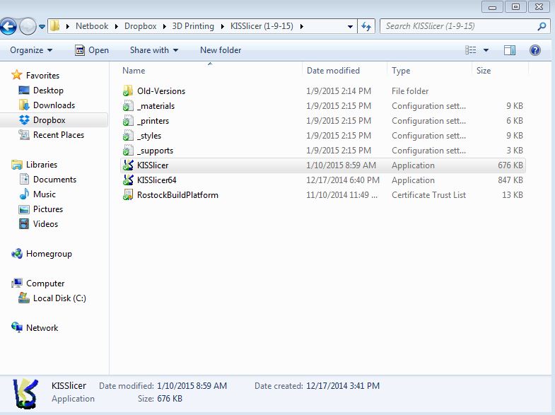

Thought I would share this with others since it has been so awesome/convenient for me to use KISS on multiple computers.
Download the DropBox desktop application on all machines you want to be able to use KISSlicer on. Once installed make a folder named KISSlicer and place your install .exe and all .ini configuration files in this folder. Create a shortcut to your desktop to the .exe file for that specific operating system (can have multiple .exe's in the same KISSlicer folder which shares .ini's).
Now whenever you launch KISSlicer it will launch from your local dropbox folder and all configs will be saved there as well. It will then automatically update the .ini's across all machines so that you never have to sync them manually again.
Here is what my folder looks like...

Nice idea. I suppose it would work across Mac/Windows too if you put both apps in the folder.
The new versions of Kiss have support for a round build platform so you no longer need the STL for the platform (just FYI).

Re: Easy multi-computer use of KISSlicer
Never really thought about not needing the .stl for the bed anymore. Good to know.
