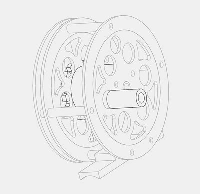

I've been using ViaCAD after switching from TurboCAD a few years ago. Primary reason for switching was that I do most of my design work on Mac and TurboCAD let their Mac product slide. VIaCAD was quite good and works on Mac and Windows. I wanted to be able to do both so I could transfer files to my shop machines (CNC controllers) to do fix-ups, etc. Been really happy and it is quite affordable. The latest version added some really powerful 3D extrusion tools that work great. It was really simple to do this:
I removed the shading so you can see some of the internal detail better.
