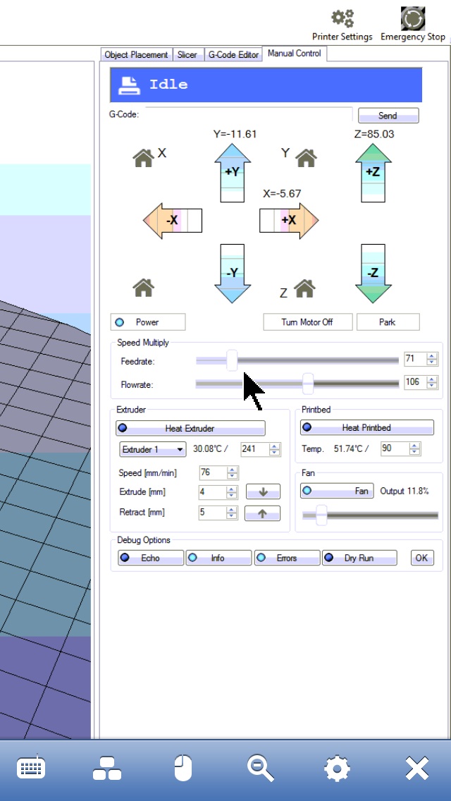

I'm still fighting this bump noise coming from the EZextruder stepper motor slipping. I thought my hot end temp was too low not allowing the ABS to melt and squeeze through the hot end fast enough thus cause a pressure buildup on the EZextruder stepper, but I've since set my hotend at 241 Celcius constant and the bump noise hasn't stopped.
I find that if I slide my Feedrate slider in Repetier Host down to 65 or 70 it seems to do it less, but prints take much longer. And any time the printer needs to lay down more plastic it begins to slip again almost every 7 seconds. What could this be? Can I achieve higher speeds and not "bump"?

note: another symptom I have is that my outer perimeters don't seem to meet unless the speed(Feedrate slider) is down around 70 or 80.

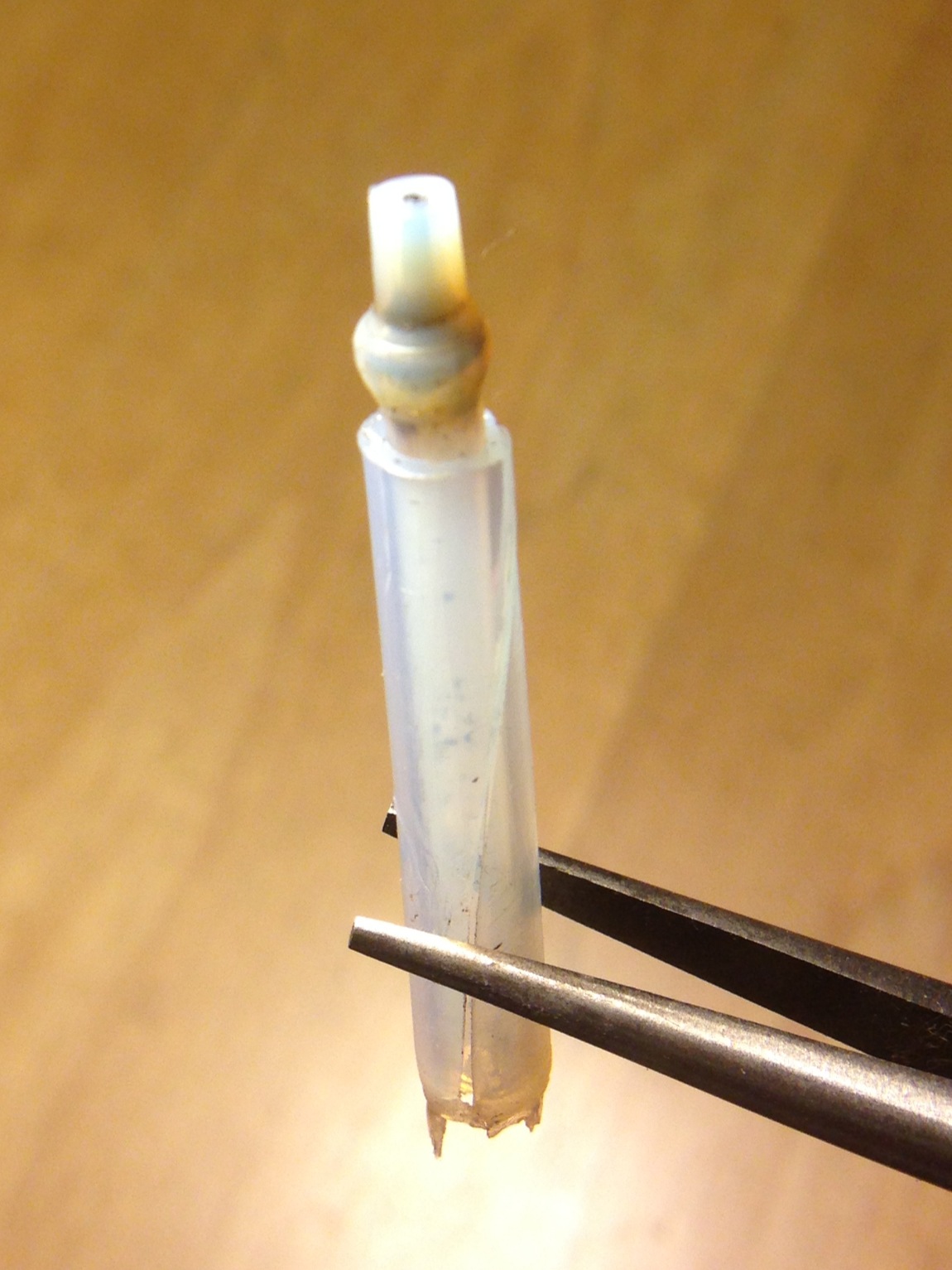

The skip happens throughout the whole print. It occured so often in my latest print that it cut the ABS plastic where the teeth of the stepper motor comes in contact with the filament. I took my hot end apart and pulled out the transparent tubing inside. It looks like this:
Is that buldge normal?
Re: EZextruder stepper still slipping!
Well I couldn't wait, I went ahead and replaced the smaller transparent high heat resistant tube with some other of the exact same type I had and it looks to have solved the problem.
That's VERY un-normal.
When the PTFE gets over heated, it shrinks - I didn't think you'd over heated your hot end so I didn't suggest checking that. I'm amazed that you didn't burn the PEEK in half.

The story goes: during my prelimenary x, y, and z calibrations for each tower, as I sent the script "G0 Z0 X-77.94 Y-45 F3500" to my rostock max. The wiring I had for my hot end thermistor had stretched and pulled the thermistor out of the hot end, still wrapped in the hightemp RTV, just enough to NOT to make contact with the hot end but not enough for the naked eye to see.
I did melt the PEEK and Steve mailed me a new one. This was before our Google hangout. So me never seeing the high temp tubing before the melt down, I didn't know what it was supposed to look like. I never knew it was consticting the filament flow.
Thanks again for your time! Everything is good now, I think.

Ok. I'd totally forgotten that you'd cooked the PEEK section. I didn't even think to ask if you'd replaced the liner. It should be noted somewhere that if you over temp the hot end to the point that the PEEK section fails, the liner should be replaced at the same time.
Do you have a photo of your cooked PEEK section? If so, can I have unresized copies of it and the one of the liner photo above so I can put it in the manual?
