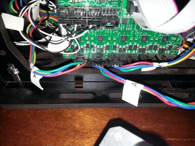

[img]http://i1355.photobucket.com/albums/q703/scox37/20150917_1834021_zpsevhcym6w.jpg[/img]
[img]http://i1355.photobucket.com/albums/q703/scox37/20150917_1833501_zpso1kt4stv.jpg[/img]
Some images. Everything is plugged in. Would fixing my invert potentially solve it.

Looks like your steppers might be plugged in backwards.
Page 215:
The connectors you see in Fig. 16-34 are 4
pin latching connectors. That means they've got a little locking tab that positively engages a little ledge
on the inside of the socket that's on the RAMBo.
Sometimes SeeMeCNC has to procure stepper motors from a secondary source. These motors don't have the locking tab feature.
The connector will work just as well as the locking version, but does
look different and can be accidentally inserted backwards. The pin
indicated by the arrow in the Fig. 16-35.5 is pin #1. This pin is on the right
edge of the connector when you plug it in to the RAMBo. These motors are
made by Kysan or Automation Technology and are just a little bit different
from the “stock” motors.
This is a pic when I had my Rambo installed.

Re: Home Tower Error
Okay, I switched the connectors to the right way and now instead of the crashing into the Y axis column it goes in the opposite direction!
SO! I went back into the firmware and changed the INVERT_Z_DIR back to true from false. Now when I home it moves towards the X column. Any thoughts? Maybe just a firmware issue?
