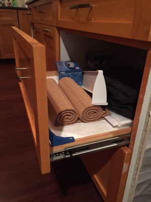

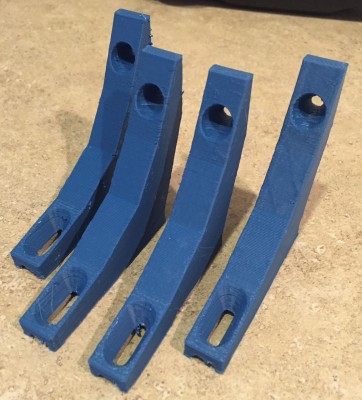

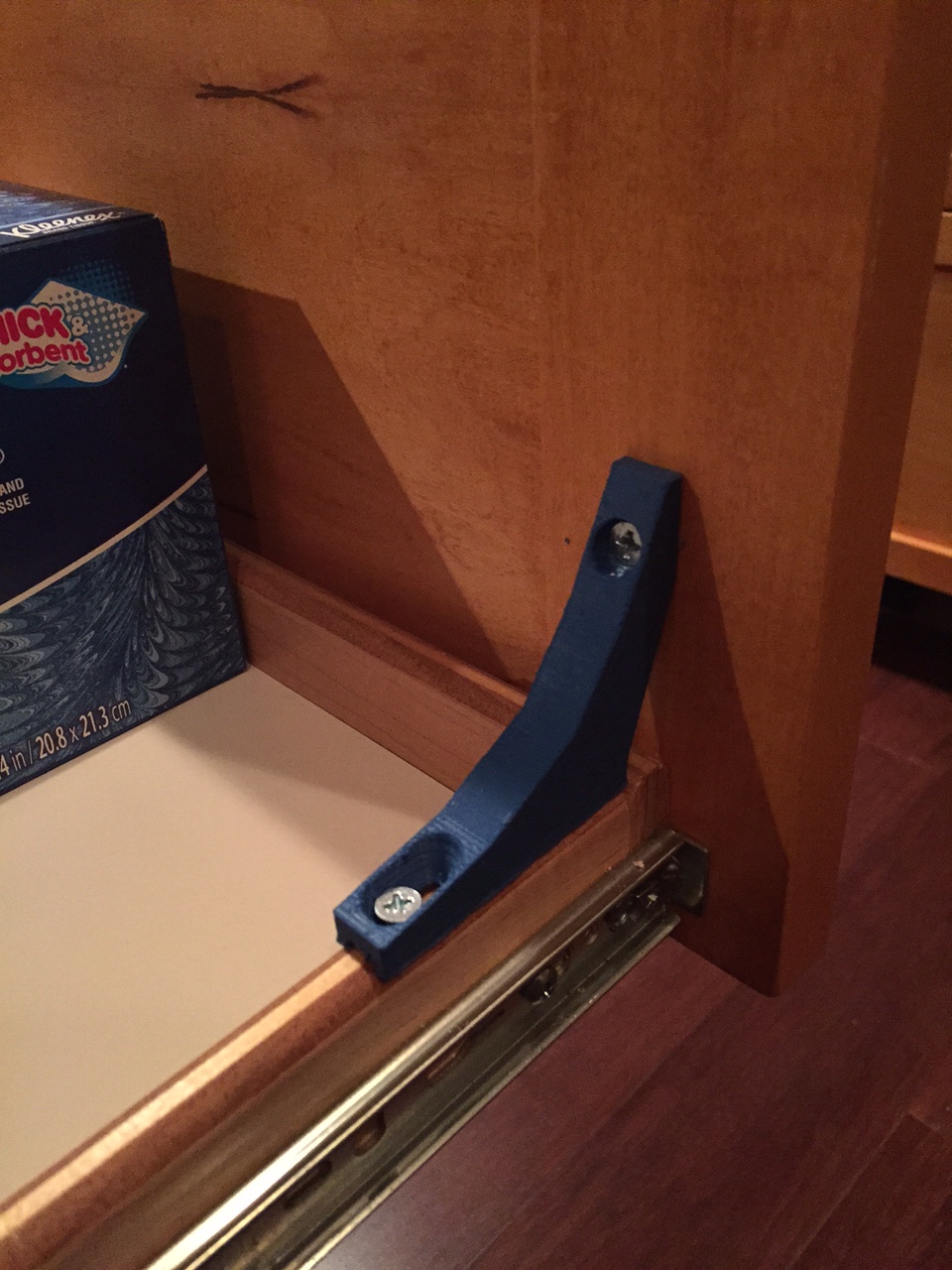

Made these drawers for my kitchen year ago. But the vertical "front" only ties in to the drawer at the bottom. Not very sturdy to say the least. So I finally made these "gussets" to add some structure. They work like a champ.
The first prototype did not have the adjustable slot and it caused the drawer fronts to stick out (or in) at the top. But after changing that screw location to a slot, I've got all the adjustment needed.

Awesome!

Neat idea and implementation!
