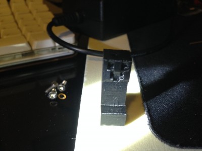

So i figured out my extruder DOESNT WORK AT ALL with Ninjaflex. I need to modify the design a bit to clamp more on the filament. I have it designed to the closest the bearing and drive gear are supposed to come together is 1mm. Guess thats too large of a gap. Guess that means I have to print a V4. Sorry to anyone who didn't have success with it.
Re: Mike's Birch V2
Ive gone through 2 revisions since the initial test. R4 didn't work much better than R3 (first release). I have modified the extruder even further with R5, which is printing now. I won't get to testing NinjaFlex with it until a bit later however. R4 was a simple change, I had designed it (for some odd reason) so the closest the bearing and drive gear should ever come would be 2mm apart, so I cut away material so the gap was only 1mm. A new print resulted in this change also not working, though I got more of a "part" than with the original release version (it didn't even extrude any material originally).
R5 has moved it so there is a .3mm gap between the bearing and the effective diameter of the drive gear. I also changed the angle that the spring goes on once again, this way there should be significantly more pressure on the filament (this was another issue I identified while testing R4, even with PLA/ABS). I will upload the file changed and report back with my results ASAP (probably won't be until Friday at the earliest)
(edit: R5 is live on Youmagine and Repables)

I made another little change to the tensioning arm. I beefed it up even more and then I trimmed a bit of material off that was interfering with the bearing making contact with the drive gear while the extruder was unloaded. I'v also changed to a new version system that describes which version each piece is on. Right now it is on 5.5, the first number meaning which revision the body is on (5) and the second number being the revision of the extruder arm (also 5).

If you're going to be going through a bunch of revisions on your EZFlexStruder, might I suggest imprinting the version onto the part itself? A small "r5.5" on the arm and body or something.
I went through just 4 revisions of my (unpublished) cell phone charging cradle. Even then I couldn't keep track of which print came from which model before not too long. Started regretting not even putting a simple versioning scheme on each print, even an increasing number of dots somewhere inconspicuous would've helped!
Anyway, hurry up and finalize your design already. I want to try printing it with trimmer line!
EDIT: Oh also, why are you trying to design a minimum gap between the bearing and the gear? If I were designing it, I would just let them touch (but I would probably be oblivious to any damage that might cause as well). Just curious.

I can't remember the exact reason why, I think it was to help with constraining the filament properly, but it was more of a "perfect world" design. I have since changed it, R5.5 has abolished this. I'm going to test it fully this weekend, the plan is to get all the kinks out of the design and get it working flawlessly.

I knew thats what you meant the second time I read it. Then I read it again and forgot lol. You probably will want to make the arm out of ABS or PLA or something more rigid than Nylon, it may flex after time.
I should probably adjust the diameter (or make that hole taper) a bit more. Ive gotten 2-3 made without cracking but I was messing around with one today made on a poorly aligned Rep2 (schools printer) and I cracked it. When I fix every little thing thats wrong with it I'll write a more detailed installation guide so y'all aren't in the dark on the less obvious procedures for installation/printing.

Good thinking on making the arm from a rigid material, I hadn't considered long term flex. I will probably still print the body from nylon but perhaps the arm from something else.
If I may make a request, could you add a small ridge to the base of the bearing shaft? I noticed that when I had the retaining screw fully tightened, there was no space between the outer ring of the bearing and the inner wall of the arm, and the bearing didn't roll well.
I suppose I could just print a washer of the appropriate size though too, now that I think about it...
Re: Mike's Birch V2
Did you over tighten the screw? I have like 5 of these printed, all different versions, and even the Makerbutt printed one allows the bearing to move smoothly. I can probably fillet that a bit more though, that should help.

Of course I did! I'm paranoid about moving parts and loose screws.Nylocke wrote:Did you over tighten the screw? I have like 5 of these printed, all different versions, and even the Makerbutt printed one allows the bearing to move smoothly. I can probably fillet that a bit more though, that should help.
A fillet could work but I also wonder if that might introduce some wobble into the bearing's motion. I don't know what the proper engineering term is (I had to look up "fillet...") but my thought was similar to just sliding a small flat washer onto the base of the shaft before installing the bearing. So the edges would only be 90 degree angles.
Of course you should design it how you want, if you don't want to change it up in the design then I'll just print my own washer like I mentioned earlier for my own little mod. I'll be happy either way!

I made some changes. I compressed the spring an additional 2mm and added a bit of a ridge that should help with your binding issues.

V6.6 Seems pretty much perfect. I just printed one last night and mounted it on a Mini Kossel I have with me at the moment. I put some PLA into it, turned the gear, and it fed through nicely. I took some of my NinjaFlex down, squeezed the lever, fed it in, and then pulled on the filament to try to drag it out and it didn't budge. I turned the gear and it fed through consistently. I may make some slight tweaks but V6.6 is certainly ready for some serious testing/printing.
