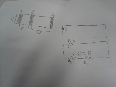

- Posts: 1561
Re: Not a printer but close
Personally, I would run three heater bands on it, to make it easy. Main heater connected to the PID module on it's own. Two others in series with each other (and parallel to the main heater), with a smaller gap between the middle heater and the main one as compared to the middle and the end heater. That way your temperature comes up sharply at the end, you don't need any resistors to dial down the heat on the one that isn't at the end of the barrel.
The reasoning behind wanting the rest of the barrel at a different temperature is partially for the sake of not having it go molten before it hits the end of the barrel, as liquids are somewhat harder (Although far from impossible) to move with a screw. It would also reduce the chances of having anything get overheated and having problems from the materials decompose at temperature (Such as how PLA and PETG can form crystalized drop things.)

Any way you could sketch a quick diagram? I think I see what you mean just not quite sure. The explanation makes sense.Xenocrates wrote:Personally, I would run three heater bands on it, to make it easy. Main heater connected to the PID module on it's own. Two others in series with each other (and parallel to the main heater), with a smaller gap between the middle heater and the main one as compared to the middle and the end heater. That way your temperature comes up sharply at the end, you don't need any resistors to dial down the heat on the one that isn't at the end of the barrel.
- Posts: 1561
You weren't too clear about which diagram you wanted, so I drew both a physical (Showing approximate placement), and an electrical, showing wiring placement. Note that the numbering is consistent.
Of course, there is no real reason to wire H2 before H3, it might even make more sense to wire H3 before H2, so as to reduce the amount of wire near the barrel. depends on you.Machines:

My apologies, the mechanical was what I had questions about. That makes a lot of sense. I will update this thread with CAD files by the end of this week to clarify some things.Xenocrates wrote:You weren't too clear about which diagram you wanted, so I drew both a physical (Showing approximate placement), and an electrical, showing wiring placement. Note that the numbering is consistent.Of course, there is no real reason to wire H2 before H3, it might even make more sense to wire H3 before H2, so as to reduce the amount of wire near the barrel. depends on you.
