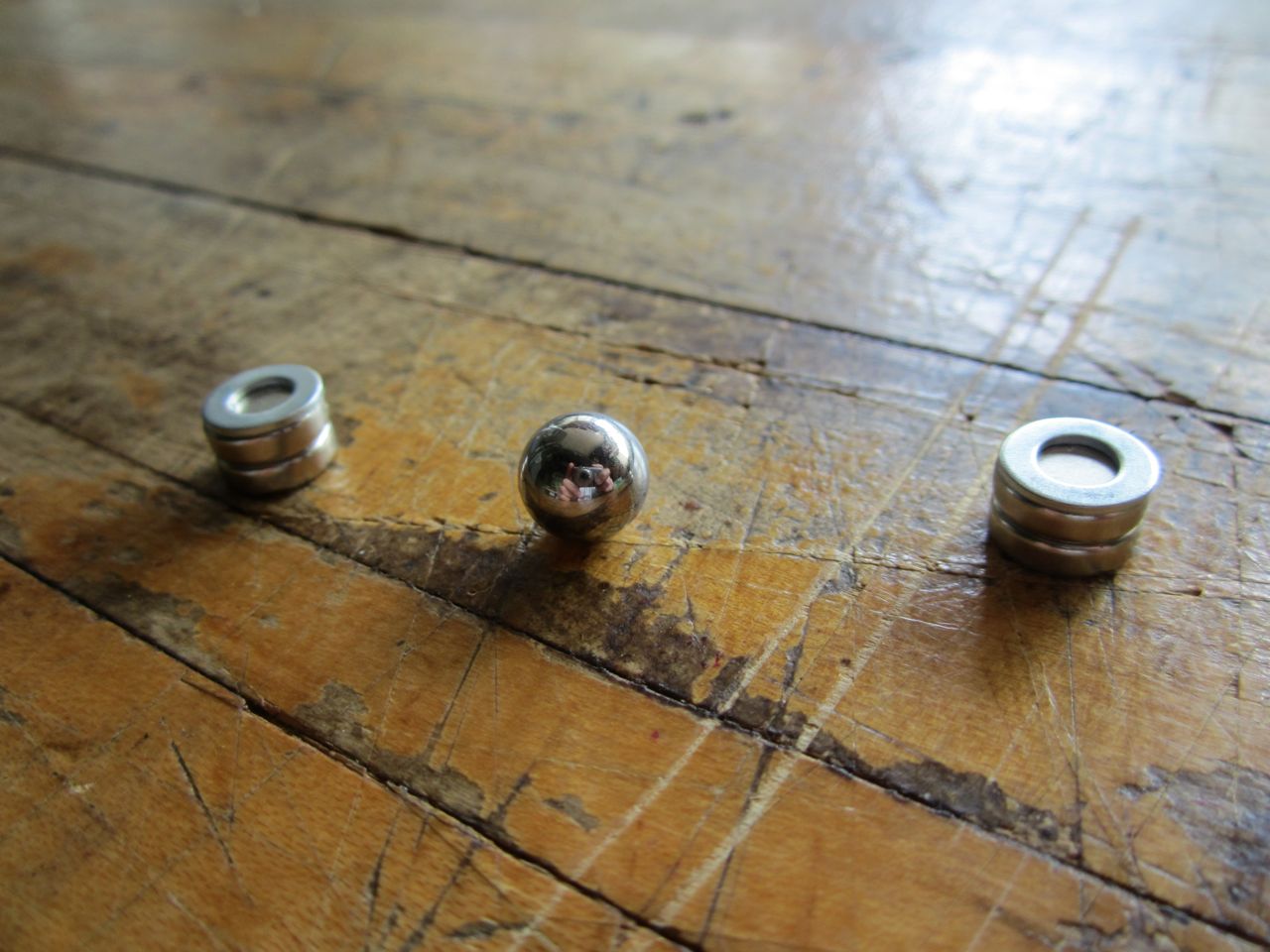

Well I was cleaning up and organizing my junk yesterday and I came across a few things that all just clicked together in my head and I figured out how to do something very similar to the Berry bot. For less than $40 bucks, perhaps even less depending on how much crap you packrat around like I do.
Thanks again to the creator of the Berry Bot this inspiration could never have happened without you posting your machine here and on youtube.
While my solution is not nearly as robust or amazing as your solution, it is cheap, does the job and results in very similar or perhaps even the same accuracy. It also requires no special tools and no fabrication other than cutting your carbon rods and JBwelding some magnets in the end. The only place it lacks in comparison would be the strength your system retains the carriage with.
Alright enough then.....ready? let's go!

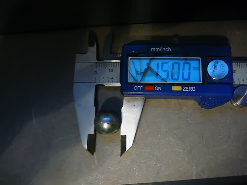

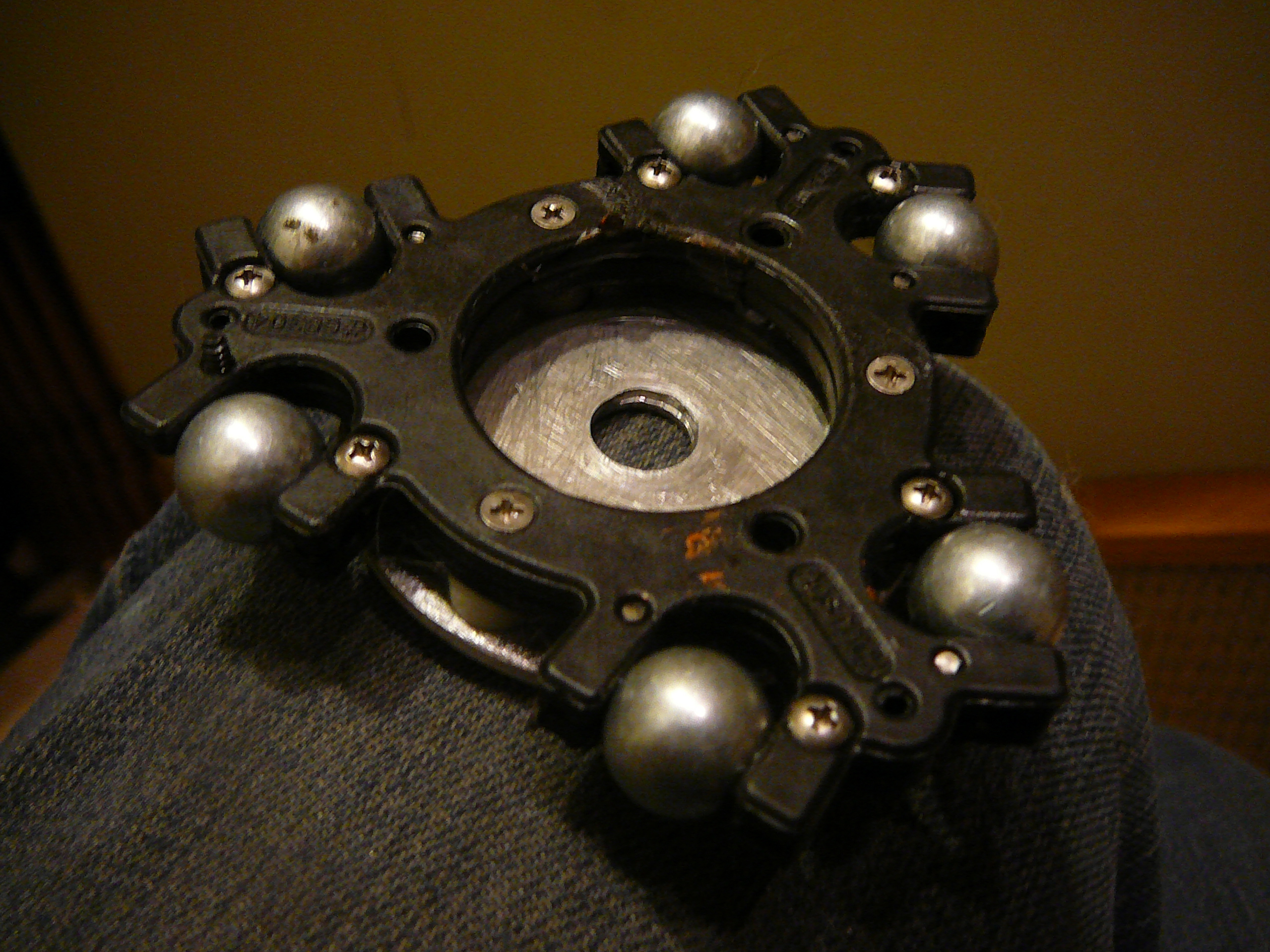

The first thing you will want to source for this is 12 - 15mm Ballbearings like this one.
The great thing about these bearings is that they simply snap directly into your hotend carriage directly, no moddin needed. When you do that it will look just like this.
The existing recesses in the carriage very firmly hold the bearings in place and they are not going anywhere anytime soon. Just loosen the tiny screws a bit first so that you don't snap the carriage when they go in. Yes they fit that well.

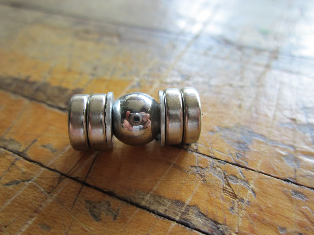

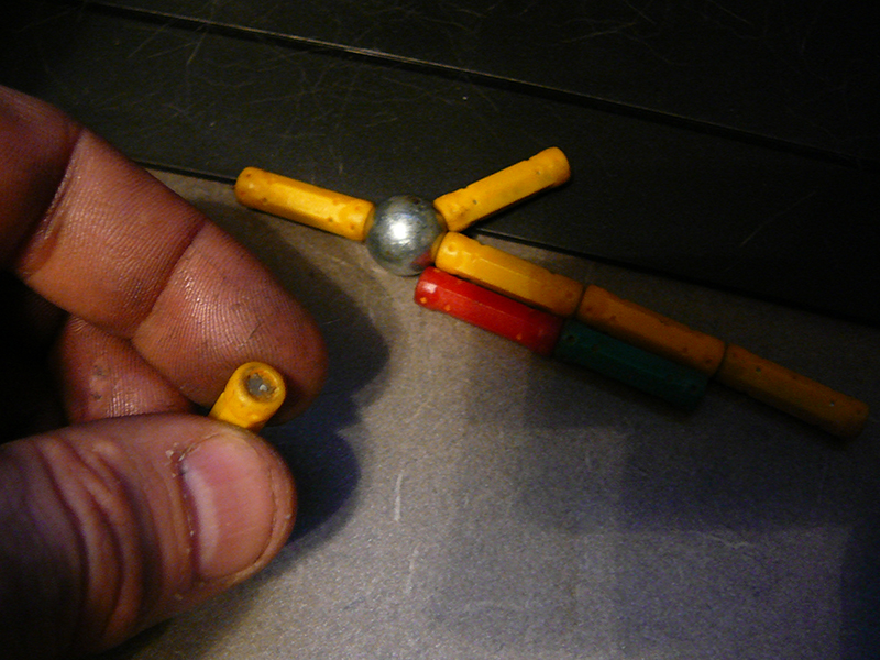

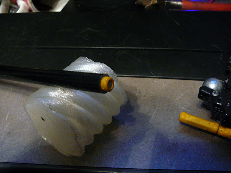

Next up your going to have to raid your childrens toy chest or go to Toy's R Us and buy a nagnetic construction toy that contains these.
The toy kit will provide you with something like 500 of them. You can fiddle around with the leftovers since they are fun anyways. They are surprisingly strong and hold the carriage very easily even with fast sudden movements.

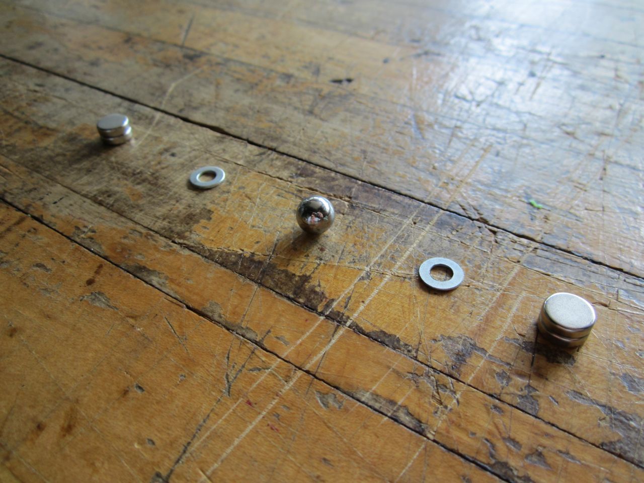

Lastly you need some carbon rod, hollow, mine is 10.16mm OD and 7.55mm ID (inner diameter, outer diameter) and you will want to cut these into very precise 246mm lengths, you'll need 6 of them.
Then you glue the magnets into the ends of the rods (JB weld works great!) being very careful to make sure they all are exactly the same length. You may want to hang the magnet out of the end of each end on each rod so that you result in a combined length overall of exactly 250mm (10"). Similar to this.

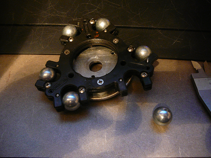

The next part is the installation of the bearings into the x, y and z uprights. This is nearly the same as the hotend carriage but I had to add slightly oversized washers leftover from my build to center and hold them in place. You could also jbweld them here as well.
The nice thing about the magnets is they already have a plastic bumper surrounding them to reduce friction which is ideal for our purposes.

The lining around the magnet keeps it locked in center. And yes, the bearings snap extremely tightly into the spots regardless of your previous sanding because there are what appear to be molded in spots for prehaps a nut? But everything locks in real right and the fricton is gone, it's so smooth.

I was tired of sanding and bought a set of Geomag toys. The steel balls in the Geomag set measure exactly 0.50inches so they wont just snap into the platform or carriages. They do however center themselves decently in the hexagonal holes in the platform and carriages, just off to one side.
You might want to check your arm lengths though. The magnets will rotate about the center of the ball, and assuming you have the balls centered at the stock pivot locations, you're going to want your arms to measure about 254 mm. Stock arm length is 269mm from hole to hole. Minus one ball diameter of 15mm gets you 254. This is still aproximate because your magnetic "cup" may vary and may not represent the point at which the rod contacts the ball. I hope that makes sense... Of course you could make the adjustment in software.

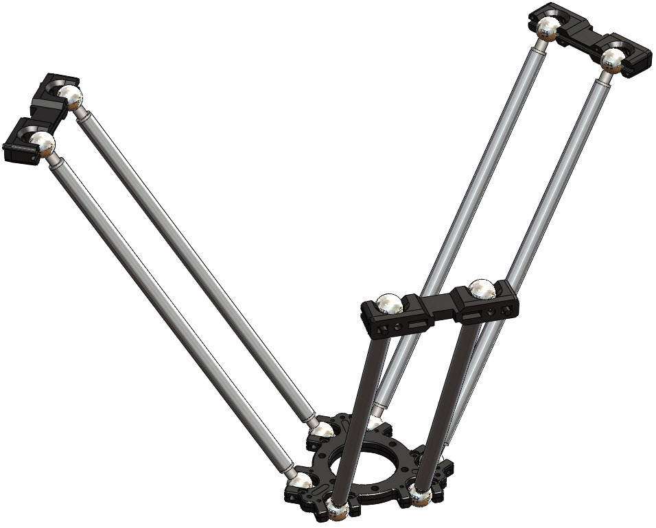

So do you have full range of motion? I modeled something up in Solidworks and it looks like my range of motion is limited. Maybe because I drew the bearing cup at the same diameter as the rod, (although the rod I used is smaller than what you posted.)

I sat down and did some modeling this afternoon along with a little price checking and came up with a source for magnetic balls. I am planning to make up a set of rods with mag-ball joints at either end. Mine will have precision machined and polished contact points, but once I have the machine set up, it's no big deal to keep running it if others want a set. From what I can tell, a set would run in the $40 - $45 range complete. I am even going to set up a jig that will allow me to epoxy the ends in place to obtain a precise length. I need to gauge interest in order to purchase the appropriate material quantities, so if you are interested in a set, PM me and let me know. My design has a 15mm ball snapped into the lower carriage, so I need to confirm that size is correct, (flateric)? It mates to a precision steel part that will be epoxied into an aluminum tube.
