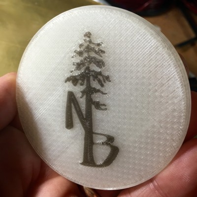

I am becoming a fan of switching hotends like Cyclops and Diamond. They address 1-3 above. Slicers are an even bigger challenge for them though as they do not give the control needed for switching from one color to another. At some point they might but that's pretty far off (>year at least). I'm talking about advance switching controls like burying the color change in the infill of a part, etc but even the simple priming towers and skirts are primitive. But I have been able to RELIABLY print some pretty sophisticated 2 color parts like this:
