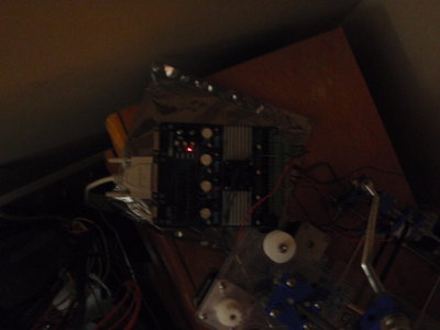

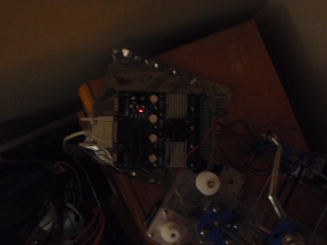

lol Yeah , took a break from studying. I didn''t get an easy driver board
Re: My build thread
Tom, you got the 4 axis stepper control board, you use the A axis on that board as the extruder, so no easy driver used with that new board

ok thanks , so i just plug it in the same way as the x y and z motors?

Also, to answer your question - yes, the A axis (extruder stepper) simply plugs into the 4 axis ports alongside the X, Y and Z.

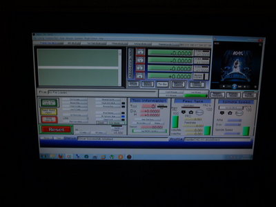

thanks, tried re wiring it but nothing , got my entire h-1 assembled except the velleman, fooling around the mach 3 I have no idea what im doing

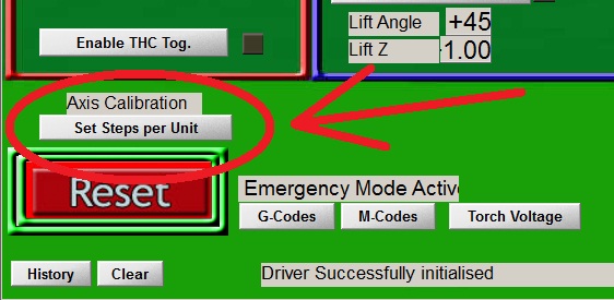

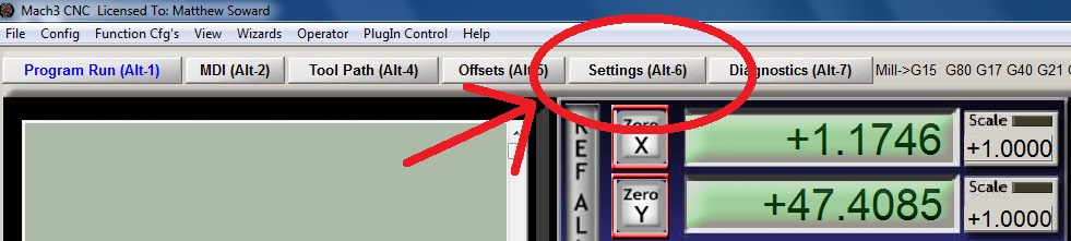

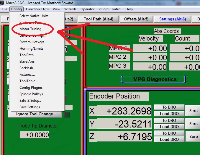

Tom,
Look on the Mach3 configuration forum for more details on wiring the 4 axis board and using Mach3 with it. Here is a link to the forum for that board http://forum.seemecnc.com/viewtopic.php ... 2392#p2392. For using Mach3, on youtube there are 5 videos from the programmer outlining the functions and operations. Here is a link to outland86's youtube page, the first videos are the 5 tutorials http://www.youtube.com/user/outland86/videos. You want to make sure first that your motors are going the correct + and - for each axis. In the seemecnc manual, they outline the correct + and - direction for each axis. In the above forum link you can find how to reverse the direction of the motors if they are not correct. You can also verify this by opening Mach3. Hitting the Reset button to gain control of the H-1. Next hit the Tab button on your keyboard to open manual control of the H-1. On the right side of mach3, you will find + and - buttons for each of the axis. Clicking one of these will move the H-1 and the correct + and - direction can be determined from this. You can now start tuning your motors for the correct travel. You will need some kind of distance measuring device. I would suggest a machinist's dial indicator, here is a link to one http://www.harborfreight.com/1-inch-tra ... r-623.html. You will also need something to mount it to, I suggest a multipositional Magnetic Base, here is a link for an example http://www.harborfreight.com/multiposit ... -5645.html. To calibrate, position the Dial or measuring device on one of the axis of travel. Now within Mach3 look to the top of the program and look for the Settings button, Pic below. On this screen you can tell the H-1 to travel a set amount. Keep in mind also the amount of distance you request the device to travel will be either mm or inchs. This was set when you first installed mach3. Before you start calibrating take a look at the motor tuning profiles. To access this information Click the Config menu item, then Motor Tuning, pic below. Each axis is represented on the right and in the above forum link you can find profiles from me and mchackney. Now that you have setup your motor tuning profiles you are ready to calibrate. On the Settings page Click -> Set Steps per Unit Button just above the Reset button, pic below. Now select the axis you want to calibrate from the corresponding box, X,Y,Z and A (A= Extruder motor, to calibrate take off the Extruder tip and measuring the distance that the filament travels from the indicated amount entered after you select the A Axis for calibration. The travel should match this distance.). Each time you tell the H-1 to move Mach3 will then ask you how much it really traveled. You can use the feature but adjusting the profiles manual is usually best. After you have calibrated each axis you are ready to start printing. Make sure your bed is very level. The extruder is going to be printing around .3mm from the bed and any miscalculation will be visible in your print.

Re: My build thread
thanks alot , can i just use a ruler though? if so what are the units in?

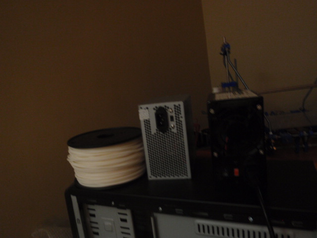

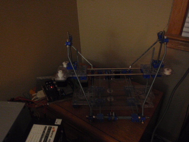

Little late but heres some pics of my setup ,

Finaluy up and running , now i gotta fix the x-axis skew, jumepering the optos now
