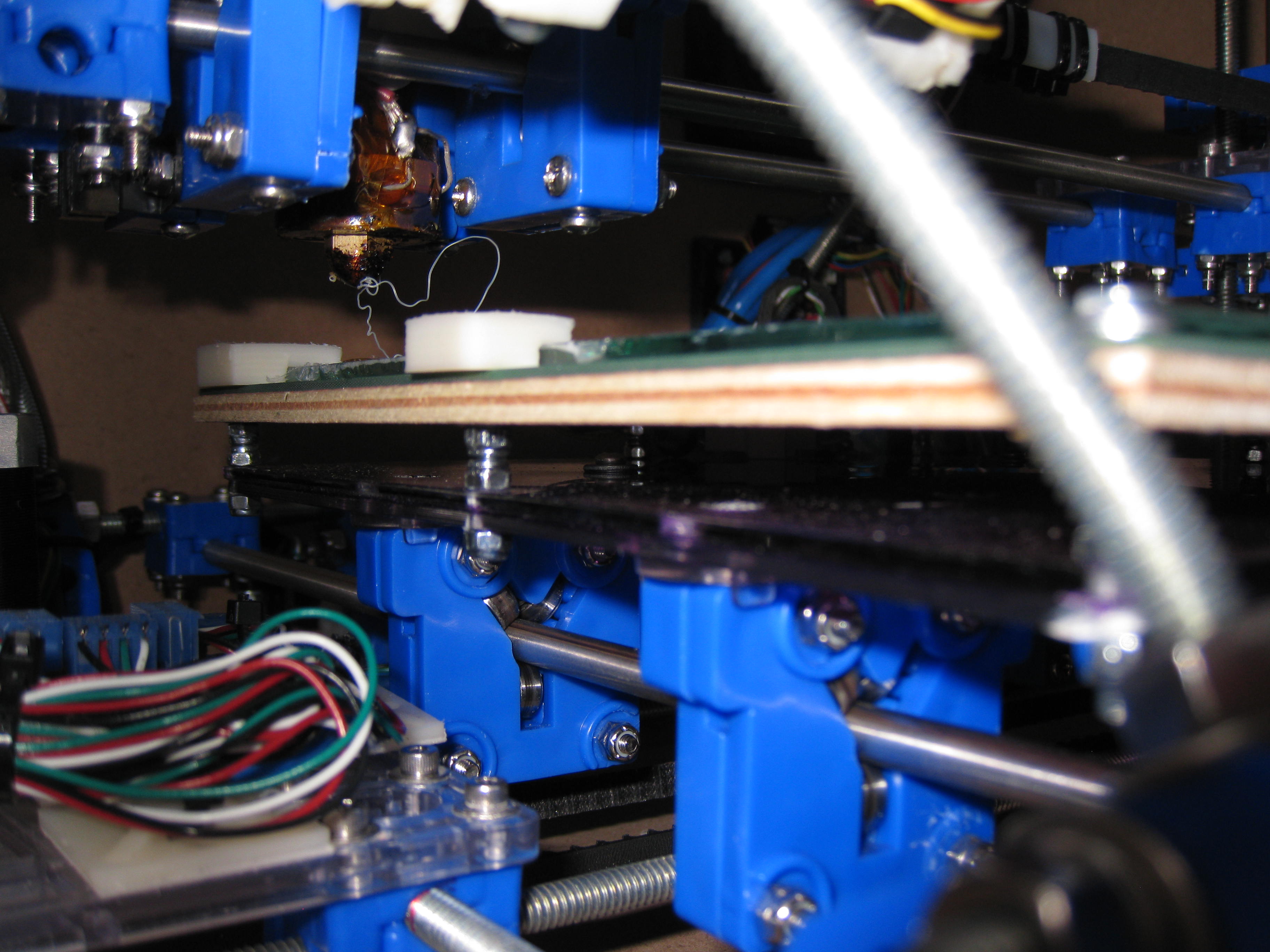

jbinion
Posts: 84
Joined: Mon Jun 04, 2012 11:46 am
Re: (Group Buy) for 7"x7.5" Heated Bed
Post by jbinion »
Is this thermistor that you are using for the bed?

michaellatif
Posts: 357
Location: RTP, NC
Post by michaellatif »
jbinion wrote:Thanks,
I still need to work on how to make the heated bed so it won't warp the x axis bed so I still have a bit of time.
jim

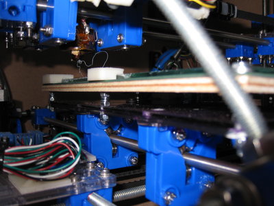

As most others I use spacers, bolts and nylok nuts to attach the bed. Some folks use a thermal barrier, previously on this thread folks are using a McMaster-Carr item to reduce the heat transferred to the acrylic bed. The PCB heated bed is easy to mount, it has 8 holes that line up on the outside edge of the H-1's bed. I put the two together and drilled holes in the bed. Using a bolt and two nylok nuts I made the first plate that holds Phebe. Then just drop the bed on the H-1's bed and add more nylok nuts. I can take pictures tonight if you are interested in mounting options.

michaellatif
Posts: 357
Location: RTP, NC

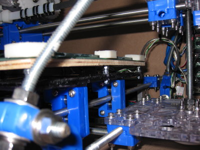

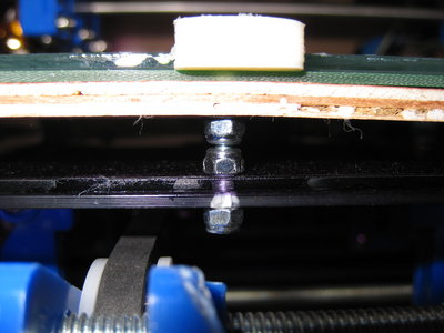

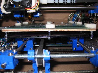

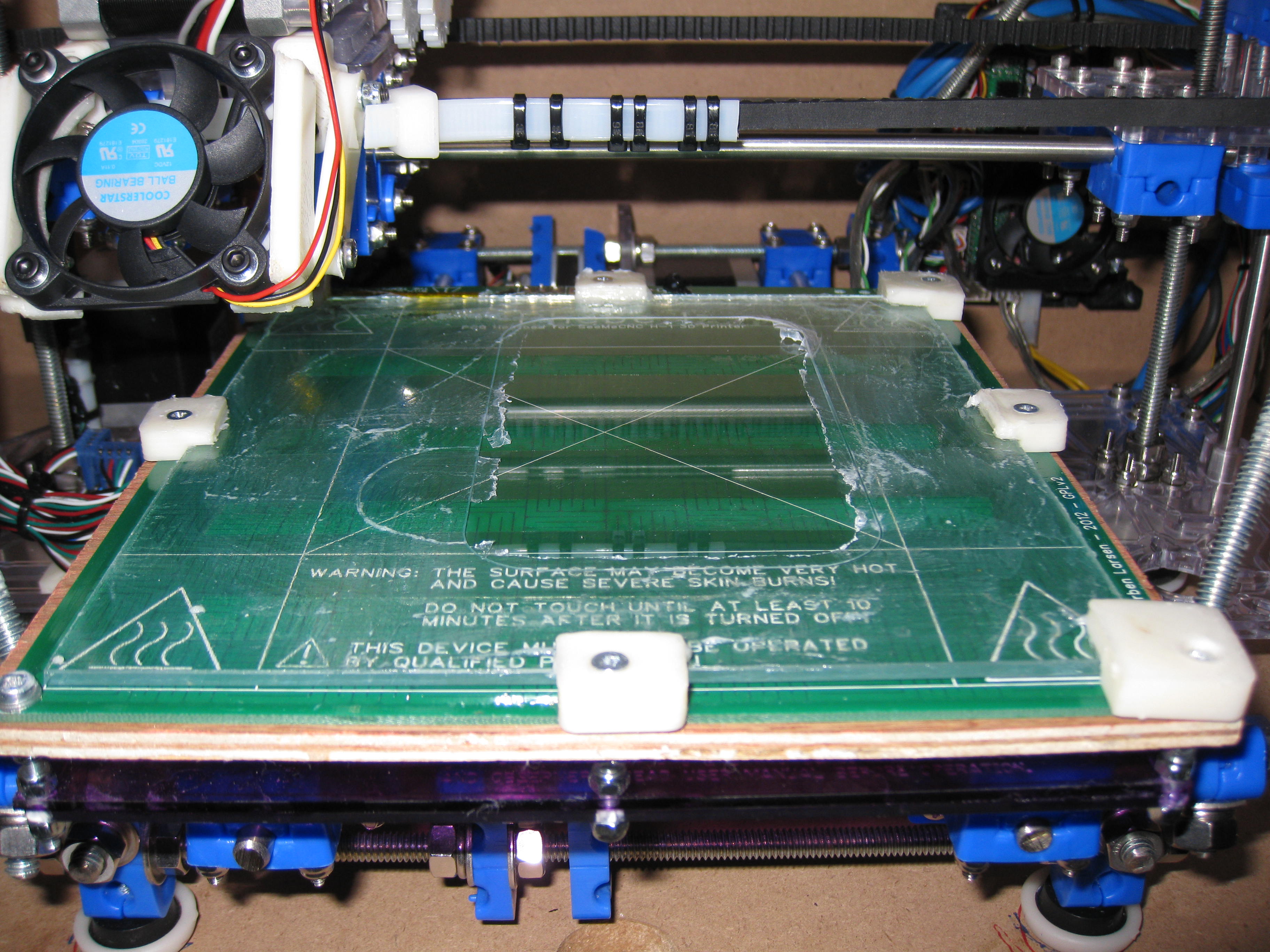

jbinion wrote:That would be awesome. I'm pretty close to finishing!
Hey Jbinion,
Here are some pictures and a quick description on how I mounted Phebe I.
The layers are from top to bottom: glass, Phebe I, 1/4" plywood, air gap (about 3/8"), 1/4" bed.
The bed was thickened to provide rigidity, I just glued another 1/8" plexi-glass plate to it, that's what the purple is, ABS/PVC cement.
The plastic glass retainers are the following from thingiverse.
http://www.thingiverse.com/thing:23387
I just printed 4 of each bed standoff and clamp (pick the size that best suites your glass)
I lined up the bed with Phebe and marked all the holes I needed to drill plus a few extra in the H-1 bed for strain relief for the wires.
Then I just used nylok nuts and bolts. The pictures show one bolt per hold with two nylok nuts under the glass/PCB/wood sandwich.
The front left plastic glass retainer was left off because the extruder tip homes there.
Alignment/leveling is really simple, just use pliers or wrench and screw driver and set the height of the eight bolts individually.
