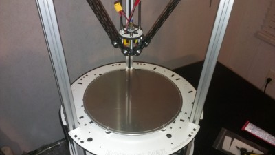

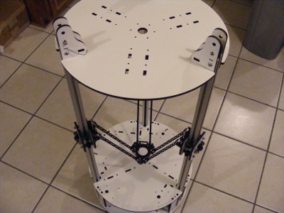

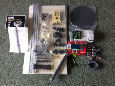

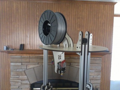

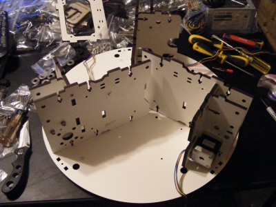

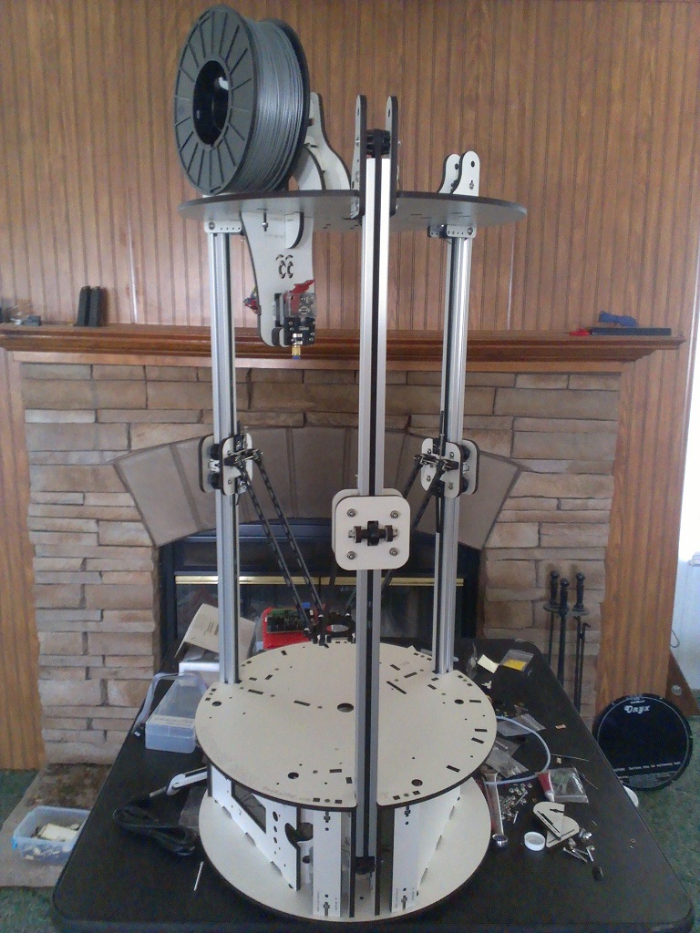

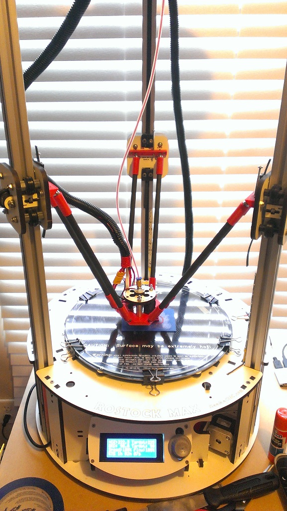

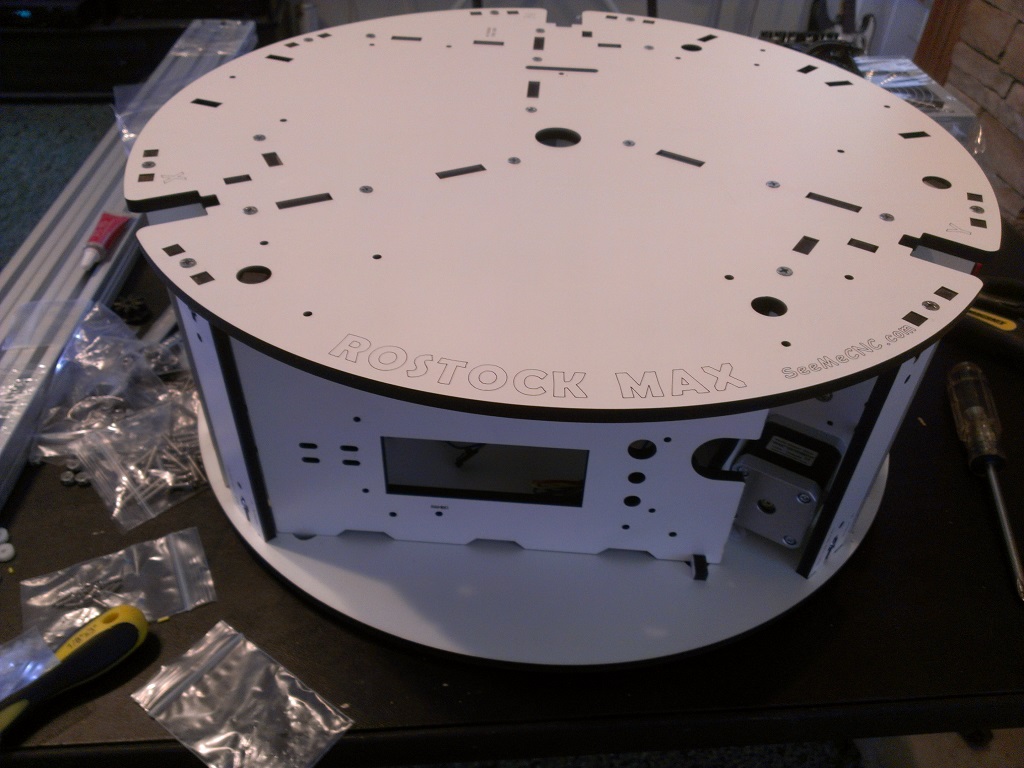

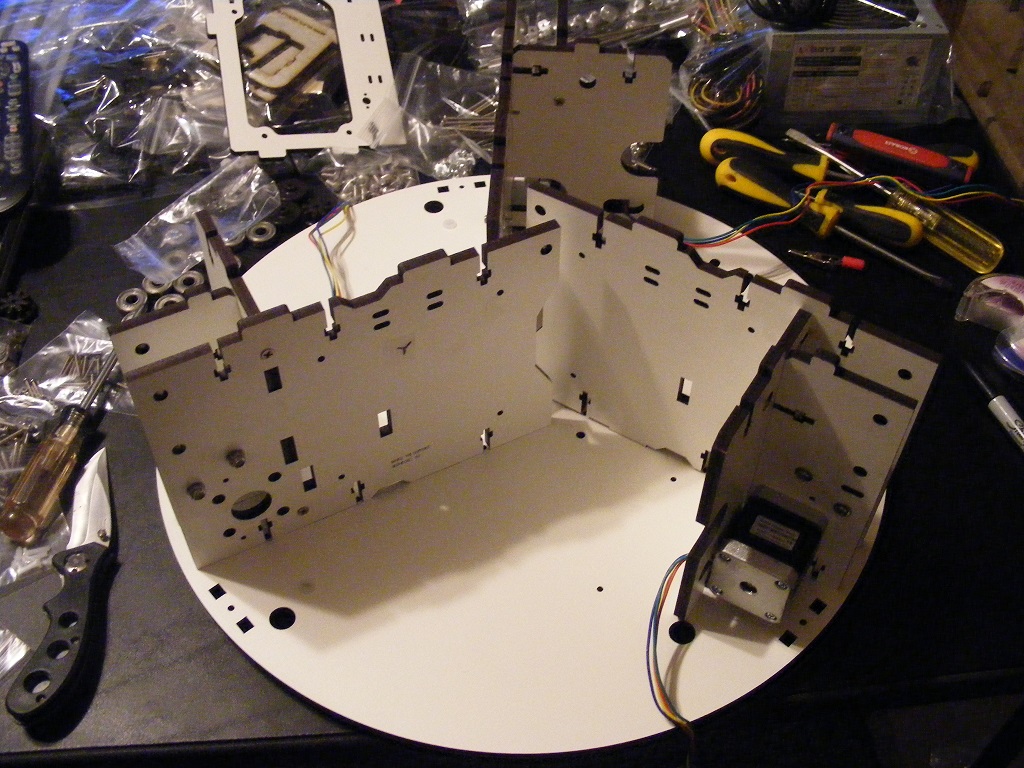

Got the Kit and stated the build a little while back, I am now back on it. Hopefully printing this weekend.
I got the BORO Glass lastnight in the mail so I went ahead and cut a 1/8" thich 6061 Plate to go between the Onxy Head Bed and the Boro Glass.
Joe

Your build is progressing nicely, good job!

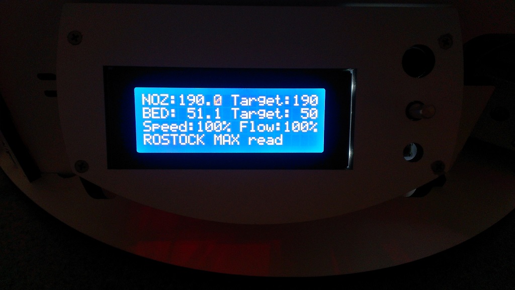

Got the homing working well, and the heat bed and extruder heating like it should times are not to bad, If it is accurate I need to measure it to make sure.
Heat Bed From 20.6°c to 50°c = 2min 52sec
Extruder From 28.8°c to 190°c = 1min 8sec
Now to do some testing and calibration

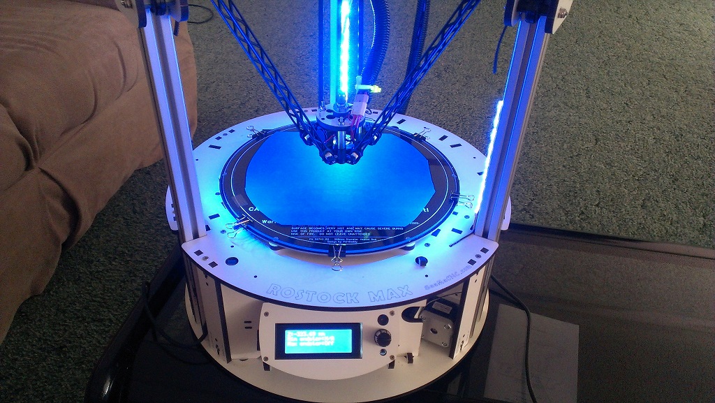

On a side note added some LED's

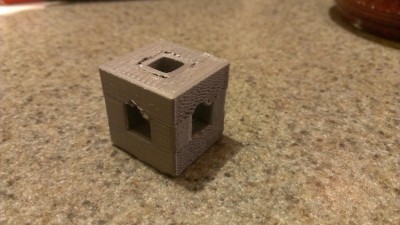

Re: Joe's Rostock Max
First Ever test print, I need to learn how everything works, Anyone have their configuration.h file and some gcode files for abs that I can see your picture of the parts and study the codes?
Is there a place someone has posted their setup for repetier some screen shots for slicer? I know its asking allot but I'm a hands on kinda guy, its easier for me to see than to read and try to figure it out.

Nice build by the way. I like the blue LEDs. They don't interfere with the cheapskates?

Blue Leds are cool! Fantastic look!

Yea but they do a number on your eyes, I may as another set which is white on the other side of the extrusion, and I can have a switch for white and a switch for blue.Eaglezsoar wrote:Blue Leds are cool! Fantastic look!

There is no interference with the cheapskates?joecnc2006 wrote:Yea but they do a number on your eyes, I may as another set which is white on the other side of the extrusion, and I can have a switch for white and a switch for blue.Eaglezsoar wrote:Blue Leds are cool! Fantastic look!

None the LED's are 6" long I think the cheapskates do not travel down that far.Eaglezsoar wrote:There is no interference with the cheapskates?joecnc2006 wrote:Yea but they do a number on your eyes, I may as another set which is white on the other side of the extrusion, and I can have a switch for white and a switch for blue.Eaglezsoar wrote:Blue Leds are cool! Fantastic look!

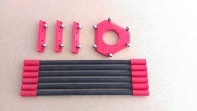

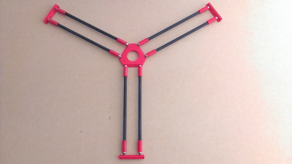

Installing the Mag Arm Mod.
Joe
joecnc2006 wrote:Installing the Mag Arm Mod.
PINK!
- joecnc2006
- Posts: 150
- Joined: Tue May 14, 2013 11:42 am
hahaha, No its red and black the picture makes it look pinkish, I printed it in ABS for now, I am going to remake it in all black I got a role of Black PLA now and will start to practice with that.bubbasnow wrote:joecnc2006 wrote:Installing the Mag Arm Mod.
PINK!
Joe
- joecnc2006
- Posts: 150
Got it installed and printing now after calibration setup. running real smooth, not I do not hear the creeking from the Old Arms, it is pretty smooth, Will need to put some locktight on the screws for the ball joints.

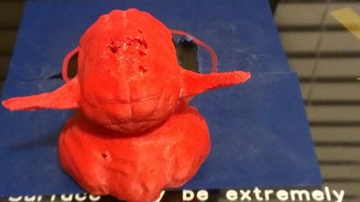

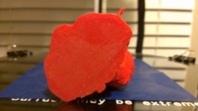

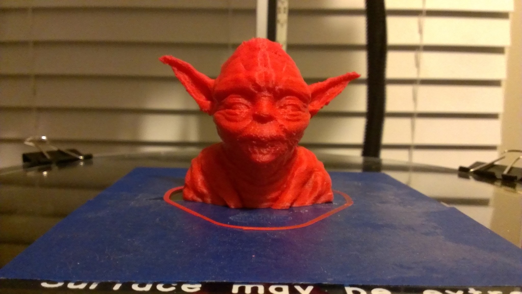

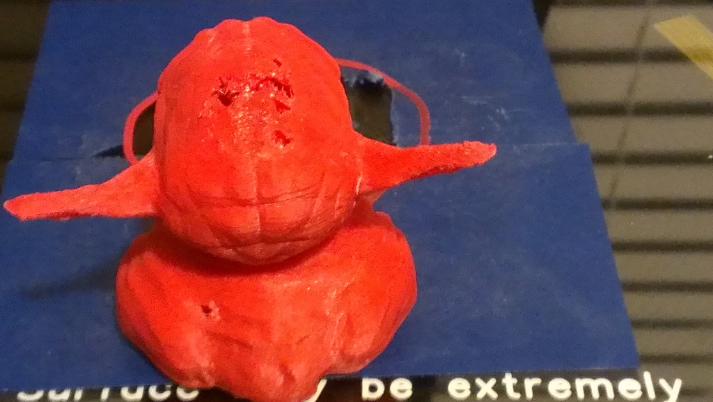

Testing the New Arms, they are running really smooth, I used a 3/8" round nose bit and smoother out the printed Ball bearing slot on the Arm End Pieces, help to make it smoother by allowing the ball to sit perfect in the recess.
Here is a test Printing a Yoda, Print came out nice but had a couple of problems not sure why but its all part of the tweeking process.
The Bottom came out really good the fill was just about perfect and no gaps.
[youtube]http://www.youtube.com/watch?v=aL3wABJZZGc[/youtube]

- Posts: 2430
Depending on what you used to slice it, some slicers do what you're seeing at the top of Yoda.
There are a number of places in the Yoda model where the filament is literally extruded into mid air, it always astonishes me it comes out as well as it does.
Usually adding say 20% infill will "fix it", but I wouldn't worry about it.
