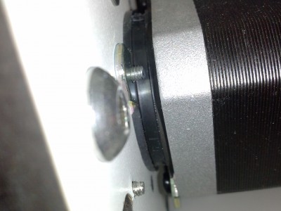

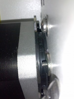

I figured I might as well install the dampers while I wait for the rambo to arrive. It took like 45 minutes or so total to do it. I forgot to put threadlocker on the very first one so I had to undo it but it was a learning experience. One bent L shaped screwdriver later I got the dampers on.
Here's some pics of the dampers.

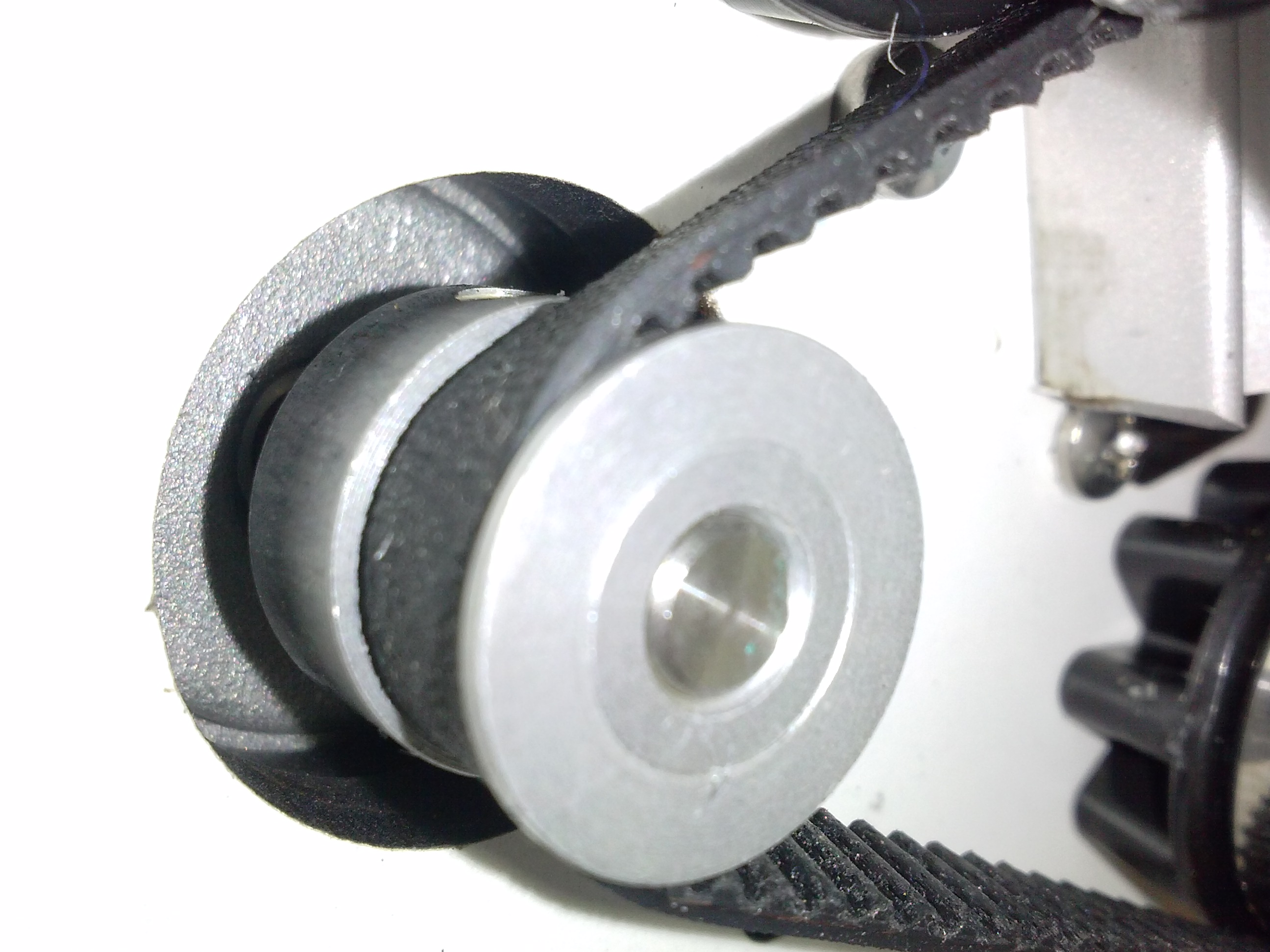

Not sure if the belts being at a bit of an angle will be a problem or if I should somehow correct that?

Belts should not be angled like that. Sprocket groove should line up with bearings so belt runs straight.

Earthbound wrote:Belts should not be angled like that. Sprocket groove should line up with bearings so belt runs straight.
Thank you, I already googled and found out the problem for it and I'll be fixing it tomorrow.
