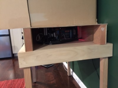

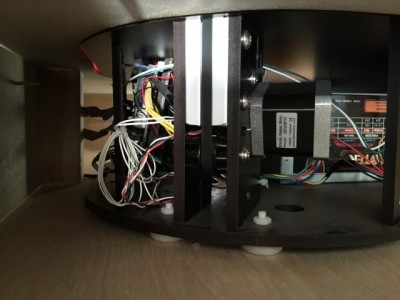

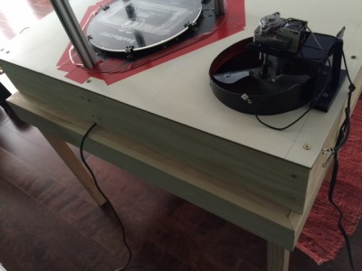

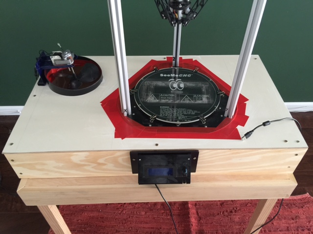

I was 2+ hours into a big print and the machine cut out--literally, like it died. I filpped the ON/OFF switch off, then back on and Viola, it fired up. I had had a box around EVERYTHING--including the base--which turned out to be kinda dumb. It overheated.
So, I built this:
Only one side of the new cooling box is open--opposite the fan.
I removed all covers for the base for optimum airflow in and around all components.
The heatbox has a fourth wall to use while printing.
scooter it.

The fan is from a space heater with a bad heater element. Perfectomundo for this application.
