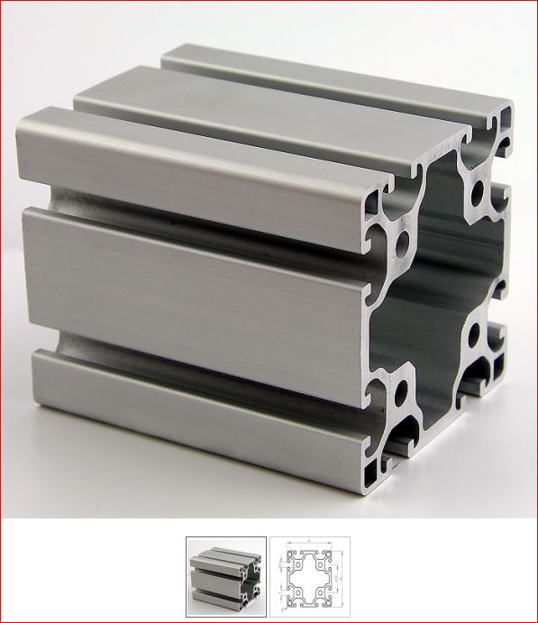

- Higher torque also, so I think Nema 24 or 32 is the choice. But there is the question which kind of amps should be taken for such high torque steppers? I guess we will need extra Amps between the controller and the steppers.
- High rigidity, such Alu moulds profiles are very sturdy. http://aluprofile24.de/product_info.php ... hnitt.html" onclick="window.open(this.href);return false;
- For the heat bed I have seen many month ago someone who crated a heat bed by himself. He used a selfmade ceramic bed, it was a molded bed with heatspiral inside. This should be adaptable to a sectoral controlled heatbed.
Not very similar to this, but it can be hint.
