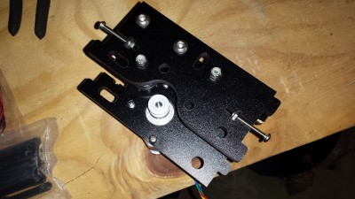

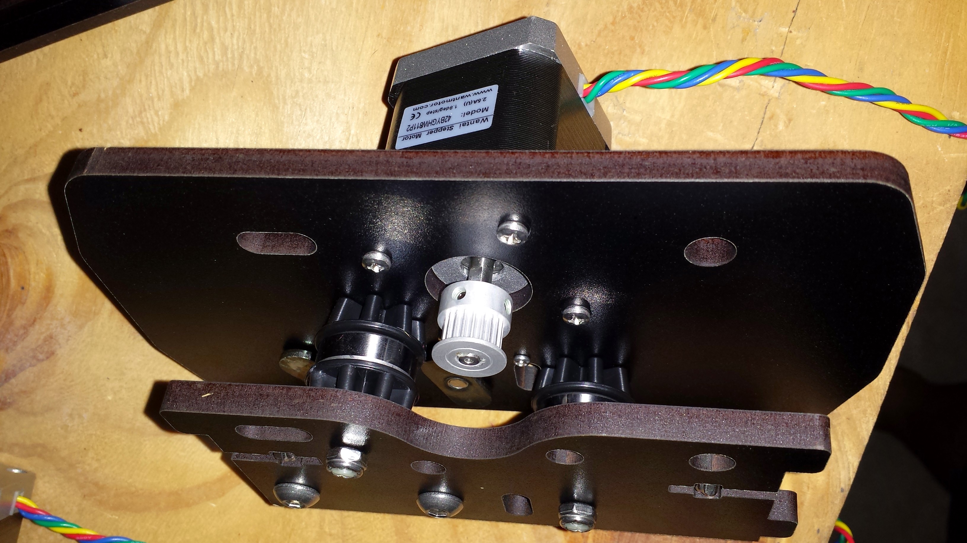

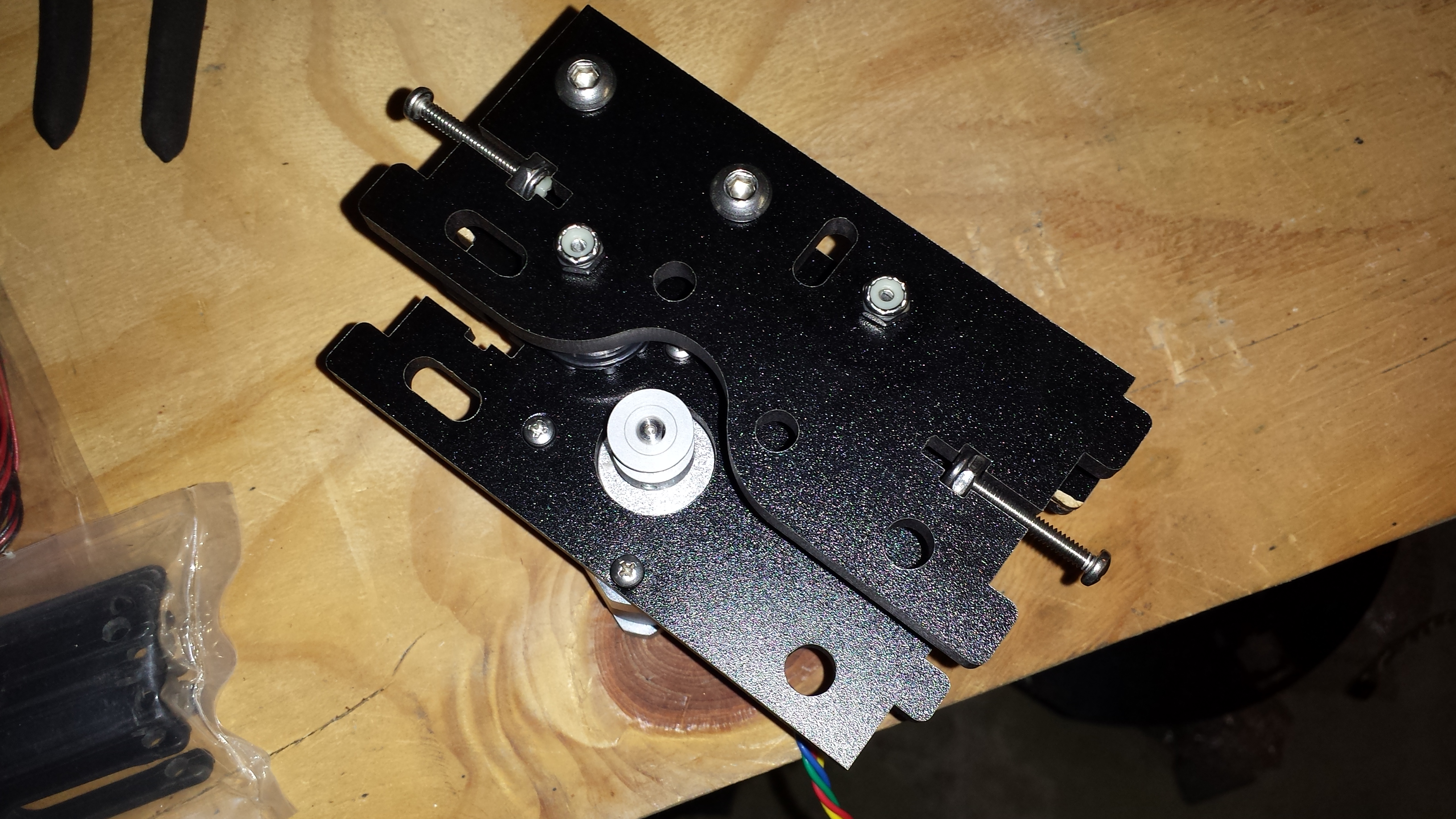

Hello everyone. I didnt end up on here until after i built my machine, got it calibrated, and got 25 hours worth of prints done. Wish I would have read these posts before I started.
I got started in 3D printing a couple years ago with a buddy when I determined I wanted in on the action, but didnt like any of the printers on the market. So we decided to start designing our own. At some point I realized I needed to put theory to practice before I turned ideas into prototypes. Eventually I scrapped all my cartesian ideas and when with something that seemed a little less limiting, a Delta. I've really been wanting to print a specific set of items without the need for post assembly, so i was looking for a large printer. the Rostock Max doesnt quite fit my requirements, but one cant beat the value!
With that settled I decided to visit Matter Hackers and discuss the disadvantages of the printer i was about to buy. Unfortunately the guy that came to help me didnt seem to know much about the printers, but pretended he did. I ended up leaving with a Black Rostock Max v2 and since I was told it didnt matter if I used PLA or ABS, I went with PLA. and with that, I was told I had everything i needed; off i went.
I started going through the contents, checking to make sure i had everything. I was plesently surprised to find one extra piece of hardware of every type! My build then got postponed when i discovered that I needed to go buy more materials. I started setting up the printer that night when i discovered that my motor mounting brackets not only didnt look like the picture in the instructions, but seemed to be way too big to fit in the base. I went back down to the two days later (they were closed the next day) I got replacement parts. got the build done and then calibrated friday night. I had two leftover fans that were in the build materials, but not in the instructions anywhere! so i decided to press on. thats when i discovered that I needed ABS. So the next morning i ran back down to MH's where I got to speak to the director for the second time. He actually took the time to explain the limitations and the upgrades that i may eventually consider along with showing me his personal rig and the modifications hes added. very nice experience.
The next day i was back at the machine. with the extruder calibrated i was ready to print my first part. To my surprise everything went perfect and i got a very nice print. shroud 2 took two prints as the first one had some glass adhesion issues.

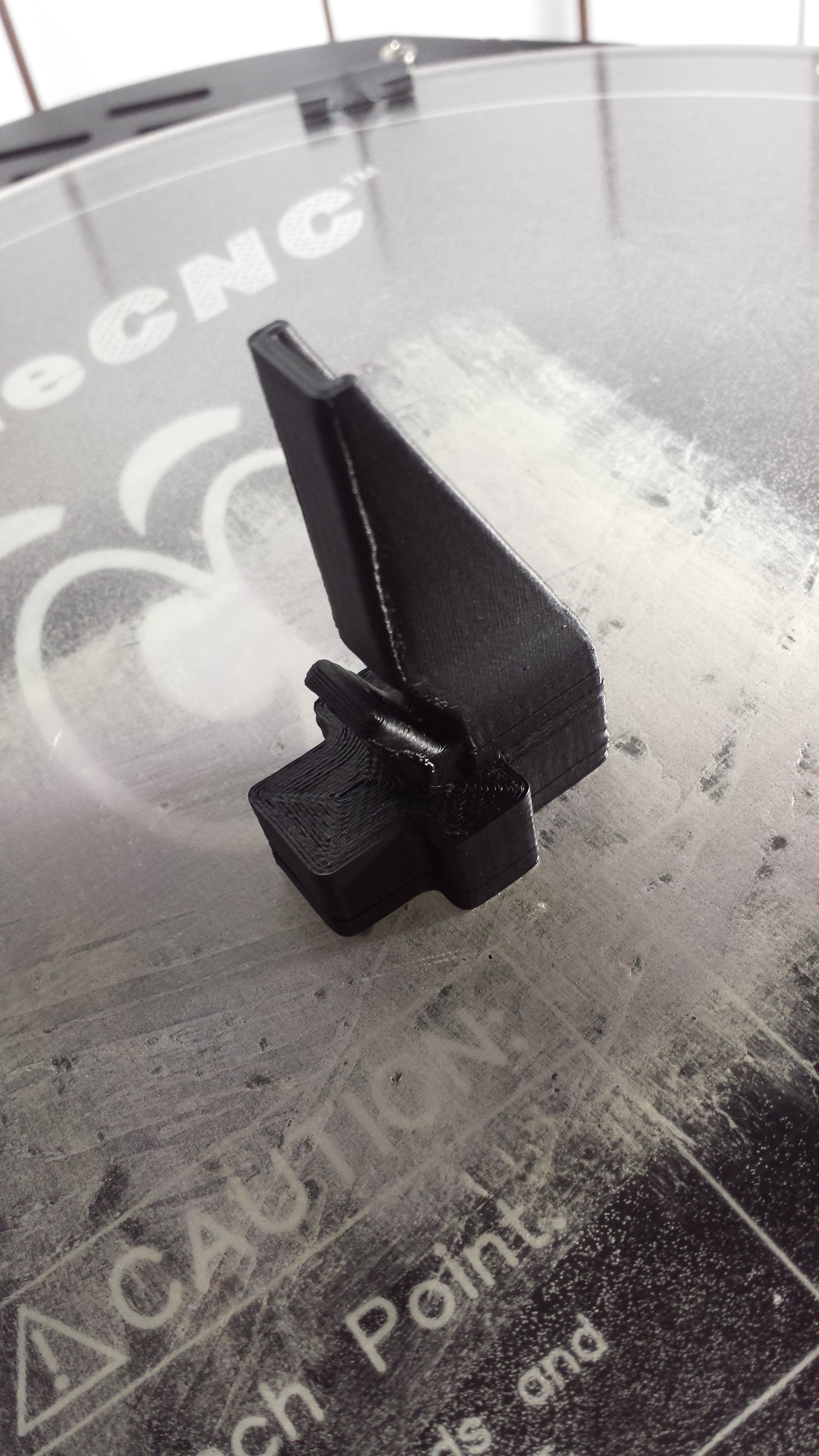

Its been a 3 weeks since i've been on the forum... I've been printing like crazy! Almost something every day. I've gotten a few failed prints and figured out how to improve these things. Todays failure was a little different. I checked up on it at 1pm and everything was going well. I checked back at 4 and i had 40 minutes left but the hot end was considerably above the parts. It appears it had been printing for hours, but not actually extruding anything. I killed the print, cleaned everything up, got the filament rolling again. then it clogged again. I decided i'd need to fully disassemble the hot end and clean it out. thats when i looked down and realized my screen was blank. I've verified the PSU fan and the RAMbo fan are both working, the fuse looks good still. I can get REP to connect to the printer, but its not getting any info. It doesnt detect the bed warmer and it thinks the extruder is at 0 degrees Celsius.
What just happened? Any help is welcomed.

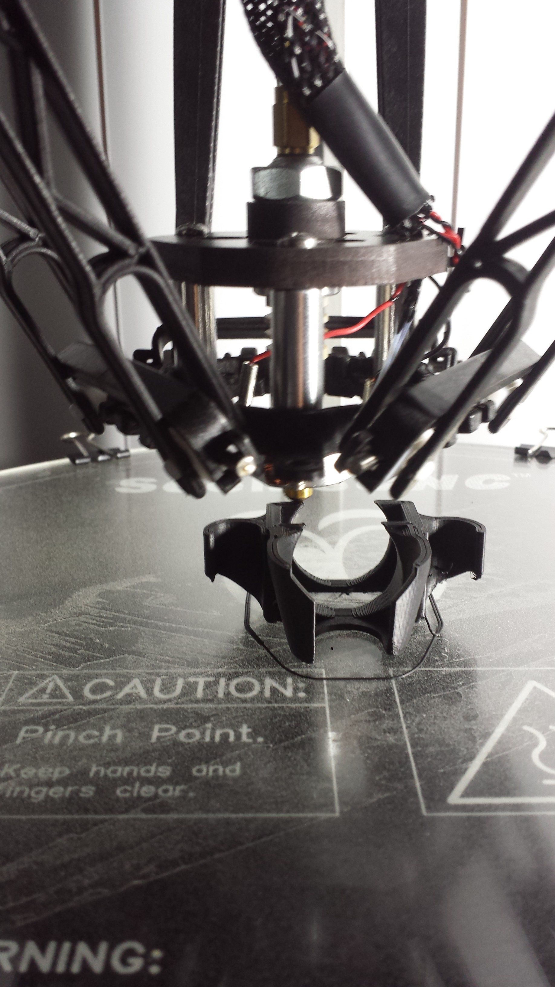

I ordered 3 new fuses from Newerk since SeeMeCNC said I'd have to order them from their site, but then didnt have them. Without paying $60+ in shipping, Friday is the best I could do... But I have prints that have to be ready for Saturday morning, so I was a little stressed. Luckily Matter Hackers said they would just post me one, so I paid them a visit since I wanted new filament as well. Got the new fuse, installed the motor silencers, and got back to work.
Still having a significant amount if issues with the filament. my print ended up printing less than 100% filament. Then it jammed again. Again I couldnt get the filament out of the hot end. The difference this time is that the hot end was actually hot! Then it became clear as to what my issue was... My gold PLA is from Maker Geeks and was their $20 surprise filament. well surprise, it has sections that are too thick to fit through the bowden tube couplers.
I'm printing with black PLA I picked up from Matter Hackers a month ago and this print is coming out so much better! It occurred to me that the extra force put out by the extruder motor could have been the reason the fuse popped. Makes me feel so much better!
I purchased some Pro PLA yesterday from MH as well... It'll be interesting to see how differently that prints.

So the Pro PLA was doing significantly better, but I still had issues. I turned down the heat and added a fan. Both helped, but I still ended up having several clogging issues even when using the Pro PLA. I decide that maybe upgrading to the E3D v6 might be the smart way to go. I took the opportunity to replace all my soldiered connections and replace them with quick connectors. There are a few things the folks at MatterHackers left out (they seem to be good at that) when they sold me the E3D and their printed holder. First off, its much larger than the stock risers and you need new hardware. This also means completely re-calibrating your printer and losing your layer fan, or buying a different mount (which is the route i went). Also to utilize the higher temperatures, you'll need to change some coding... I havent figured that part out yet, hoping to find something on these forums...
