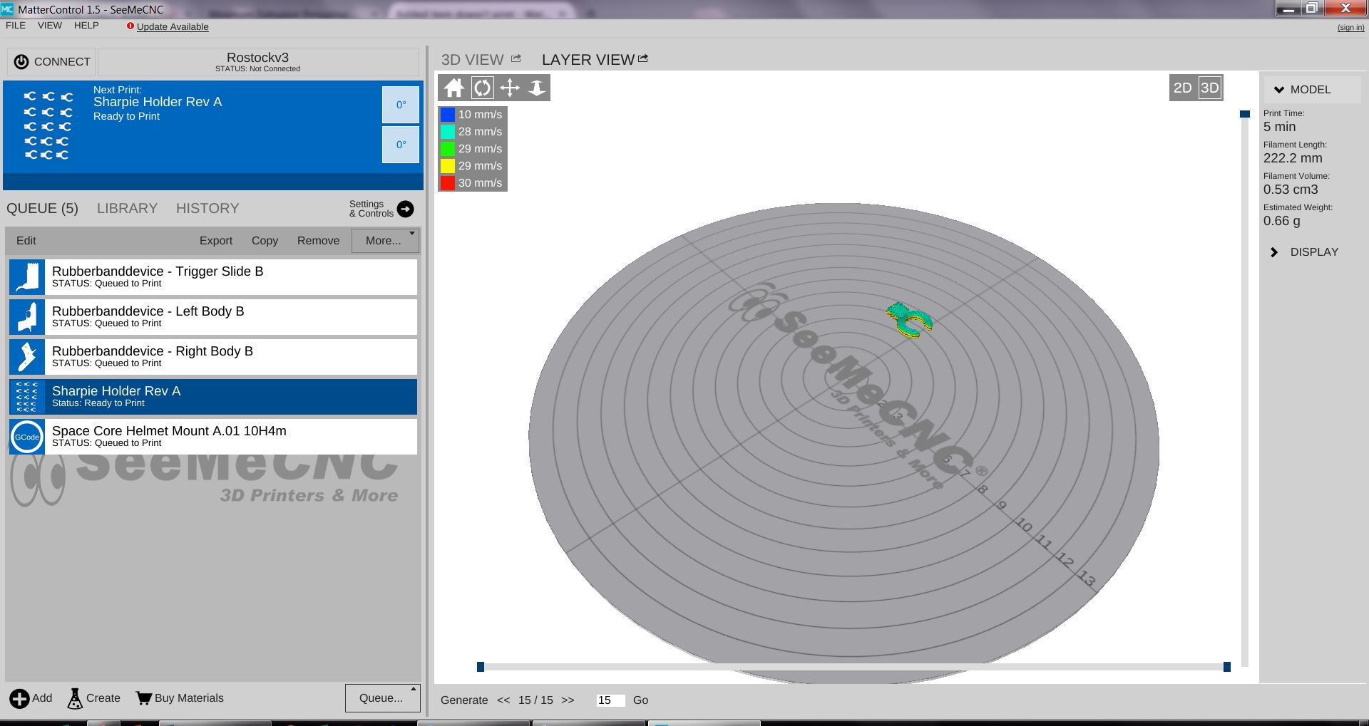

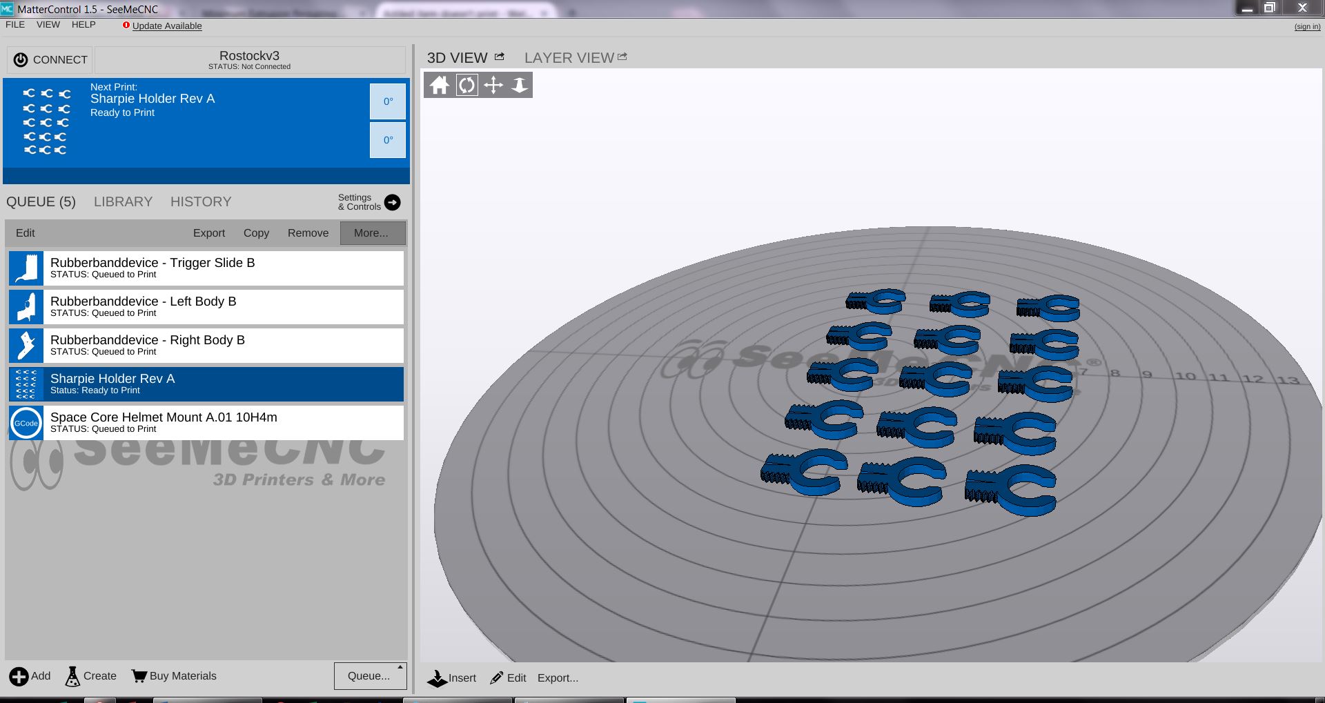

I've used the "insert" function to make a 15-up arrangement of some small parts. When I slice, only one slices. The kicker is that the one isn't even the original added object... Any ideas what the heck is going on?
Thanks,
-Matt

You need to save your 3D View window before going to Layer View.

Thanks for the reply. I was doing this. I also went so far as to make an stl with multiple shells. It worked with other files but still wasn't working for this one. It wasn't until I decided to change my pre-defined print settings for that file to another one just to see what would happen. It worked! But why?Jefrysuko wrote:You need to save your 3D View window before going to Layer View.
I dug into the settings and realized Spiral Vase was set to 1.
In case you're running into the same issue I did - make sure Spiral Vase is NOT enabled. Mattercontrol will not let you slice multiple shells when you have Spiral Vase enabled!
