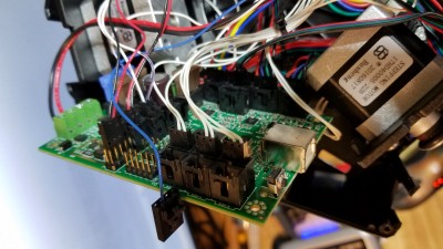

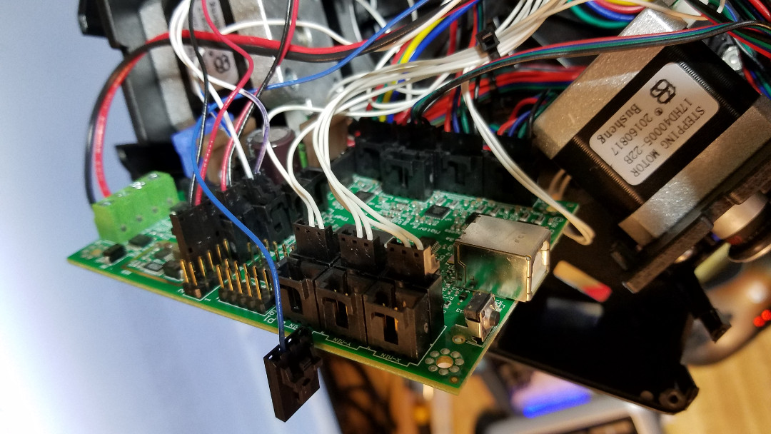

I was replacing the stock motors per Jetguy's suggestion, when I noticed that a connector with only one blue wire had come loose:
The pin header it seems to go to is five pins wide, and the connector is four pins wide. It can be attached facing either direction. This means that there are four different ways it can be connected, only one of which is correct. How does it plug in?

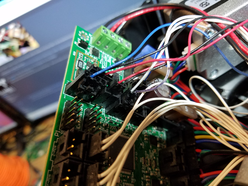

It goes right behind that plug with the thin red and black wires... the wire connects to the second pin from the edge of the board, so you will line the plug up with the top pin (the plug with the red and black and offset by one pin, this way the two plugs can butt up against each other)

I'm a little surprised SeeMe used two 4-pin connectors instead of a single 10-pin connector for a 10-pin header.
