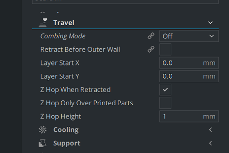

In simplify3d (which I am more familiar with) the setting is under the layer tab, start points; it has three options random, optimized, and x-y coordinates. Sometimes I use optimized, random, or 0,0.
In Cura - I found a similar setting by searching for "start." Start lets you specify an x,y. Start is an item under "travel"

im a little confused as to what to set the settings to, and which one to change, id like the layer height to change on the inner wall perhaps, not the outer wall. but im not sure where to chage and what to try changing to...
ive attached a pic of the section 'travel' in the cura.
i do see the X & Y coordinates setting for 'start' the next layer, but dont understand what to set these to... or what to try setting them to...

Slicer
By specifying an X, Y for "layer start" you are telling your slicer where you want the seam to be. The center of the bed is 0,0 with x = 0 and y = 0
The bed goes x in the positive direction and y in the positive direction; and it also goes x in the negative direction and y in the negative direction.
In the print you referenced you can instruct your slicer to put the seam in the center hole of your print so it is no longer visible.
