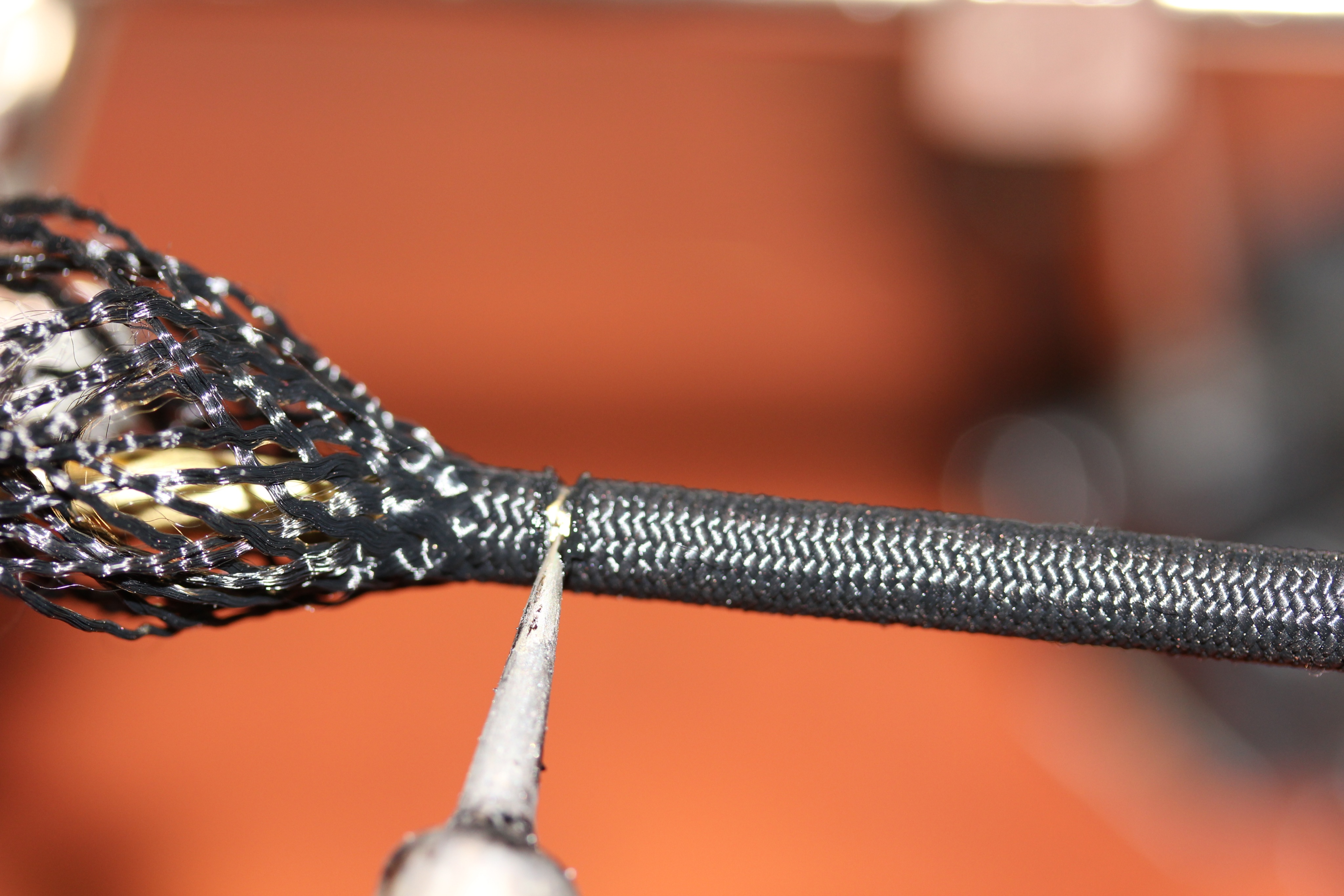

I learned the paracord trick from Bart Dring, who runs buildlog.net. But I can't find a description, nor even any pictures, on that site now.
Parachute cord has a nylon sheath around a bundle of longitudinal fibers (also nylon, I think). You don't need the mil-spec stuff; wire dressing is not life critical. It comes in lots of colors, so you can color code your wiring, but I just used black. Many sporting goods stores sell it. I got mine on Amazon.
Cut a piece of cord about an inch longer than you need. Pull out the inner fibers and discard. Slide the sheath onto a metal tube. (This is the hard part; see below.) Using a soldering iron you don't like very much, melt-cut a ring around each end of the cord. This leaves a fused nylon end that is round, not flattened. Pull off the frayed ends and discard.
I hate you, solder tip!  I coat you with gummy nylon!
Next, stuff the ends of the wires into the tube and slide the sheath off the tube and onto the wires. Slide on a piece of heat shrink tubing.
Note: these wires are too big for paracord.
Attach the connectors to the ends of the wires. Slide the sheath into place, then the heat shrink. Heat it and shrink the shrinkable, being careful not to melt the nylon. El voila!

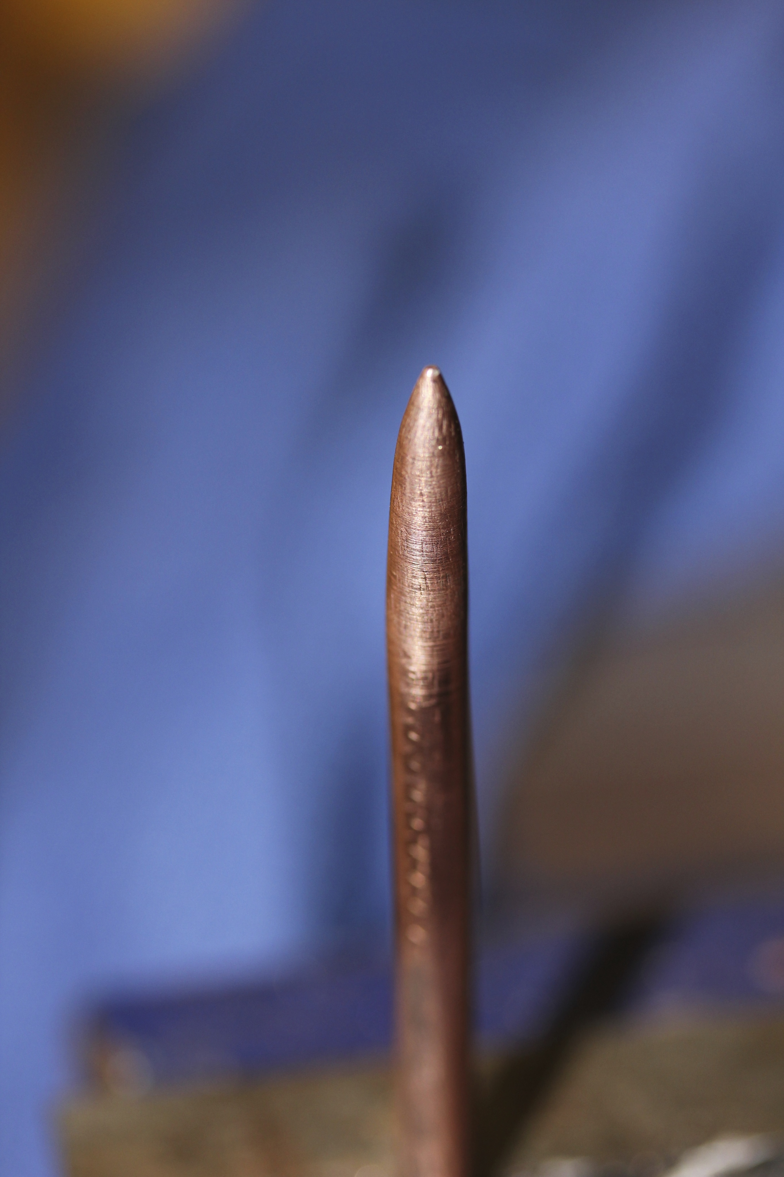

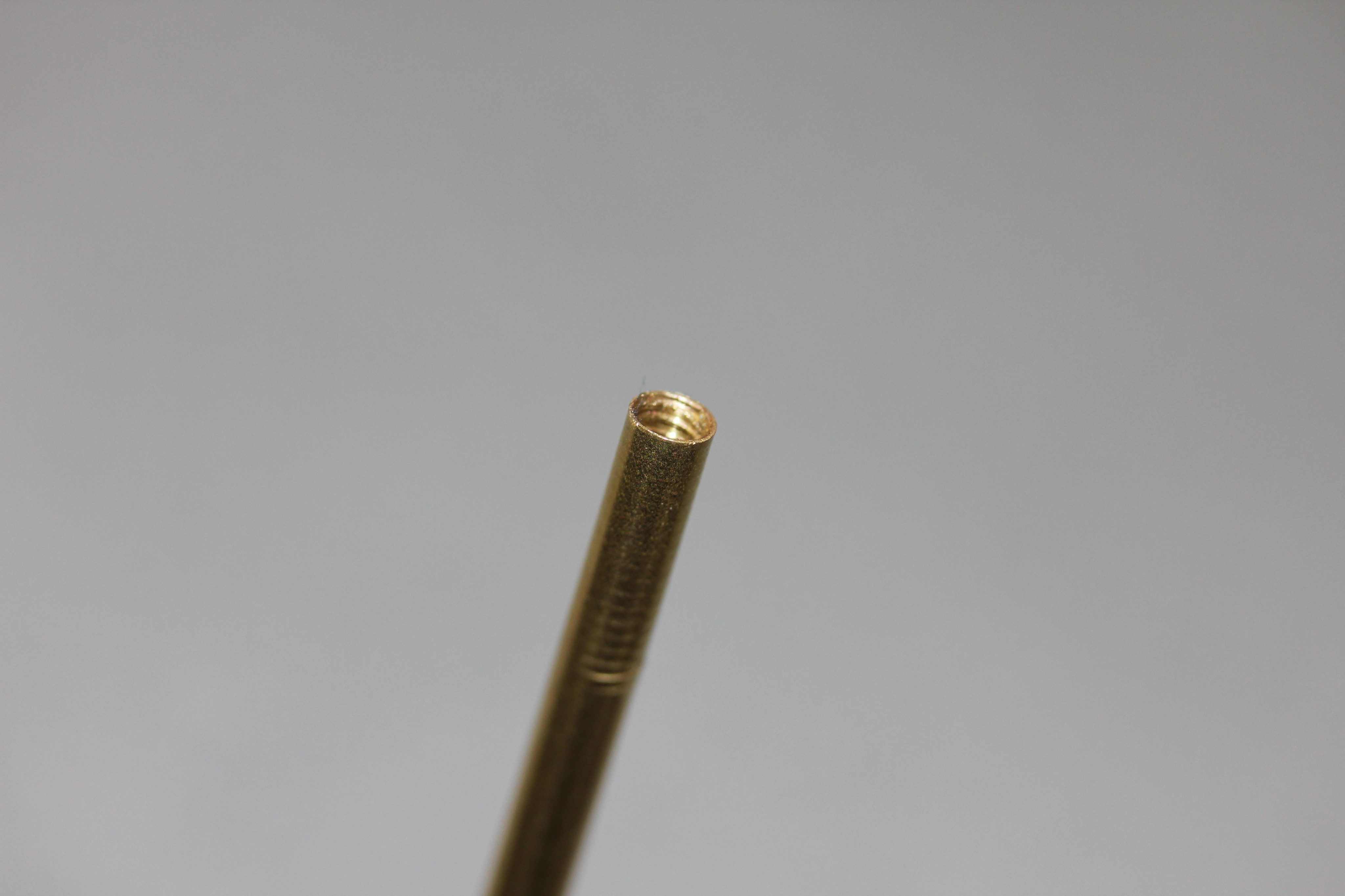

How do you get the sheath onto a metal tube? I'll tell you how I do it, but I'm sure there's a better way waiting to be discovered.
I got a length of 5/32" OD brass tubing from the hobby shop. First I burnished and rounded the end so that it would slide in a little easier. That sort of worked, but wasn't great -- the tube edges would still catch the nylon fibers and snag.
So I made a needle end. I got some 6awg wire at Lowe's. They sell it, uninsulated, by the foot, and I only needed 6 inches or so. 6awg is just slightly bigger than the 5/32" tubing. This is the wire that grounds your house's fuse box (if your house is wired to US electrical code).
I put the wire in a drill press and used a piece of sandpaper to make a blunt point on one end. On the other end, I turned it down (still using sandpaper on a drill press), then gave it threads using a handheld die.
The pointy bit.
The pointy bit.
Is this the vertical mill?  Why is the cutting tool made of paper?
If they think you're technical, go crude.
I tapped matching threads on the inside of the tube. Now I can screw the two pieces together and use the needle point to thread the paracord sheath onto the tube, then unscrew the needle, insert wires, and slide the sheath off. The threads inside the tube grab the wire insulation and hold it in place.
Someone with actual metalworking skill or even with actual metalworking tools could make a much better version of this tool.
