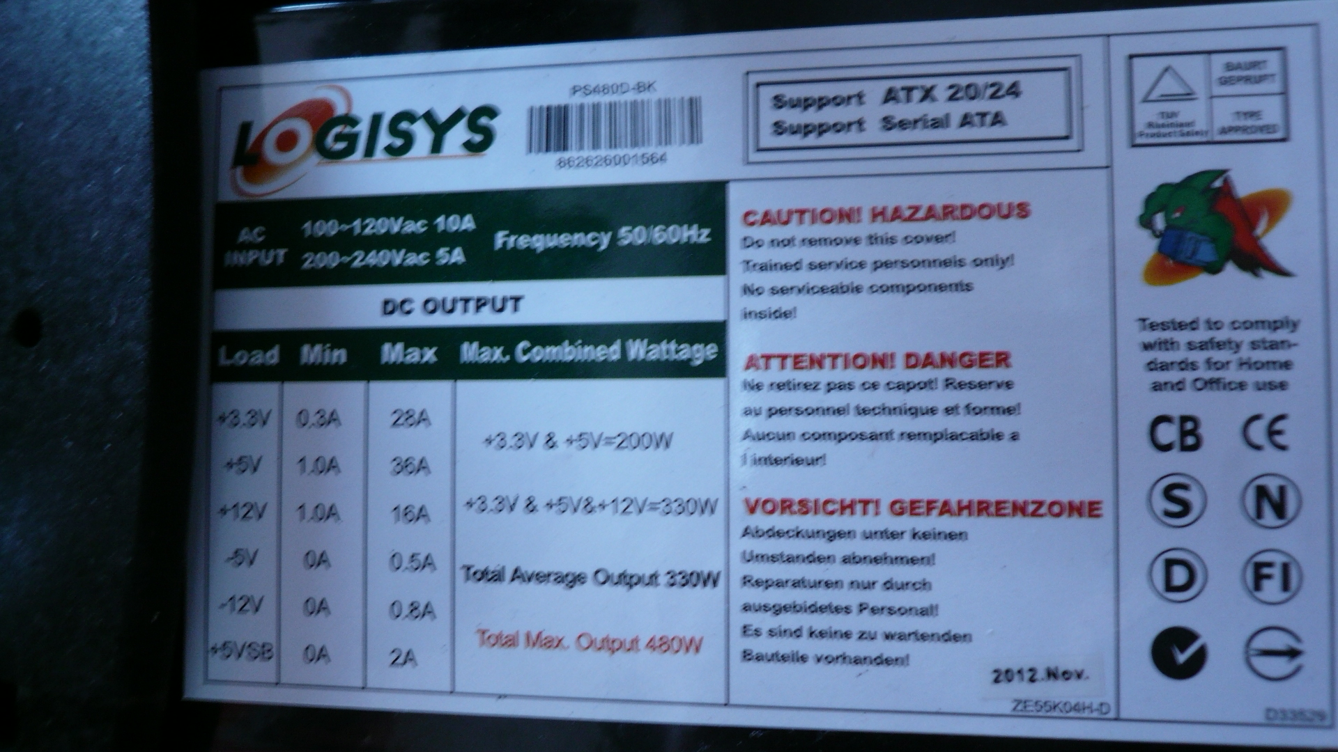

Post by analog_banana »
Good news - It is possible to remove the PSU without total disassembly.
Bad news... It may be a massively underpowered PSU?
330W Average
480W Max
Ho Hum...

Posts: 5367
Re: Onyx temperature loss - lack of power?
"480W Max" could mean "Yes, it did 480W for long enough to get a measurement and then it exploded."
At a _minimum_, I'd get a real 500W power supply. Something that's rated for 500W continuous. Try to avoid cheap power supplies if you can. I don't know if you can get them in the UK, but Thermaltake make excellent power supplies.
I noticed in an earlier post that you'd measured 10v at the RAMPS and 8v at the Onyx end, correct? That 2 volts is heating up the wires from the resistance of using too small a gauge. The Onyx bed wiring needs to be at least 14ga wire - this is one of the lessons I learned between the first and second editions of the manual. If you don't have any 14ga wire handy, just add an additional pair of 18ga to what you've got now. When you feel the wires to the Onyx, they should be the same (cold) as the wires going into the board power for the RAMPS.
Sagging power supplies SUCK! I've replaced the one in Orange Menace (the ratty thing lasted about two weeks) so I know exactly where you're coming from. You should get better heating out of the hot end as well once you've got more consistent power going to the resistors.
I emailed John at SeemeCNC and it turns out I have one of a "defective batch" of PSUs that shipped with the kits.
Makes me feel a bit better about my build skills.
He has kindly offered to replace it, but I'll most likely get one locally.
So anyone reading l if your supplied PSU matches the photo above it may well be one of the "defective batch"
and may need replacing.

Posts: 7185
analog_banana wrote:I emailed John at SeemeCNC and it turns out I have one of a "defective batch" of PSUs that shipped with the kits.
The one you have is also rated at 16 amps on the 12v rail, too small. And follow Gene's advice get a good supply with name recognition over the cheapest one you can find.

Absolutely no difference in power output detectable with a dummy load on the 5volt rail.
See photo below for the spec of my "good" - I hope - PSU..
