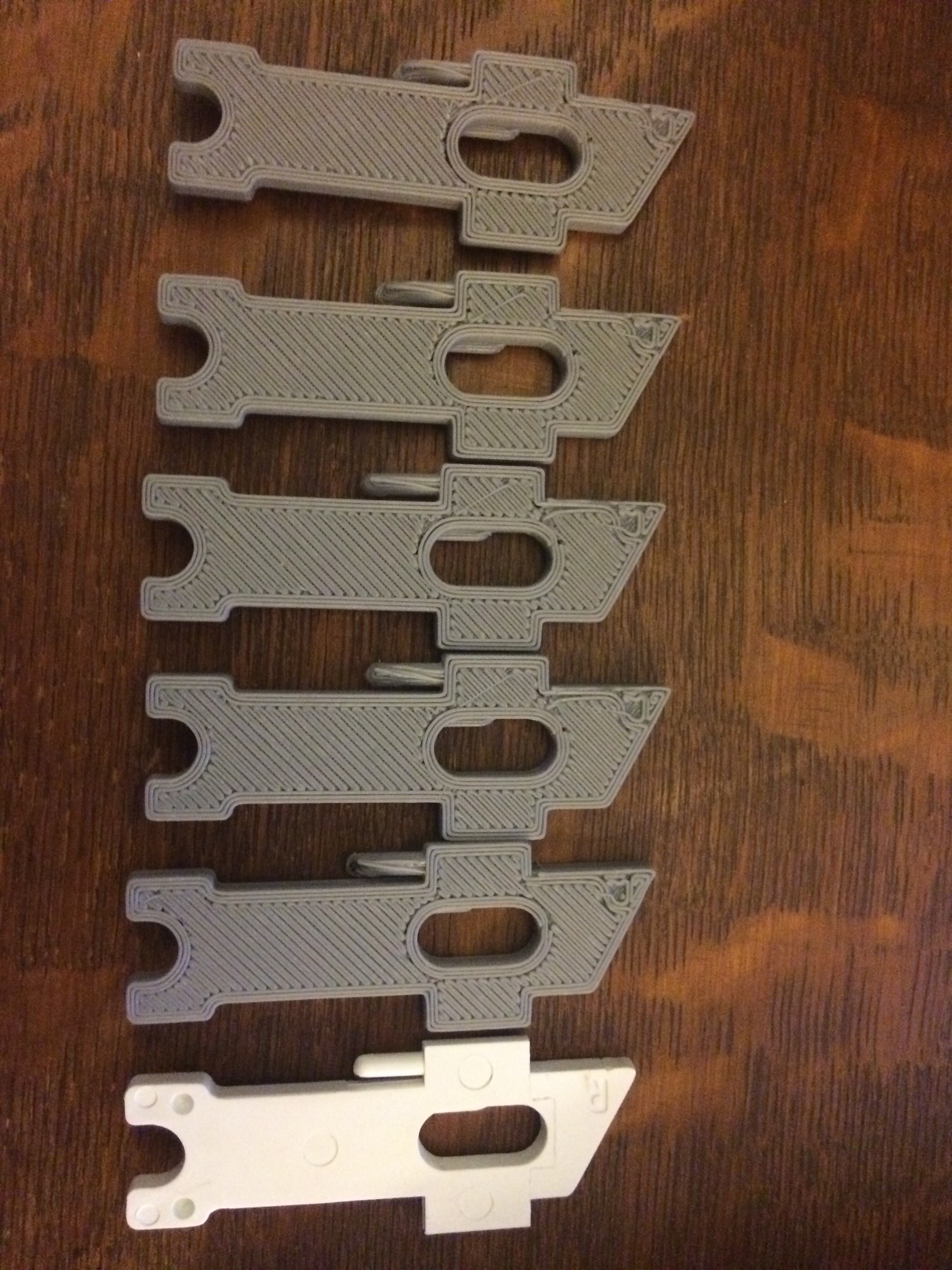

So my first print. I'll admit I did not collect the elmer's glue stick mentioned at the beginning of the guide because it did not mention I would be printing in ABS and I figured I'd start with printing PLA. Of course, there was no way I would have a completed 3D printer and not be printing something on it, so I did some research. Some people were having no problem printing directly on to Kapton tape and I had plenty of that. So I put some down and had my first go of printing the fan shroud. You can see in the attached images how that went. I then tried spraying some "extreme hold" hairspray on top of the Kapton tape and setup another print. This time I stopped it only a few seconds into the print because the ABS was visibly not sticking and even getting hung up on the hotend. Finally, I found some decade-old "Ross Stik Washable Glue Stick". It's consistency was more of rubber cement than glue stick, but I smeared that stuff all over the glass bed anyway. Lo and behold, I got my first print out. Stuck so well I had to remove the bed and use ice cubes to cool the plate til the print released.
It came out well enough to do it's job, but it definitely has its flaws that I wouldn't want to see in my future prints. I've provided plenty of images, I hope you guys will pick over them and maybe offer up suggestions to get rid of some of the flaws like the spaces in the walls, the unflat base, and the strangeness in the bridges and overhangs. Also, my printer dribbles a lot before printing. I sit there and pick the excess extrusions off just before the printer goes into action so its not dragging around extra plastic. Is there anyway of stopping this? My first goal is to enclose the work space. It doesn't need to be heated, I'd just like to protect the print from drafts and myself from the smell.

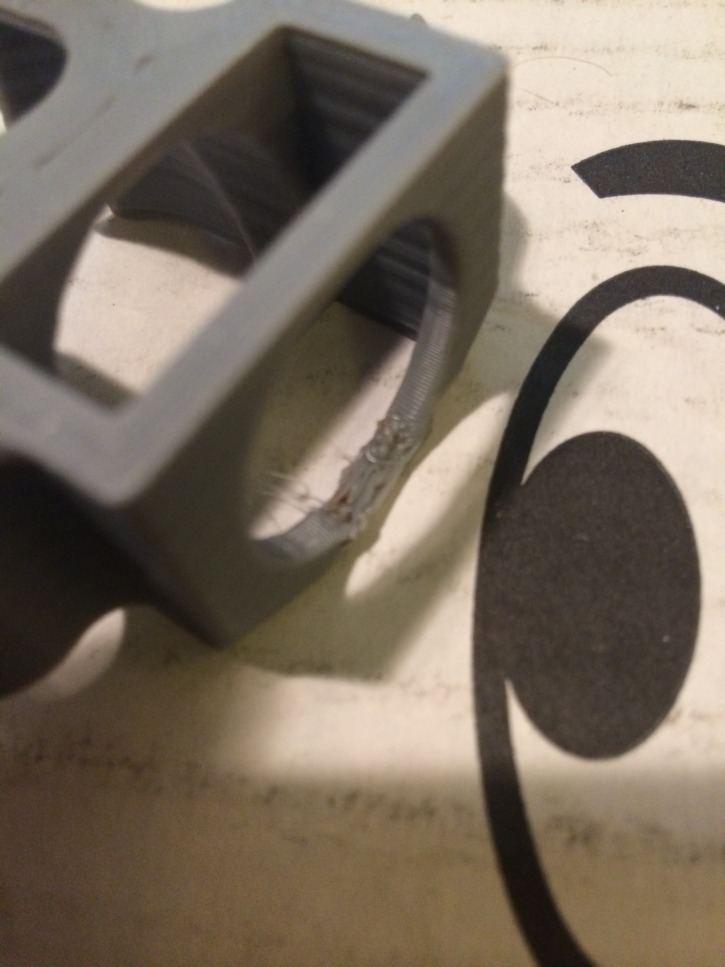

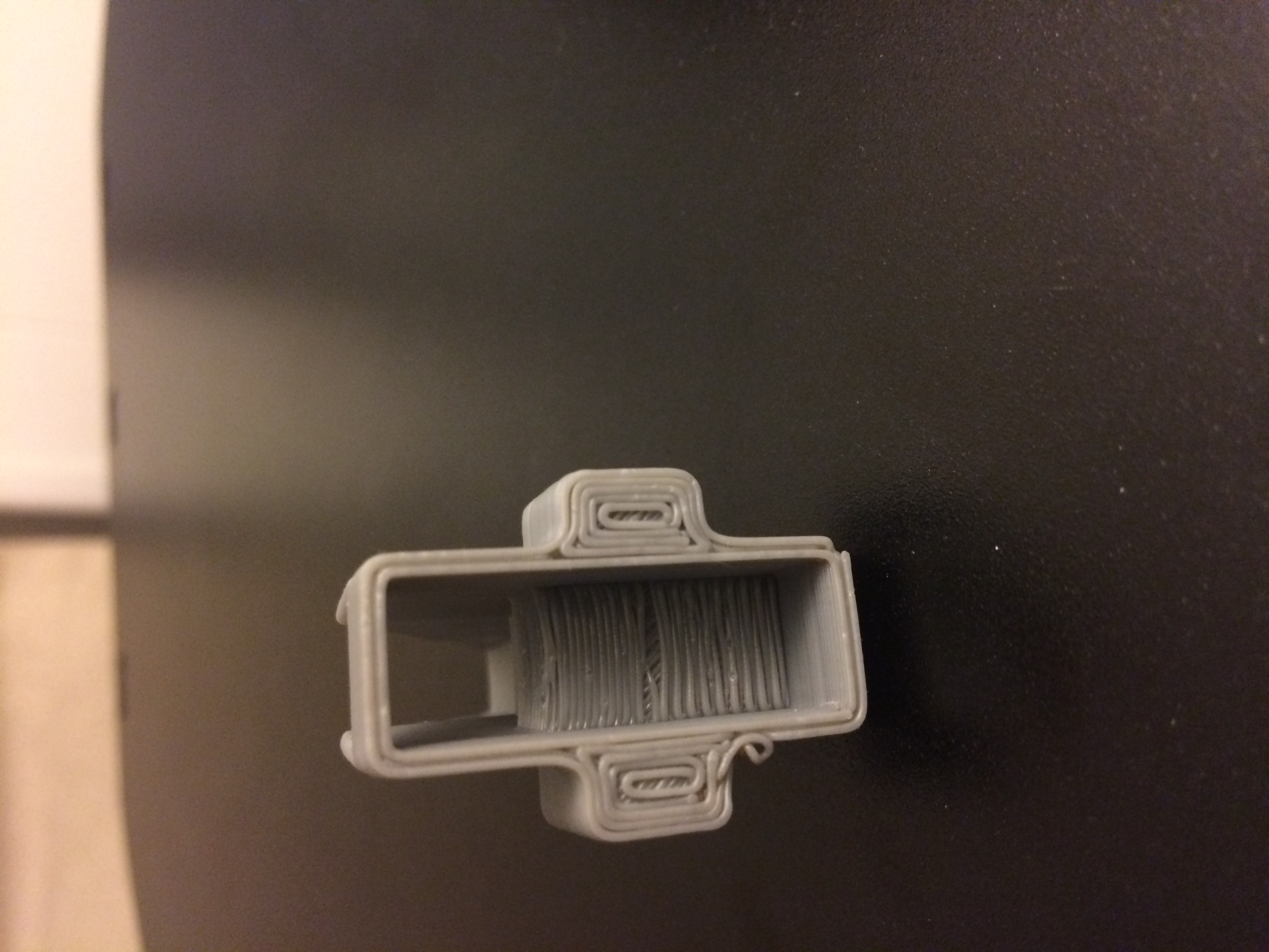

Your prints resemble my first prints - and I wouldn't consider myself an expert just yet, but I'd attribute what you saw to two things:
1. Slic3r sucks (hollow walls you saw, same with the base)
2. You didn't print with support (overhang and bridge slop)
In my experience any overhang up to 60 degrees prints awesome, but anything past that would require support.
Lastly to combat dribble I just pretty much just preheat the hotend, let it dribble out for a few minutes, then start the print with a generous skirt to get the filament flowing again.
Best of luck with the machine - and heed my ramblings at your own peril...

Play with your slicer settings until you know them inside and out, and try other slicing programs too. Everybody seems to find one that clicks for them. I'm a Cura guy.
Bridges and overhangs are tricky to get just right. Temperature may vary, sometimes cooling fans are needed, you can tweak slicer settings with speed and flow rate, etc... Support material is another option. I had the best luck with higher than usual temperatures and lots of cooling (which is temperamental with ABS).
Ooze will happen. ABS swells as it heats up, which is also why it likes to curl and avoid sticking. Ooze isn't a problem, it's normal. You can retract in your end GCode and add a little extrude to the start of new prints. Cura does this out of the box, and I use it.
Great looking first prints! Keep the updates coming.

Good News, everyone! My 3D printer has already saved me at least $100. All of the tilt tabs on our windows have been broken for years and we haven't bothered to replace them, but I have modeled them, even made them better, and now I can print them all out for orders of magnitude less! The pin doesn't come out perfect, but it still works for the most part. It's just a spring guide anyways. Probably needs to be printed with support material. I have it set to print overhangs at 10mm/s and I print these at 30% speed so I know it is printing it slow enough, ~3mm/s!
I still don't understand why that top layer can look solid, but the bottom layer has to look like stroodley. I know you guys said that was the result of the Slicer, but if it can do it on top why not the bottom?

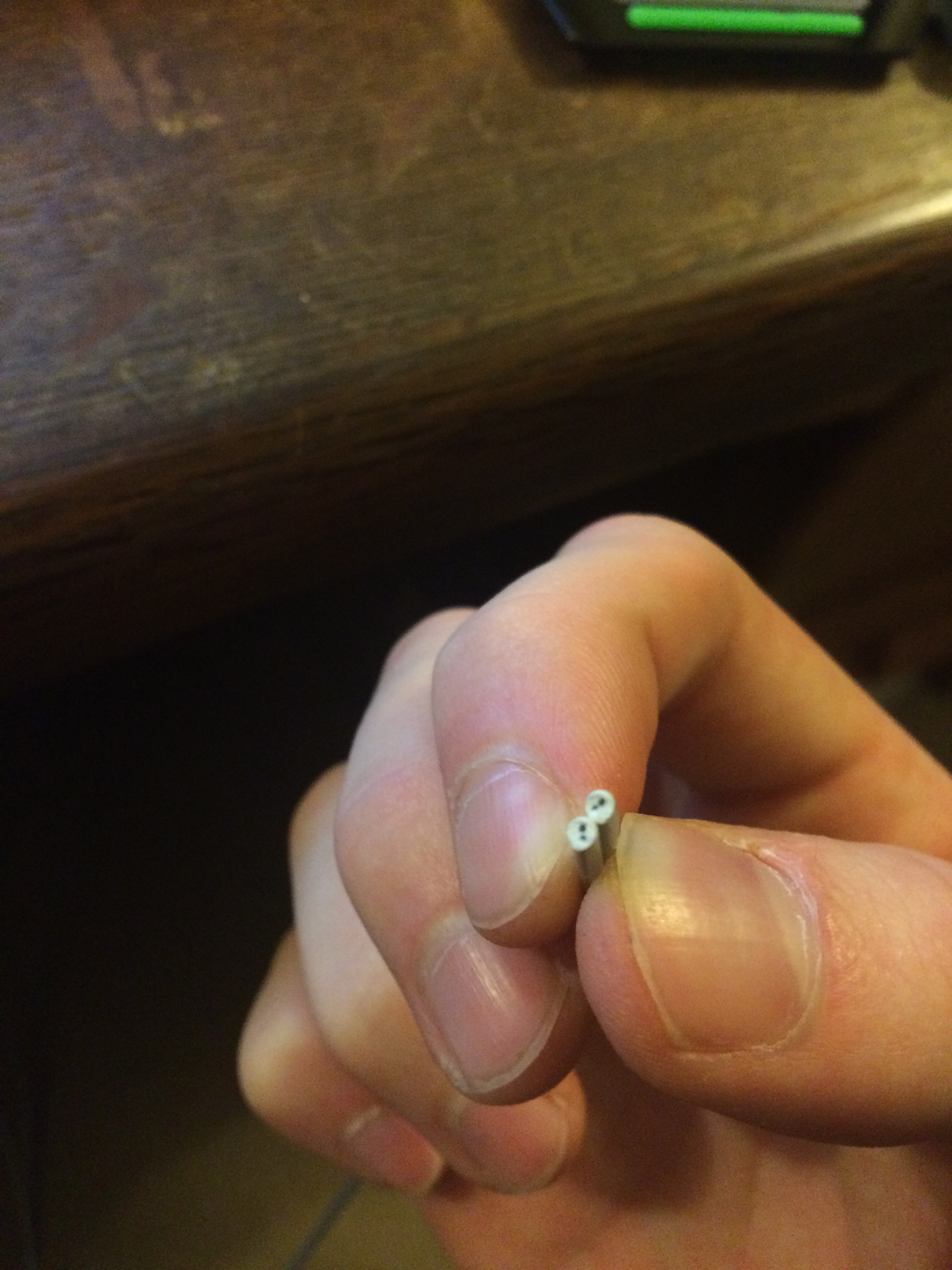

ATTENTION: This is the important part of this post. The ABS filament I am printing with is from Monoprice. If you recall, I didn't have any ABS for my fan shrouds at the end of my build, so I got Monoprice filament because it was cheap, seemecnc didn't have any gray filament in stock, and the reviews didn't look that bad. Also, I was being impatient and wanted to overnight it. Because I don't have experience with any other filament, I can make no observations about print quality. Just today though, I was messing with the tid bit I cut off for dia. measurements and I broke a piece off an noticed there were cavities in it. Bubbles or tunnels, it's hard to say, but I imagine that's not desirable because it would change how much is being extruded per given mm. Take a look and tell me what you think:

For that filament - I would be very suspicious of that. I've gone through some rolls from a couple different suppliers now and when I break off a piece, it's always been solid through to the core. That might be why you're getting "stroodly" (?) first layers - if the printer isn't actually feeding as much material as it thinks it is, and you're starving the first layer, that would be a likely culprit. Not sure why that wouldn't carry over to the other layers also, though...

I figured as much. I have spoken with Monoprice and they are setting up my RMA. Not only the bubbles, but I know this stuff isn't 100% ABS. It does not dissolve in Acetone as ABS would. I am going to take some of my failure pieces and run some Determination of Composition tests.
I see SeeMeCNC has gray back in stock, so I will be getting it from there to replace it.

As for the bottom layer I found that I got results like that when my E-Steps was out. Calibrating that helped a load of other problems too. There's a pretty good video on YouTube for it (Using the RMax) https://www.youtube.com/watch?v=XbX5Ilmc8m0
Hope this helps!
