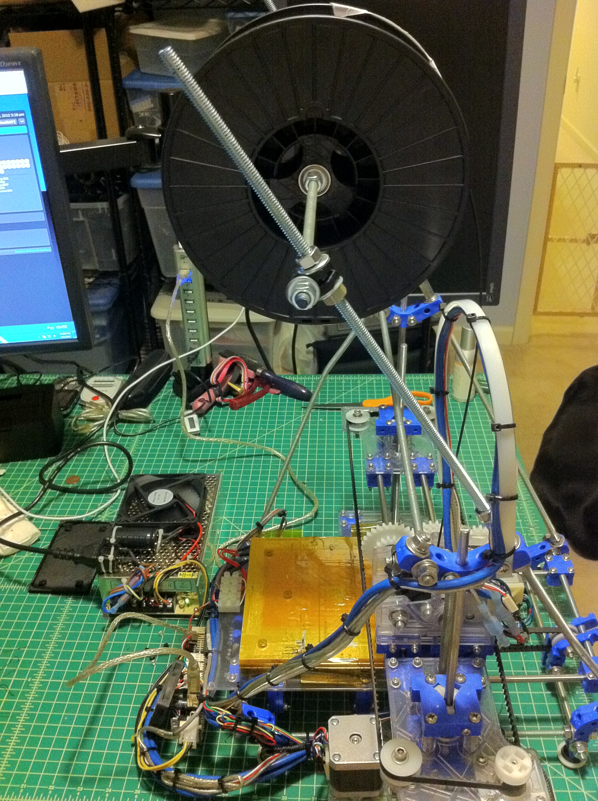

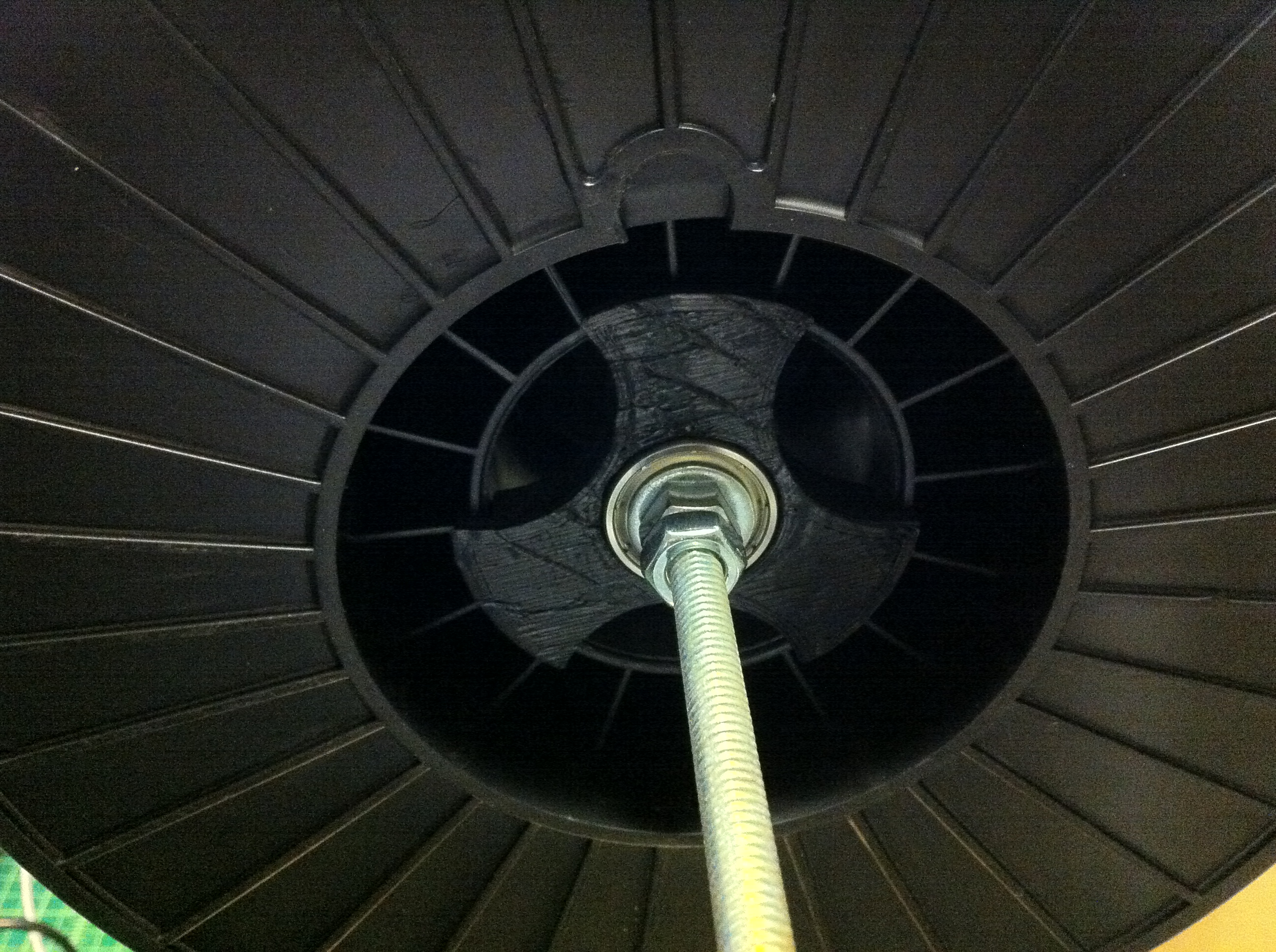

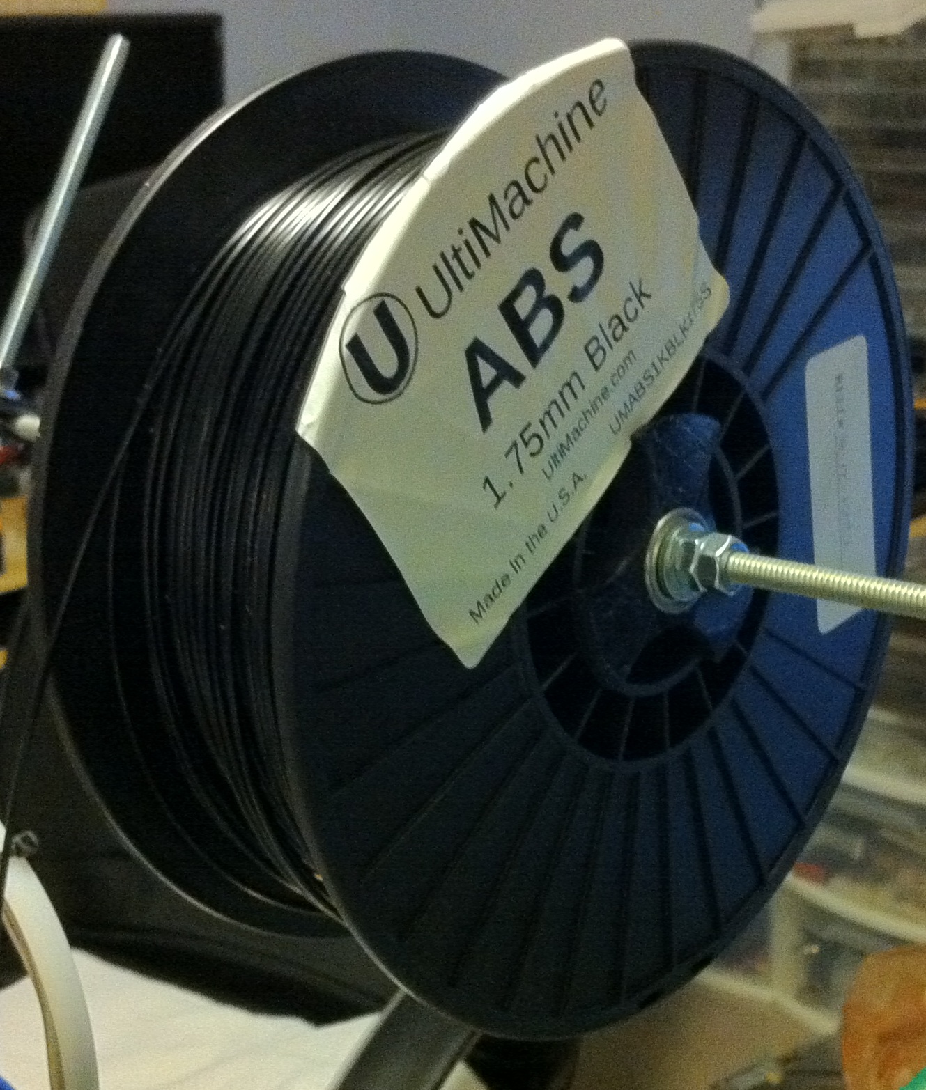

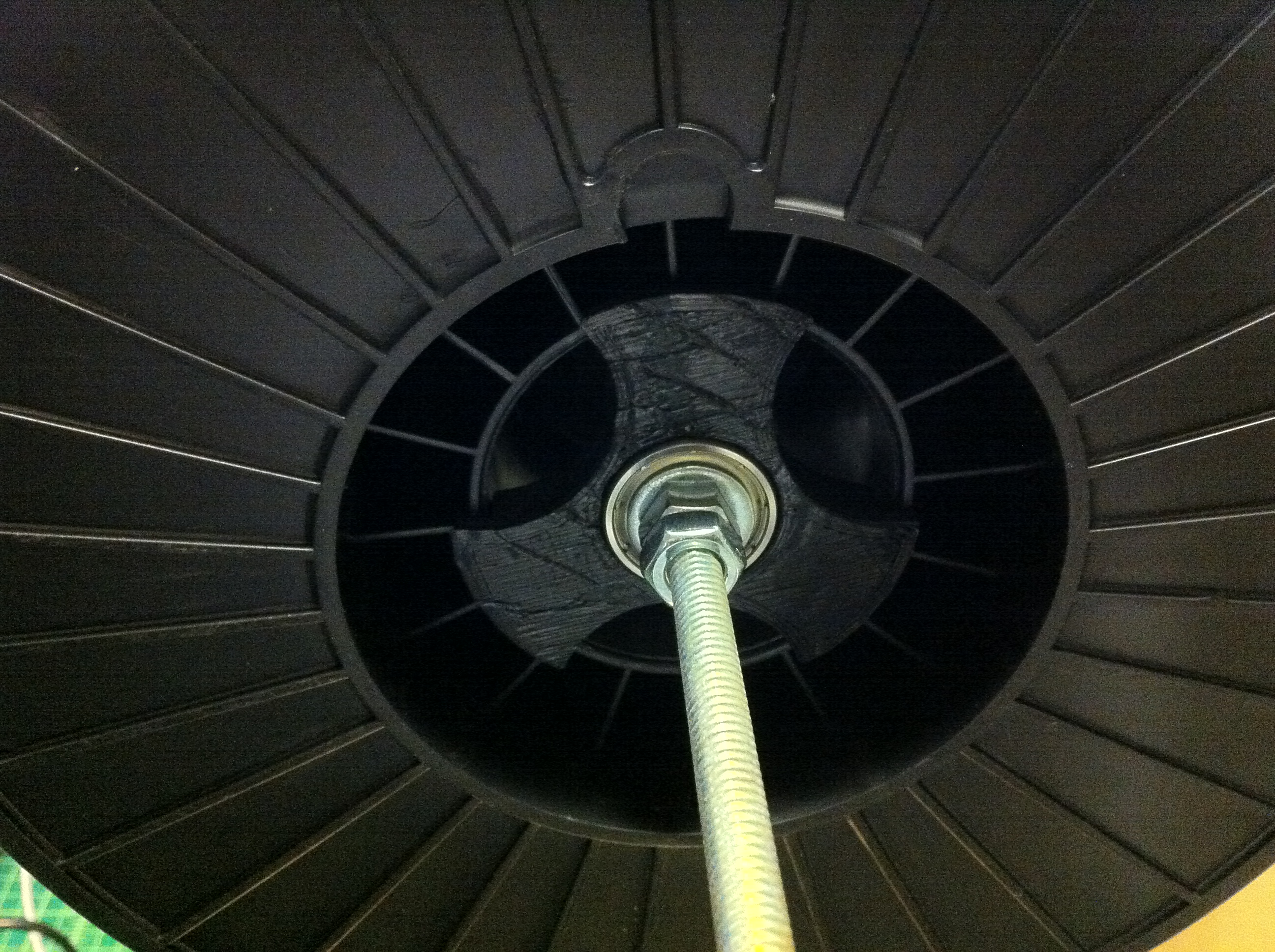

I finally got tired of the old PVC pipe holder for the filament spool. The PVC pipe caused too much friction and was always in the way/taking up too much room.

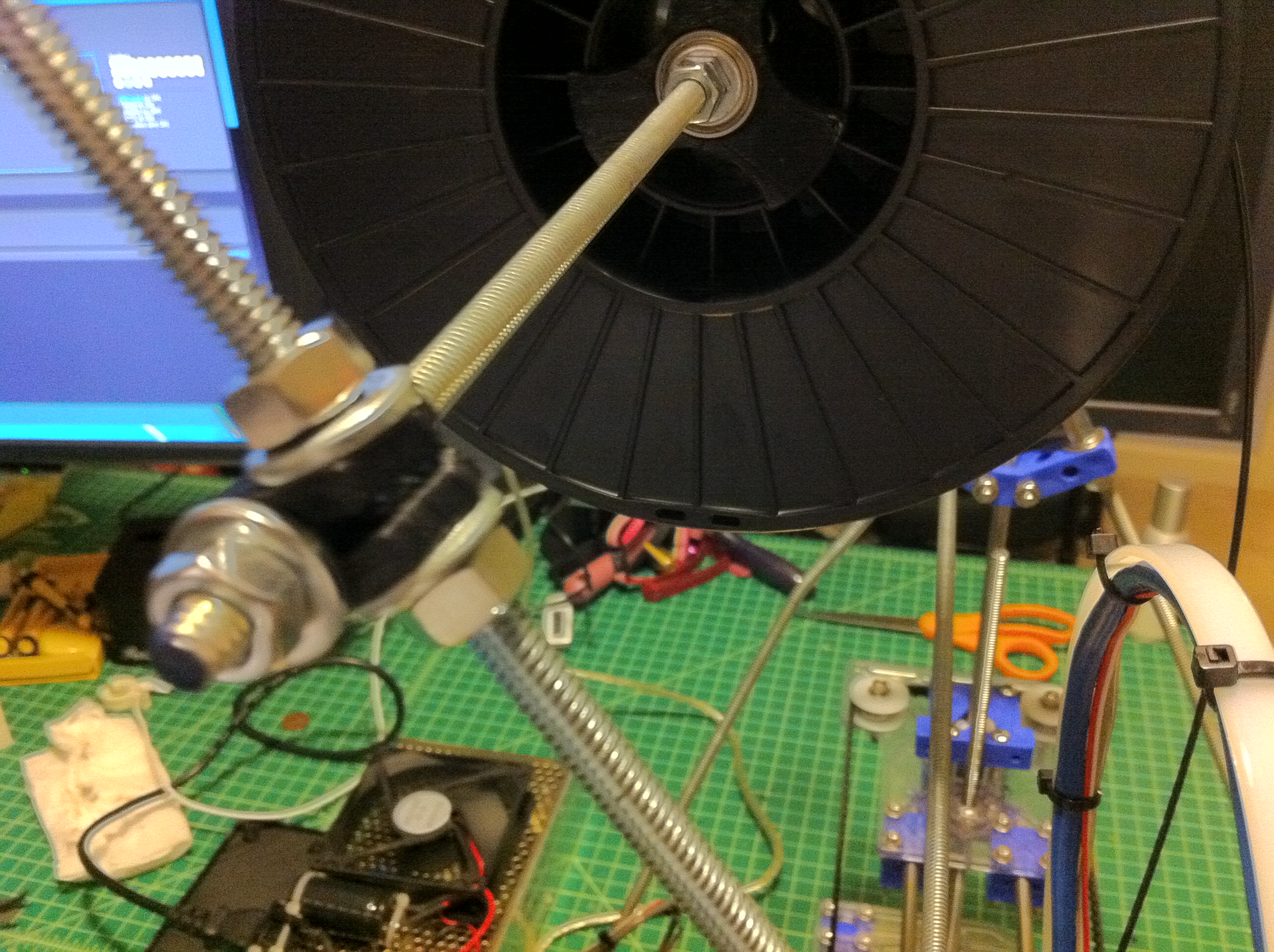

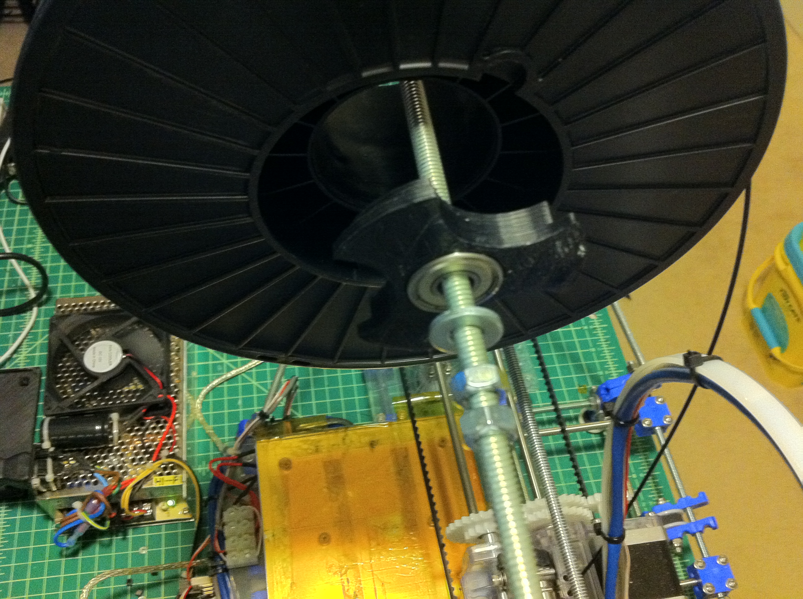

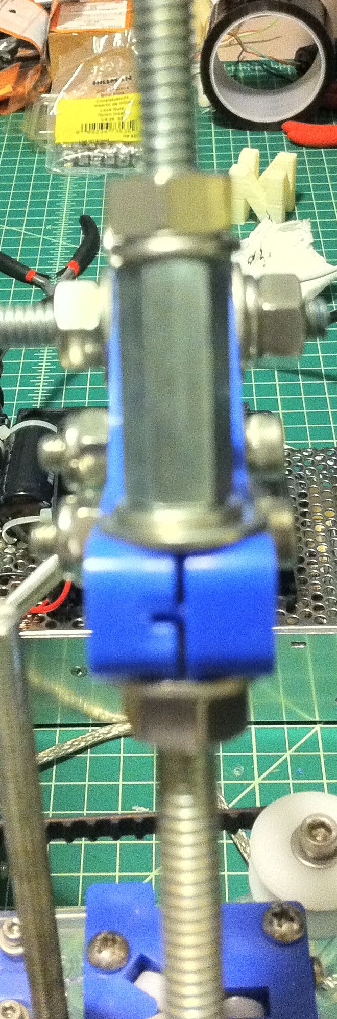

In the pictures attached I printed out four parts (two of each) and added extra threaded rod/nuts and in no time I had a great setup to hold the filament ON the H-1.
This setup gave me more room on my desktop and since it used 608 bearings the filament spool glided freely!
This is modeled after others doing the same with their huxley/makerbots.
The threaded rod/nuts are all 1/4-20 hardware found at your LHS.
Here are the items I needed to print:
2x Filament spool holder/spacer (uses 608 bearing). This one is different then the one I printer previously, this fits the 2Kg filament spool sold by Ultimachine.
http://www.thingiverse.com/thing:14361
2x Bar clamps to hold 1/4-20 threaded rod together (see pictures for details).
http://www.thingiverse.com/thing:18637

I like it but doesn't it torque the frame?

Chris Muncy wrote:I like it but doesn't it torque the frame?
I was worried about that at first, but with the lighter filament spool (2Kg) and cross bar attached to both Z axis, most of the weight is distributed evenly.
It actually seems to act like a dampener, helping remove the wobble when X or Y change direction quickly.

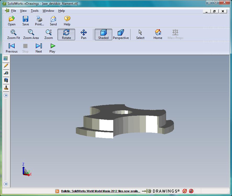

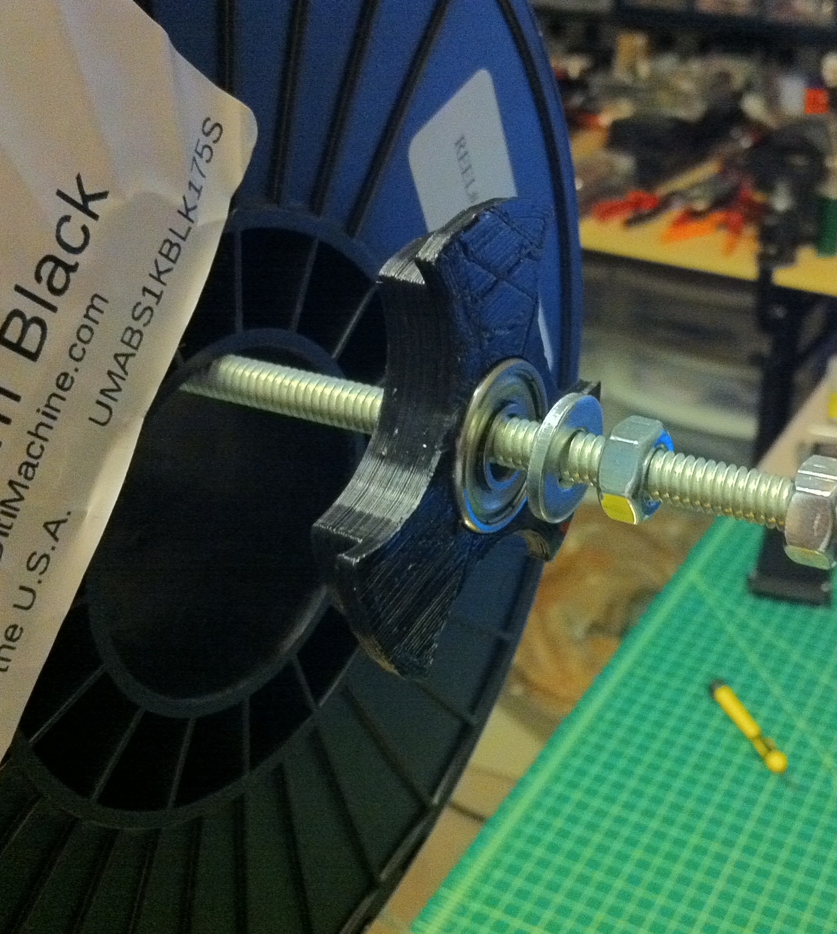

Post by cquinby »

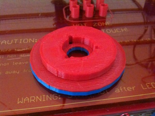

Got my bearings and put my stuff together!!!

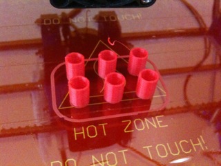

First off, i made some spacers (bushings) to go between the 1/4-20 all thread and the 608 bearings. You need to print these slow with 1 perimeter and multiple at a time. Also I had to use the Z Lift function to keep from nocking the parts off the table. This actually worked very well... Print in ABS. You will have to almost thread them onto the 1/4-20 rod. I have attached my Slic3r profile for these parts, change the txt extension to ini then load into Slic3r.
.3layer Small Multiple parts .txt
(1.44 KiB) Downloaded 232 times
Here is the spool adapter printed out (ran out of blue ready to go but had red hanging on the wall!)

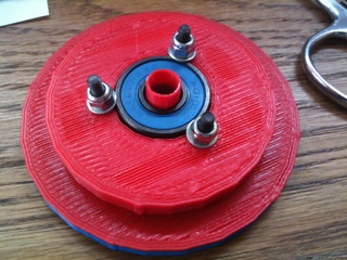

Next was to put the bearings into their home... Ya, I got blue shielded bearings.
Next we use some 3mm screws, lock nuts and washers to set the bearings into the pockets.
Finally, put together and enought room for 2 more spools if I want!
Printing two more adapters right now to see how well this works. Little worried about the weight on top as the machine doesn't seem quite as stable but watching it work right now it seems to be OK.
Crap, almost forgot to pos the bushing STL...
v3 608 bearing 8mm to .250 bushing.stl.stl
(107.26 KiB) Downloaded 221 times

Post by michaellatif »
BTW, I change from a 1/4" threaded rod through the spool to a 5/16" rod. The 1/4" was bowing a bit and I didn't like how flimsy it felt.
I got a 5/16" rod from my LHS and cut it to 16" length, ran it through the bearings and holders. So far so good.
