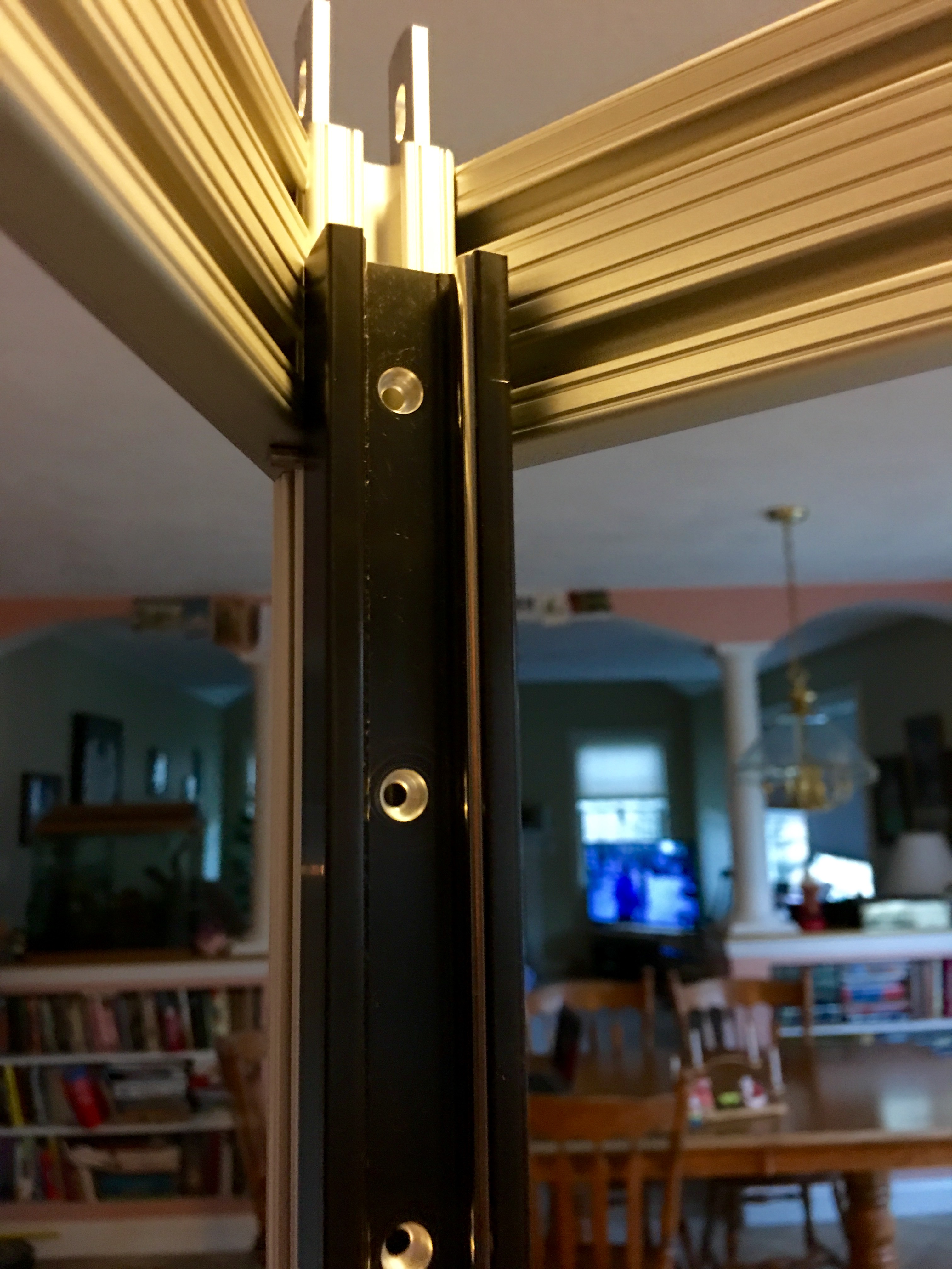

I started assembling the frame - dry run - so I can figure out the linear guide install. Since they sit further out from the uprights, I'll likely have to add additional idlers to position the belt properly so it is parallel to movement. I did run into one gotcha - I ordered 700mm rails thinking I would cut them to fit. I did not realize that they have steel rails inside the channel. I need to call the manufacturer to see how best to cut them as they interfere with the cross pieces now - as shown below.
.9° stepper on AstroSyn damper test fit
Speed Demon linear rail - just a bit too long. The holes are M3. I have some M4 threaded quick insert T-Nuts that would work perfectly on this uprights that I'd like to use. I only have button head M4 screws and they are too large for the countersink. Mot sure about regular M4 cap screws. I need to order some and see. I might have to bore and counterbore the mounting holes. But the rails themselves are a good match to the 1" 80/20 uprights.
Where the rail extend up past the bottom of the cross pieces it won't sit flush to the upright since it is a little wider than 1". So I do need to figure out how to cut the rails to size.

how do you plan to mount them without interfering with the belt path?
Posts: 5412
Re: Trick Laser MAX METAL with Linear Rails
Like I said, I will likely have to add additional idlers to move the belt towards the center of the machine and to clear the linear rail. Not sure if the V2s have this but the original V1 has 2 idlers at the stepper that position the belt proper in the track. The other option would be to do a Kossel like stepper mount and belt but I'd rather avoid that.

Ok, I have the belt path issues all sorted out. I made new idler mounts for the top and a special one for the bottom.
First, here is the belt mount to the top of the block. I am making a belt tensioner for the bottom side.
Top now has 2 sets of bearings to offset the belt properly.
A better view of the belt path.
This is the bottom mount to offset the belt. There is not a lot of room to work but this works. There will be two M3 screws holding the bucket onto the rail. As you can see on the back side of the mount laying on the cross rail their is a recess milled into the mount to help align and brace it. The bearings are perfectly centered and there is absolutely no flex in the mount.
I am going to have to open the width of the slot a little bit so the bearings clear. I don't want to take the entire frame apart for this so I'll probably use my Foredom with a small grinding bit to remove the aluminum.

Metric specs for dimensions. The rails I got are just a smudge wider than the 1" extrusions for the uprights. Now that I have my frame together, I can measure the actual length for folks to order. I got mine too long and had to bevel the edges a few inches to get them to fit.
