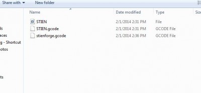

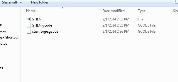

Re: How to print from the SD card
I've had the printer for a long time now and never knew the dial was a button as well. Never had to print with the sd card, never tried. I navigated to sd card and hit print. The LCD displayed all three of my different named prints. Thank you.
Anyone have a link how to do this. Exporting G-code from slic3r onto an sd card and inserting that card into the rostock, the LCD says SD card inserted..yea. I've looked in the Rostock documentation section and didn't find anything. I looked in the Rostock pdf manual, nothing there. A link or ...
