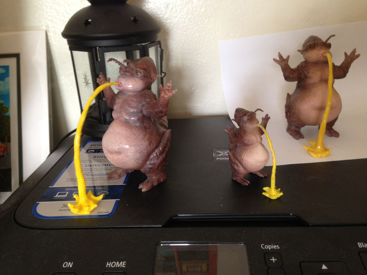

Spewy!
From Chris Elliot's show Get A Life several years back. Funny Show.
This was Spewy, a disgusting little alien Chris finds.
Thought he'd be fun to print. Was right.
Printed on the Orion Delta. ABS. Painted with light washes of acrylic.

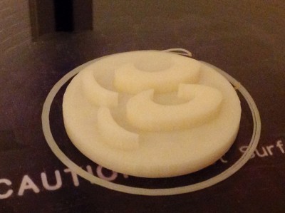

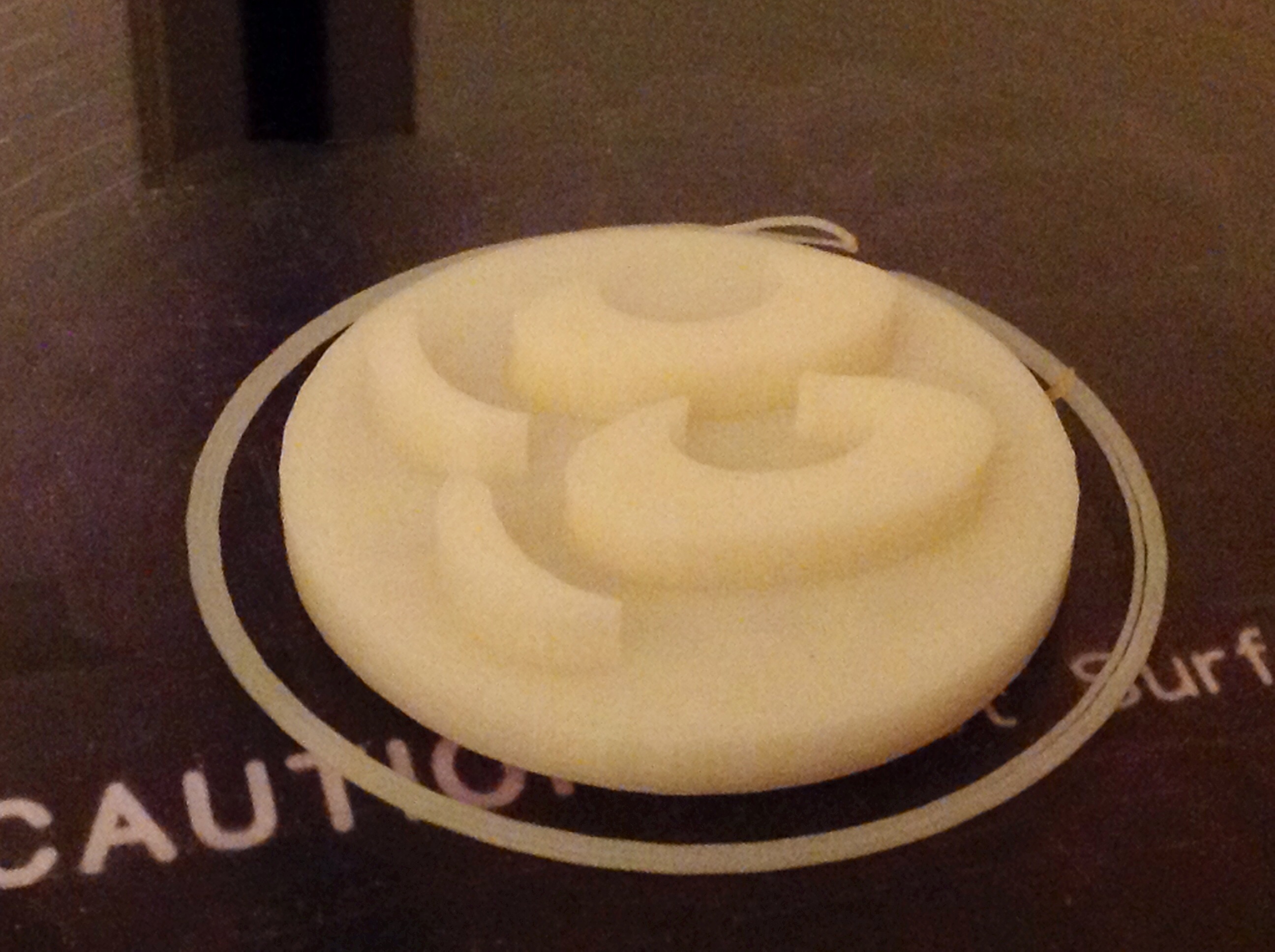

Hello from Los Angeles
Just received my Orion Delta. Unboxing and setup was very straightforward. First print (blinky) was PERFECT!
Thank you to everyone at SeeMe for building such an amazing machine.
