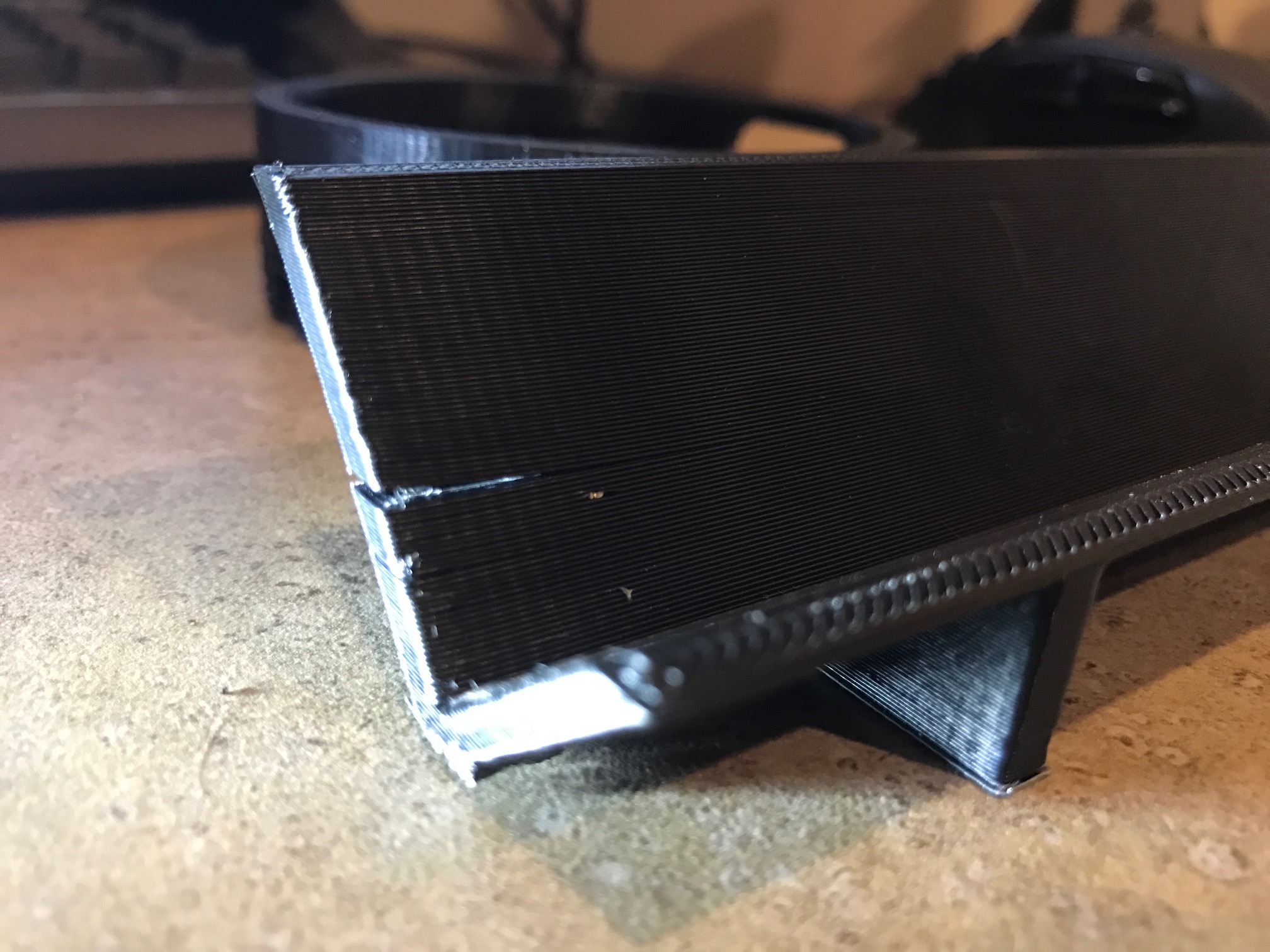

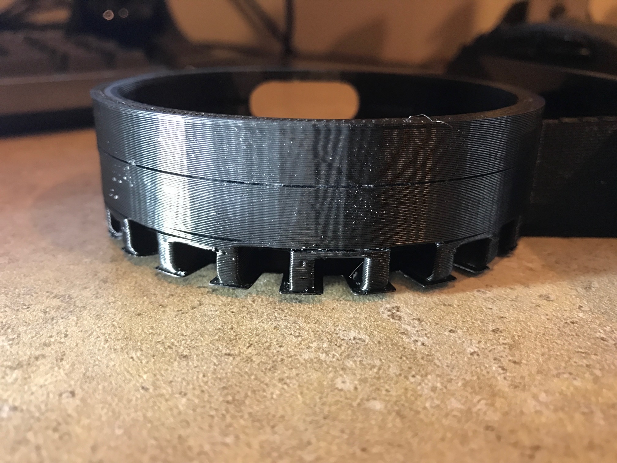

Oh. well thats easy to change. I think there was a previous post that caused me to reduce the temp to 215. You have to be a 'tweeker' with this hobby dont you?
- Sat Dec 10, 2016 7:50 pm
- Forum: Troubleshooting
- Topic: ABS splitting by unknown force
- Replies: 7
Re: ABS splitting by unknown force
Thank you. I'll have to bone up on the quickest most cost effective enclosure system to implement.
- Sat Dec 10, 2016 5:05 pm
- Replies: 7
Print #2 went much better. But still split in a couple of places.
My house temp in that room is 74 degrees. Is this just a cooling issue that an enclosure might fix? I dont print many long prints like this (7hrs)
I have this model where I combined This model and a custom speaker shelf. I've tried to print this twice now and the model splits at the lower portion of the circle, right where all of those air channels are. I understand that is the 'weak area', but I fail to understand what is pulling UP on the ...
