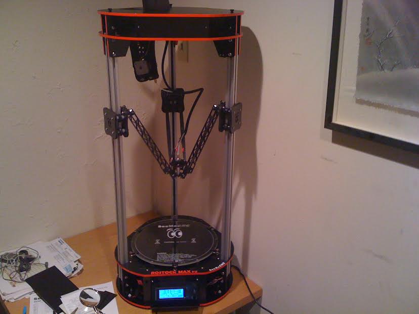

Re: Polly's Rostock MAX build
I built the v2 so I thought the arms would be fine. I did notice the clips were very tight and pushed the u-joints against the platform. I also noticed a couple of the arms were a little melted looking on the ends. I'll fiddle with them...I also adjusted the extruder feed rate, so maybe I messed ...
Got it all calibrated. Went ok, but I had to wait an extra 24hrs because I pulled the thermister out of the hot end while I was trying to crimp on the quick release connectors. Had to re-glue the thermister and let the sticky brown stuff cure. One tip: crimp and solder the wires before assembling ...
Thanks, Eaglezsoar. I'll just trim off the flashing before I finish building the cheapskates so it doesn't wear of later and possibly gum things up. :) So far, things have gone pretty well and I've been impressed with the kit, the directions and this forum. One of the reasons I bought this kit was ...
The build is coming along nicely. I sanded off all the crappy paint and started over. It's looking really nice now!! IMG_0458.JPG One question: in putting the sleeves on the cheapskate bearings, almost all of the sleeves have small pieces of the top/narrow edge coming off. I believe this is called ...
