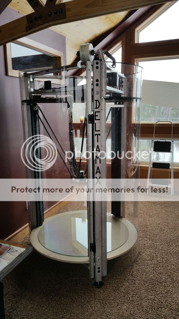

I didn't measure with jog actually. The printer is at work. I'll try that in the morning. Let's say for now that it moves 5mm in your example, what's on your mind?
http://i939.photobucket.com/albums/ad23 ... 69c363.jpg

It's a modified Rostock Max. The firmware is stock, other than It's been modified to use a GLCD instead of the standard LCD. I don't have any pics as of yet. Just some things I've tried... I've moved the head to Z100 from 0,0,0 and then used M114 to get the position, which was the same, but when I ...
