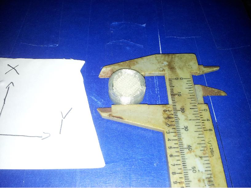

Re: Calibration of infills
Ok, the print just finished,. I reduced the infill speed from 60mm/s to 45mm/s, and its a little bit better, but the infill still doesn't touch the perimeters in all places. I have uploaded a video I took while the print was busy with an infill layer. Hopefully that will help as well to identify the ...
Its not 100% round, but its pretty close. If I secure the calipers on 20mm and try to rotate the object inside, it moves freely. Im going to turn down the infill speed and see what happens. Thanks
ok, I just printed a circular object. I watched closely while it printed and it seems the extruder head is not moving all the way to the side when it is printing the infill. What is strange though is that the very first layer is perfect.
Oh, I forgot to mention. My slicer settings are as follows
I have been calibrating my h1 for the last few days, and the layer height finally seems correct. I started with the infill calibration but something is weird. The infill is not touching the perimeters of the object. I changed my Extruder multiplier to 1.1, but it didn't fix the issue. My prints ...
