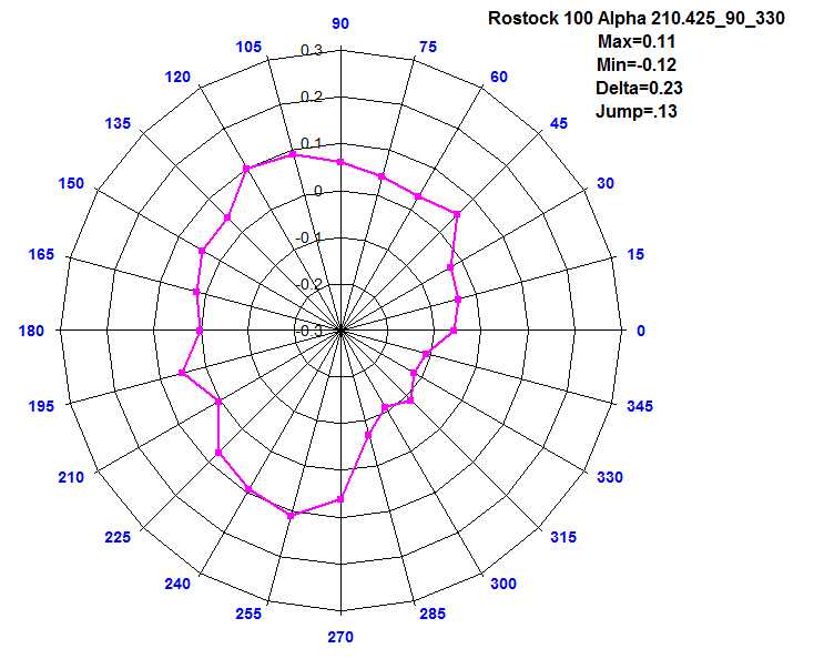

Re: Best Tower Rotation Setting Yet
dc42- Tried your calibration calculator. Nozzle height/leveling problems are gone! Never printed as good as it is printing now. I ran your calculator several times and each time made the suggested corrections. Since my dial indicator tilts the effector, I can't use it to make absolute adjustments ...
- Tue Aug 02, 2016 7:57 pm
- Forum: Troubleshooting
- Topic: Best Tower Rotation Setting Yet
- Replies: 7
dc42- Thanks for your post. I have not tried, but I certainly will.

- Tue Jul 26, 2016 3:08 pm
- Replies: 7
Tried some additional tower rotations [Alpha A(210)] today centering around the previous best Alpha A of 210.4
The new champion on my machine is 210.425.
See the attached.
See the attached.
