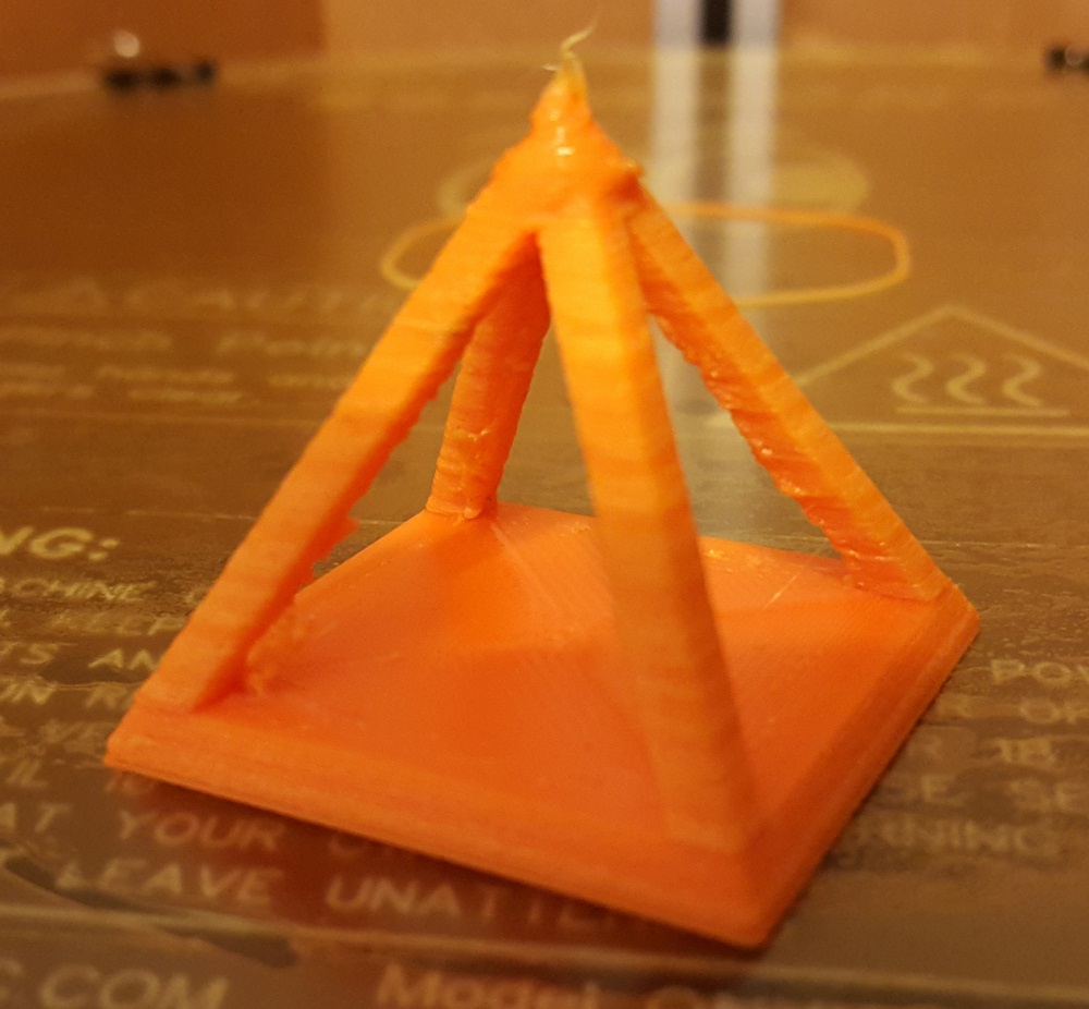

Here is the second attempt at the hollow pyramid. I reduced the retraction speed from the default 100mm/s to 40mm/s and kept the retraction length at 4mm. After the pyramid base was done, I turned on the fan at 30%. Still need some tweaking at the top which is still a glob of filament. first_layer ...

The rest of the part looks like it's too hot - see the Hershey Kiss effect at the very top - that's melting. I'm guessing you don't have a part cooling fan since you are printing the shroud for one! Take this one, make it fit quickly and then print a "keeper" with fan cooling on. The quality of the ...

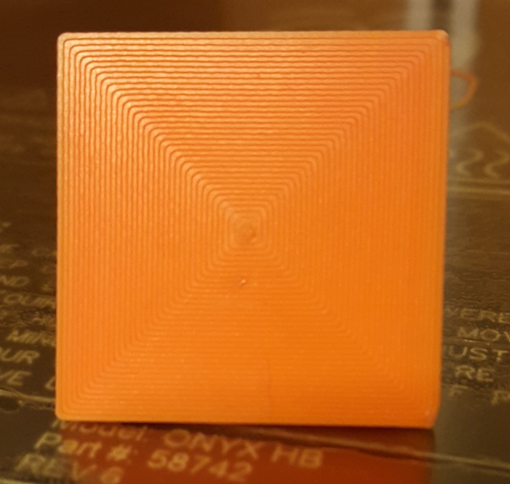

I think I've solved the first layer / second layer issues. I was able to print a few test objects last night. Thanks for everyone's help!
First layer of hollow pyramid. Hollow pyramid Another layer fan shroud in orange.

I was able to recalibrate the Z height and I was 0.80 mm too high. At 0.90mm the nozzle pinned the paper to the bed, 0.85mm the nozzle had a lot of friction between the bed and paper. At 0.80mm the paper moved with a small amount of friction. The first layer is looking very good now. The image ...
