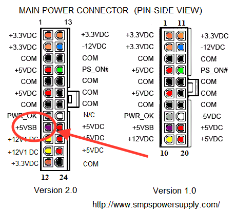

- Sun Jan 17, 2016 4:18 pm
- Forum: Rostock MAX v2
- Topic: Powering Raspberry Pi 2 with existing modular Power supply?
- Replies: 5
Re: Powering Raspberry Pi 2 with existing modular Power supp
The PSU has a constant +5VSB, if you combine this with a common black you will get constant power on, even when you turn the printer off. Just splice it into a mini USB cable.
Thats how I have it on my printer.
