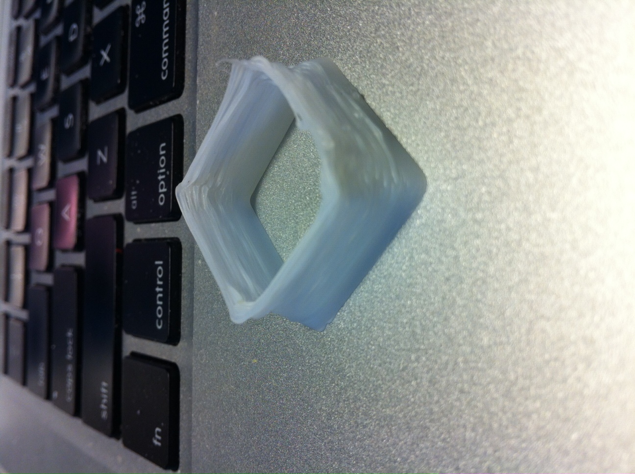

Re: 3 months in and still bad prints
photo (5).JPG World of difference... of course it's super slow.. ;) My trusty, but cheap, calipers measure the wall at 0.6mm thick and 22mm square, 9.7 tall Very fine, tight lines. There is a little back and forth movement at the layer change that's visible. There is bowing in from the first layers ...
So this one was .2mm at 45mm/s with .55mm width.
The first 8 or so layers are clean and tight, though they seem to get smaller / constrict. as they rise.

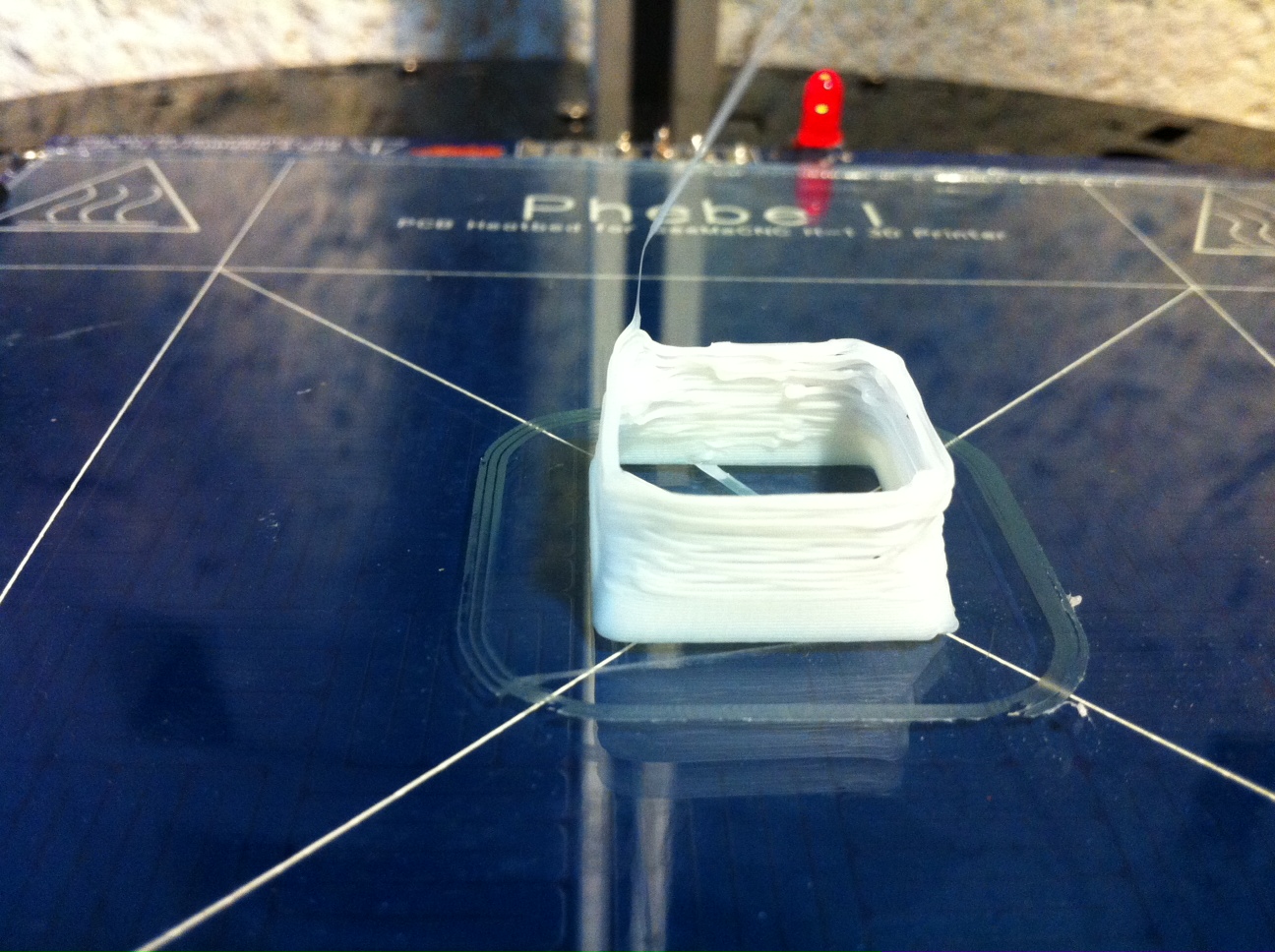

photo (2).JPG I feel like I'm running around in circles trying to get the calibration right on the Max. I'm using Repetier-Host 0.84 with slicer 0.9.8 and PolygonHell's repetier firmware. The single wall test (no retraction) seems to start out well then goes off. More substantial prints like the ...
