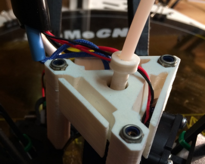

This is a pic of how i have mounted mine and without that bowden extension these is no way you can get your fingers in.

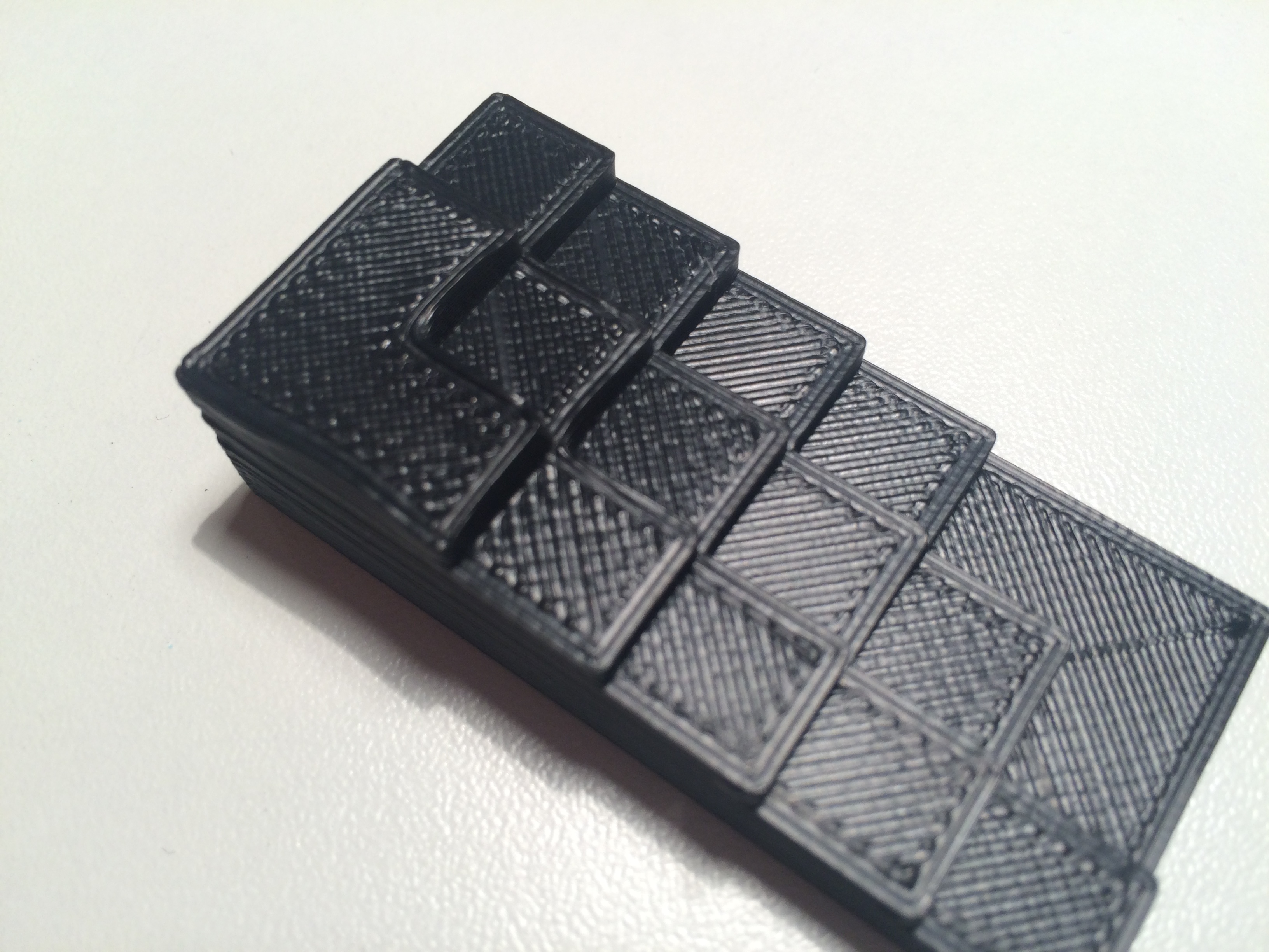

Yes just like your first pictures shows, small gaps between the infill lines. It's interesting because the infill gaps look like it's under extruding, but the top layers and corners look like over extrusion. What size nozzle are you using? What slicer? Those top layers should be smooth. Thanks for ...

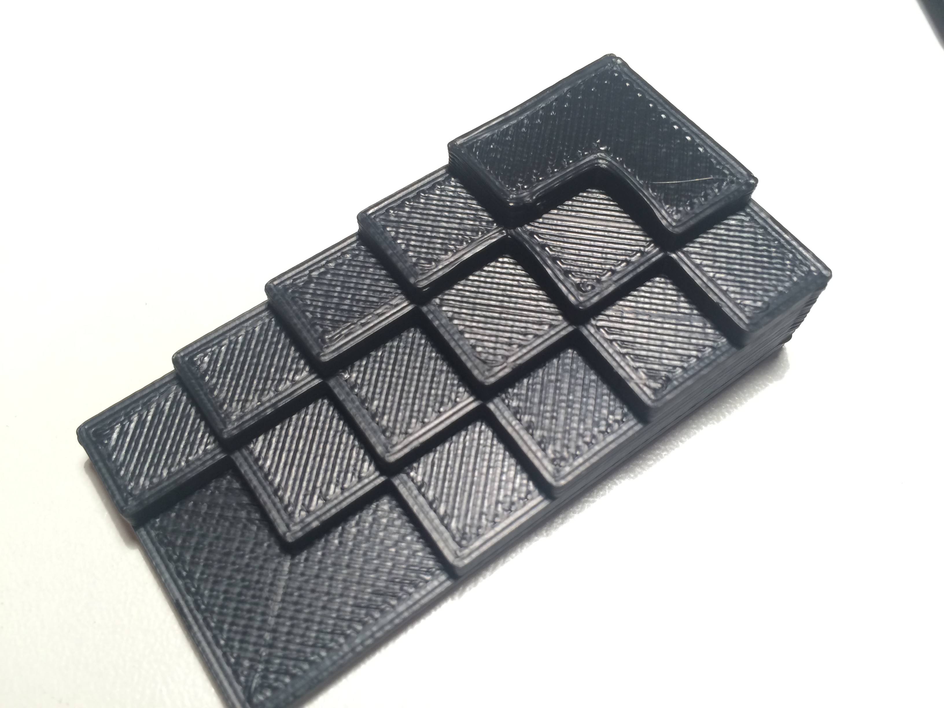

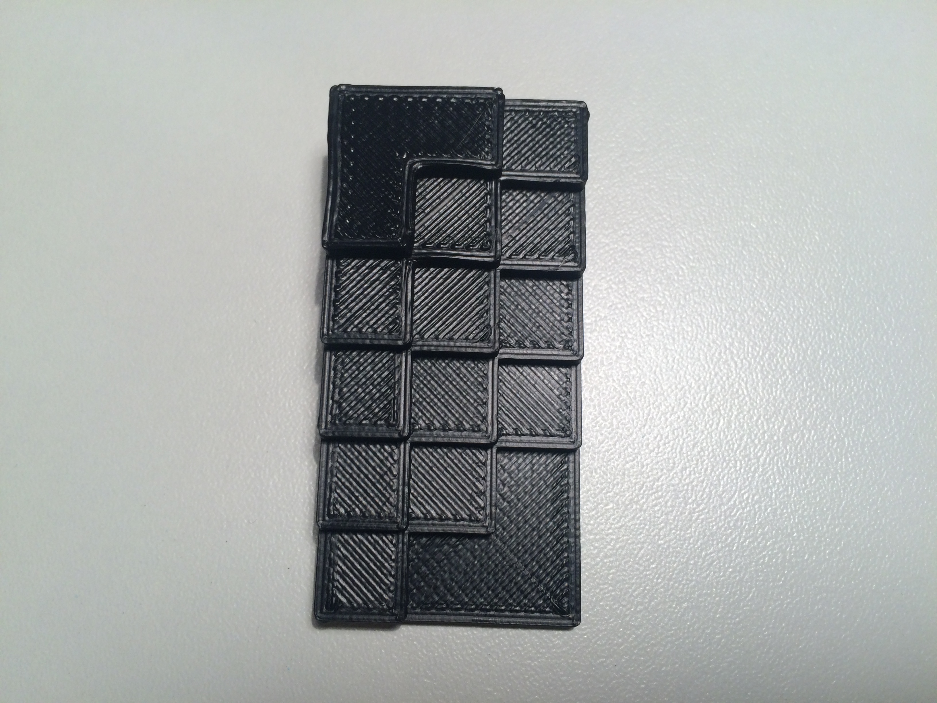

Hi, when you say tiny gaps do mean a visible gap where each line is NOT touching each other?
Do you have a close-up image to demonstrate?
Like so.
This is the final result, would you say not enough extrusion? Also has some melting/warping look about it.

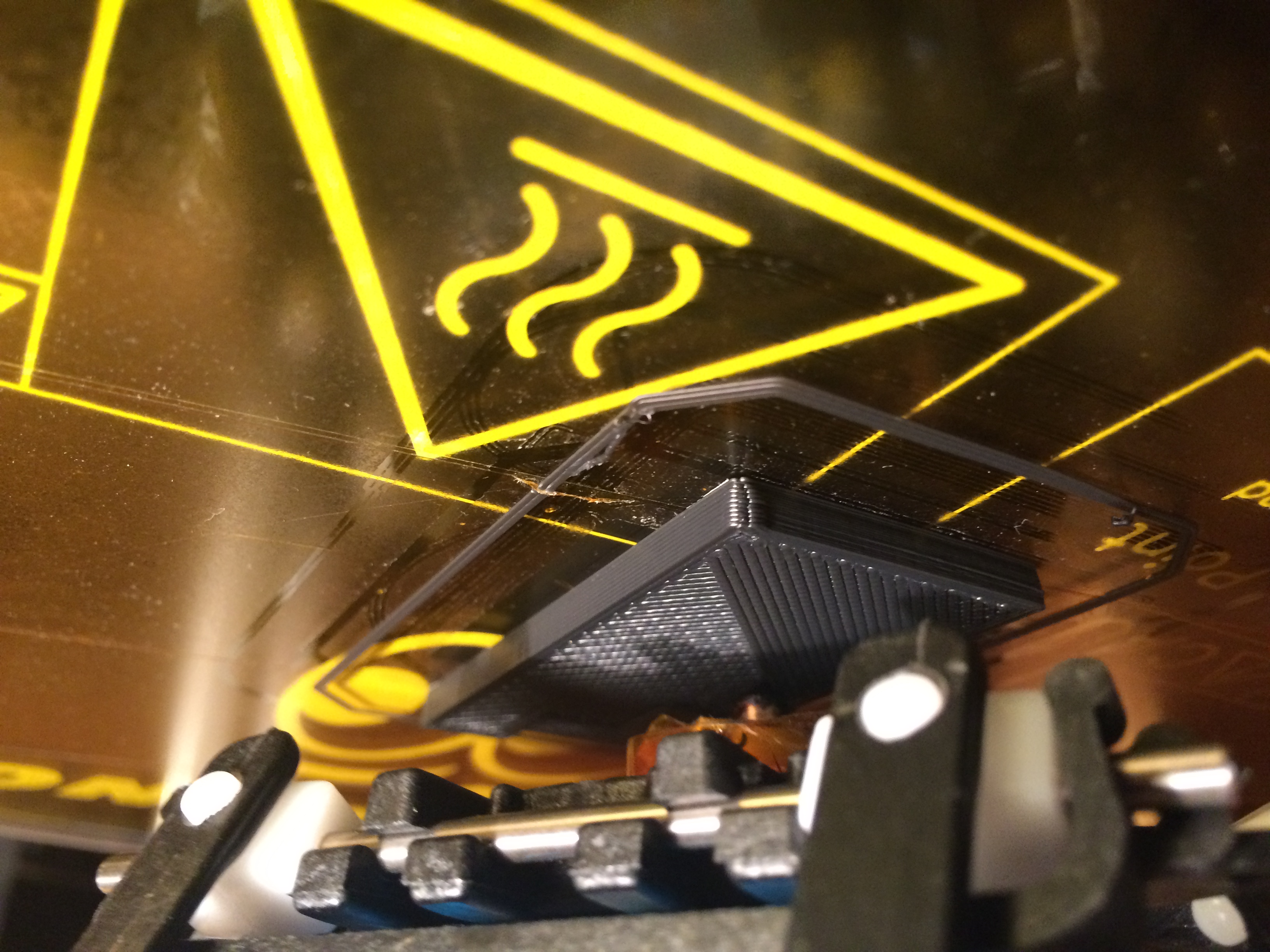

Hi guys i'm new to the 3D printing and am asking for a bit of advice to improve my prints, i have uploaded a few images and would like help on what settings would improve my print, the worst part of the print is the inner columns. My current settings are. Rostock Max V2 ABS Nozzle 0.5 Extrusion ...
