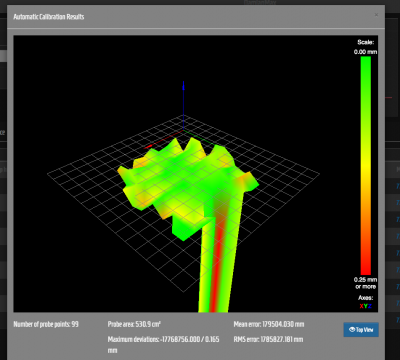

It happens sometimes: http://forum.seemecnc.com/viewtopic.php?f=111&t=11316#p101555 MHackney's theory is that if the probe points are directly across from the FSR mounts, it can make it teeter or something which causes crazy results. If you look at that thread, he describes his new mounting system ...

That's an interesting observation. I have my FSRs mounted half way between each tower and that point does appear to be exactly across from the FSR mounted between my x and y towers (if I'm reading that graph correctly).

I was unable to reproduce the problem. It happened the first three times I ran the grid compensation, but this time it did not. It may have just been as simple as power cycling the printer.

Hi there. I finally got everything up and running, but I have an odd bug with my height map. Any clue what could be causing this huge trough?

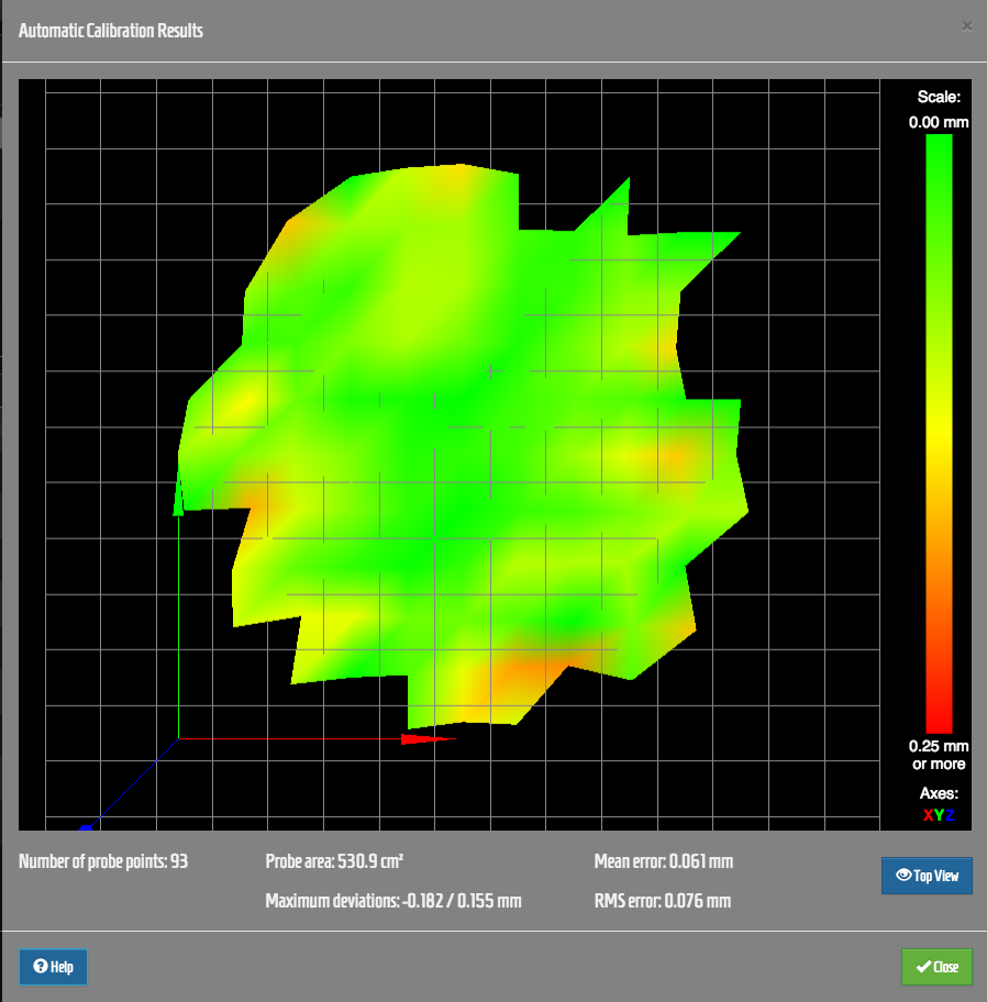

The dialogue that pops up after mine runs says that it flattens it out to about .05, although I've seen it up in the 7's as well. The biggest difference that I've made was measuring the deflection of my hotend at each each probe point with a piece of paper. I can't say that it changed the amount of ...

I'm curious to see what everyone else gets for standard deviation after auto calibration, especially those of you who can print their entire beds. I finally got my auto cal working today. Although it is better than the 0.10-0.12 I was getting with a feeler gauge, it is only 0.08. I was hoping for ...
