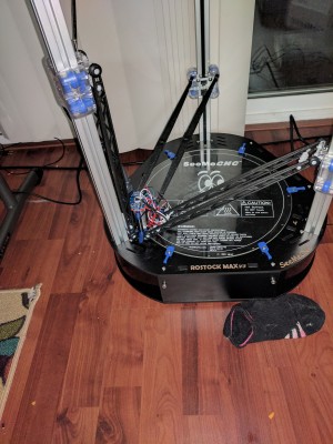

- Tue Feb 28, 2017 7:33 pm
- Forum: Troubleshooting
- Topic: Accelerometer is not working
- Replies: 25
Re: Accelerometer is not working
It was the PS_ON. It came from SeeMeCNC wired wrong.
One time I tried switching it but I was too focused on what I thought was the actual problem that I switched it back before trying the calibration.
With the wire moved to the correct location, it works great.
Thank you both for your help!
- Tue Feb 28, 2017 10:48 am
- Replies: 25
I sent this picture to support and they also confirmed that I need to check the blue wire (PS-ON).
- Tue Feb 28, 2017 9:48 am
- Replies: 25
On the wire whip that came from SeeMeCNC, the PS_On wire looks more blue. I have it connected but after work I will go buy a cheap multimeter and test connectivity from pin 7 to the end of the wire.
- Mon Feb 27, 2017 11:33 pm
- Replies: 25
If you did not use their guide linked to by me or found on their HE280 Parts page close to the bottom then you are just asking for trouble. If I was their tech support I would ask you to take out your modifications and go do what their upgrade doc says to do. I too used their whip but I also used ...

- Mon Feb 27, 2017 10:20 pm
- Replies: 25
After not getting it past the loop of accelerometer initializing, I swapped back the wiring to what I originally had, which makes sense since I'm using SeeMeCNC's wire whip without modifications. I think this is the way I should have it because the accelerometer initializes. I get this: <- start ...
