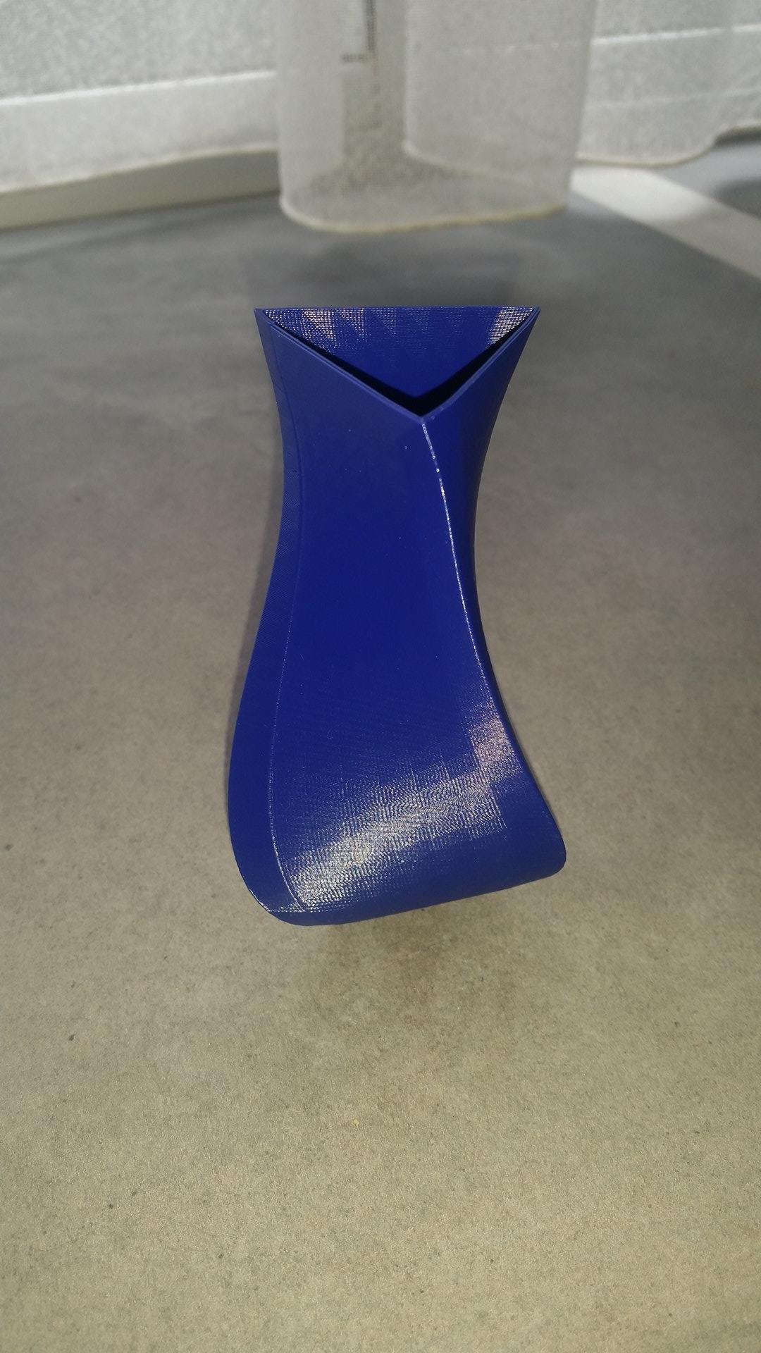

Just a vase, because I could...
Prometheus Hot end, TL CF arms, 0.25mm, 30mm/s, verbatim blue PLA.
Was happy with how it turned out, slowly learning all the in's and out's of the Max V2.

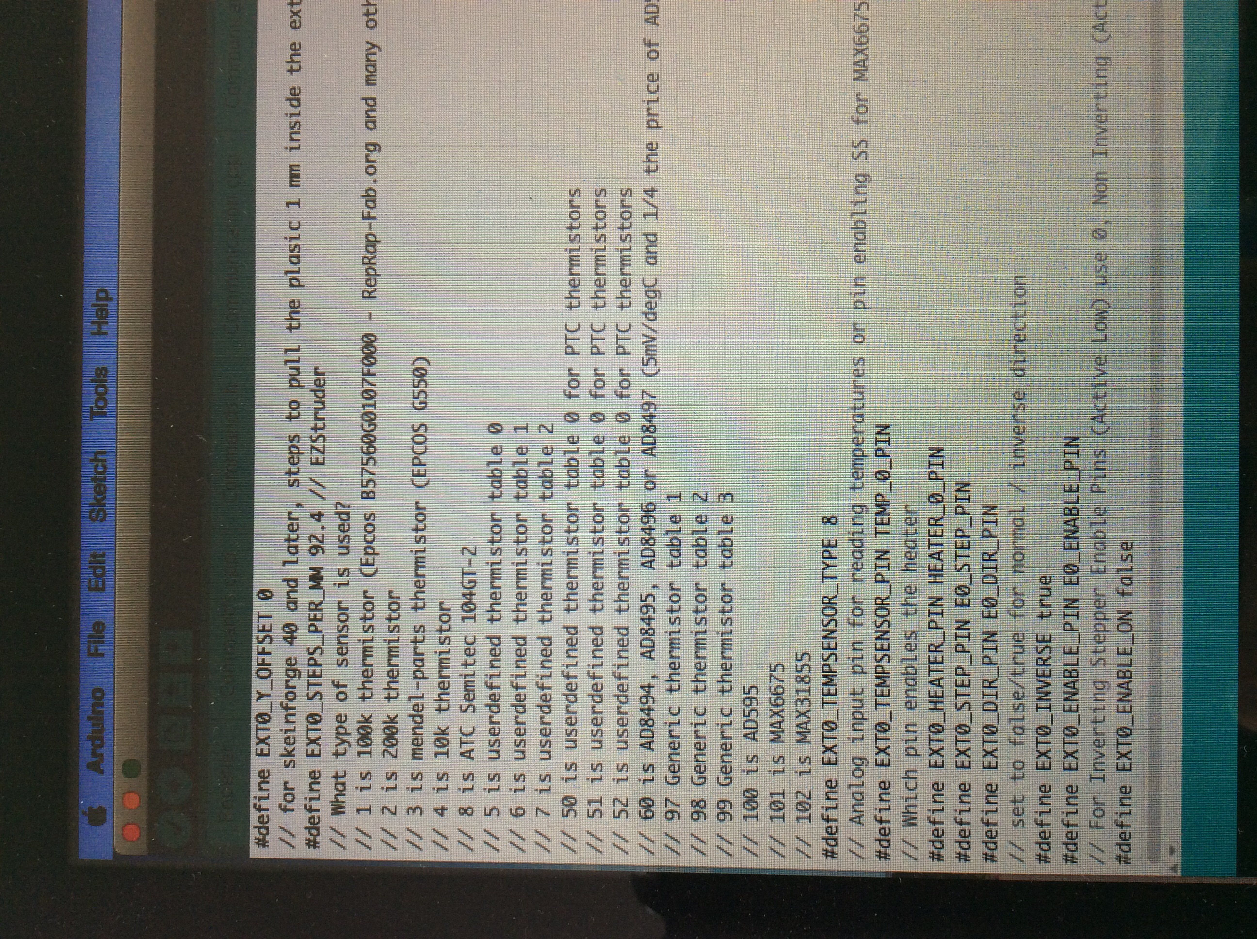

Re: Prometheus and 325mm CF arms
Got it all sorted now... All good just needed some finessing.....
The horizontal radius does change each time you undertake the z calibration. As per the manual its advised to change that value buy 0.5mm up or down until you gain the correct height at the bed centre. I haven't even gotten to this stage yet as per my posts above. But yes I was wondering if this ...
Firmware updated and uploaded successfully...
I'm gathering the horizontal radius EEPROM input may have something to do with it? As that value is very close to my old setup with the old arms... I just made it 126 to see if it would have a difference. As per the manual if I want to lower the nozzle the increase the value, raise nozzle decrease ...
Changed the thermistor type in the firmware and re uploaded. I did the same and just changed the diagonal rod value to 325mm in EEPROM. The issue I'm having now is when I do the z height calibration I have my end stops maxed out to the bottom and the nozzle is still hitting the build plate ...
Hi guys, Just made a few upgrades and I'd love a little clarification. I have installed a V2 Prometheus and the longer 325mm arms. Can anyone give me an idea of how to change the firmware settings for the thermistor and the 325mm arms? I have had a crack at it and I just want to make sure I have ...
