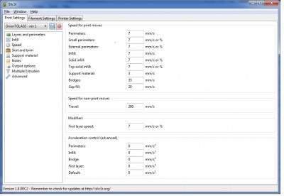

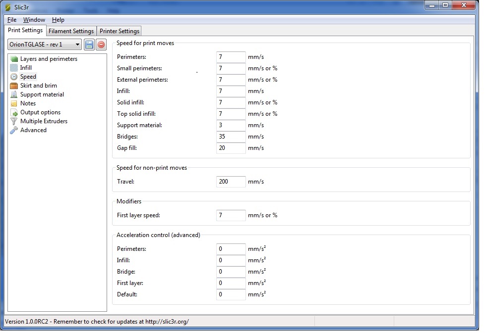

Re: T-Glase Troubles
I understand this, please look at the last 3 posts. I have been printing at 7mm/s and then I have to cut that in half on the LCD.
I am nowhere near 25-35mm/s, I have attached a picture to push the troubleshooting past the speed issue.
The object in the picture is using a layer height of .3mm and the nozzle is the default .5mm. With the EZstruder slipping at 7mm/s until I turn down the print speed on the LCD to about 50-60%, it seems like there is to much back pressure causing the slippage. I'm not sure if this is the case or not ...
