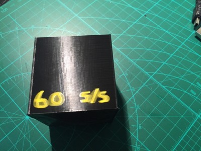

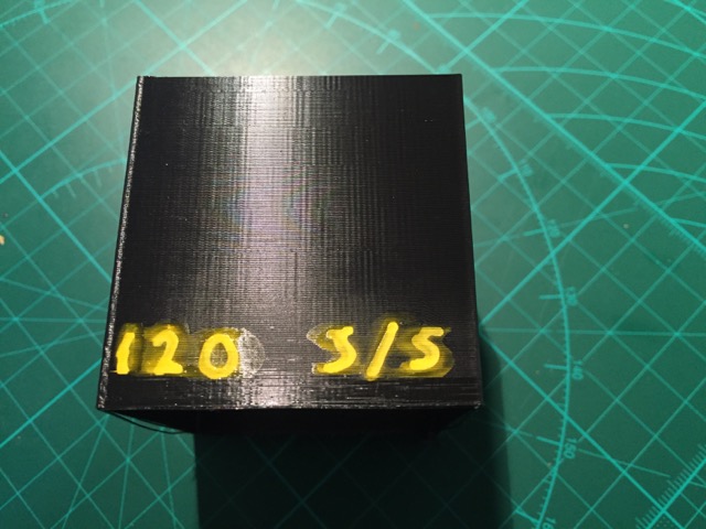

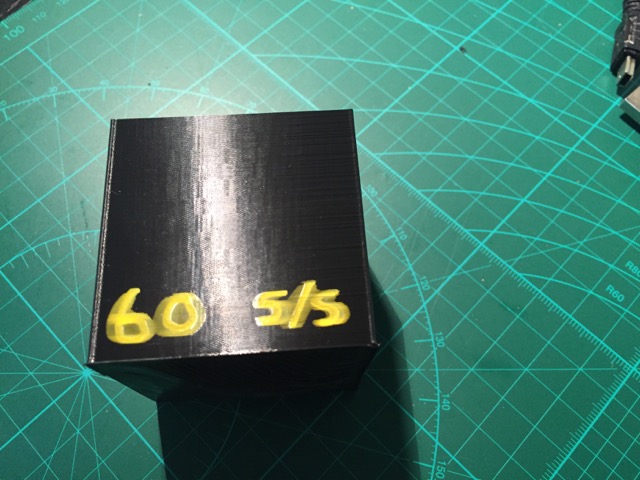

More data from a user on facebook with an MKS SBase (32 bit board, 8825 drivers) Left print is printed at 0.202 layer height, right print is at 0.161. 161vs202_layer_height_8825_Andrew.jpg From this I can see: 1) That he's using 20 tooth pulleys, so his steps/mm value is 80 or 160 2) That his ...
Re: Settings
Also check the infill/perimeters overlap percentage in your slicer -- a well set up printer doesn't need much more than 0.
If the extrusion rate wasn't right, then you'd get gobby lines all through the print, not just at the ends.

Based on Bruce's last few prints, it looks like the Golden Ratio idea works pretty well. I see only straight lines, with little to no evidence of a Moire pattern. How did you come up with that idea? How does anyone come up with their ideas? In the shower, of course :D It all started with me looking ...

Bruceg, Interesting prints. Thanks for doing this. Would you say that the golden ratio print is smoother? btw what steps/mm are you running at the moment? From some of your earlier prints it looks a bit like you're running a steps/mm value of 100 (or 200). Is this correct? It's just that the lines ...

Thanks for doing this test,0110. That's a really good data point.
The next test would be to lower your segments per second value, and see if this changes the pattern.

The Golden Ratio idea is really cool! To reduce these artifacts, I recommend upgrading to 400-step motors (0.9 degrees/step) and upgrading to a 32-bit controller with better drivers. Smoothieboard and Duet both offer that. I've used both, and while they have different step generation algorithms, I ...

Another thing to try is to lower the segments/second rate in your firmware. Halve it and you might see an effect like this:

I've been doing a LOT of experimentation on this issue. I'm convinced that the vertical lines you see here are not segments, but rather, stepping artefacts from the A4988 driver. 0110-m-p, can you try slicing the attached file in spiral vase mode, no need for top or bottom shells, with a layer ...

Hey Bruceg, I've been investigating this a lot on the other thread, and might have found a way to isolate the stepper noise from the segments. Try printing at 101% of the layer height you are already printing at. So if you print at 0.1mm, try printing with layer height of 0.101. If printing at 0.2 ...
